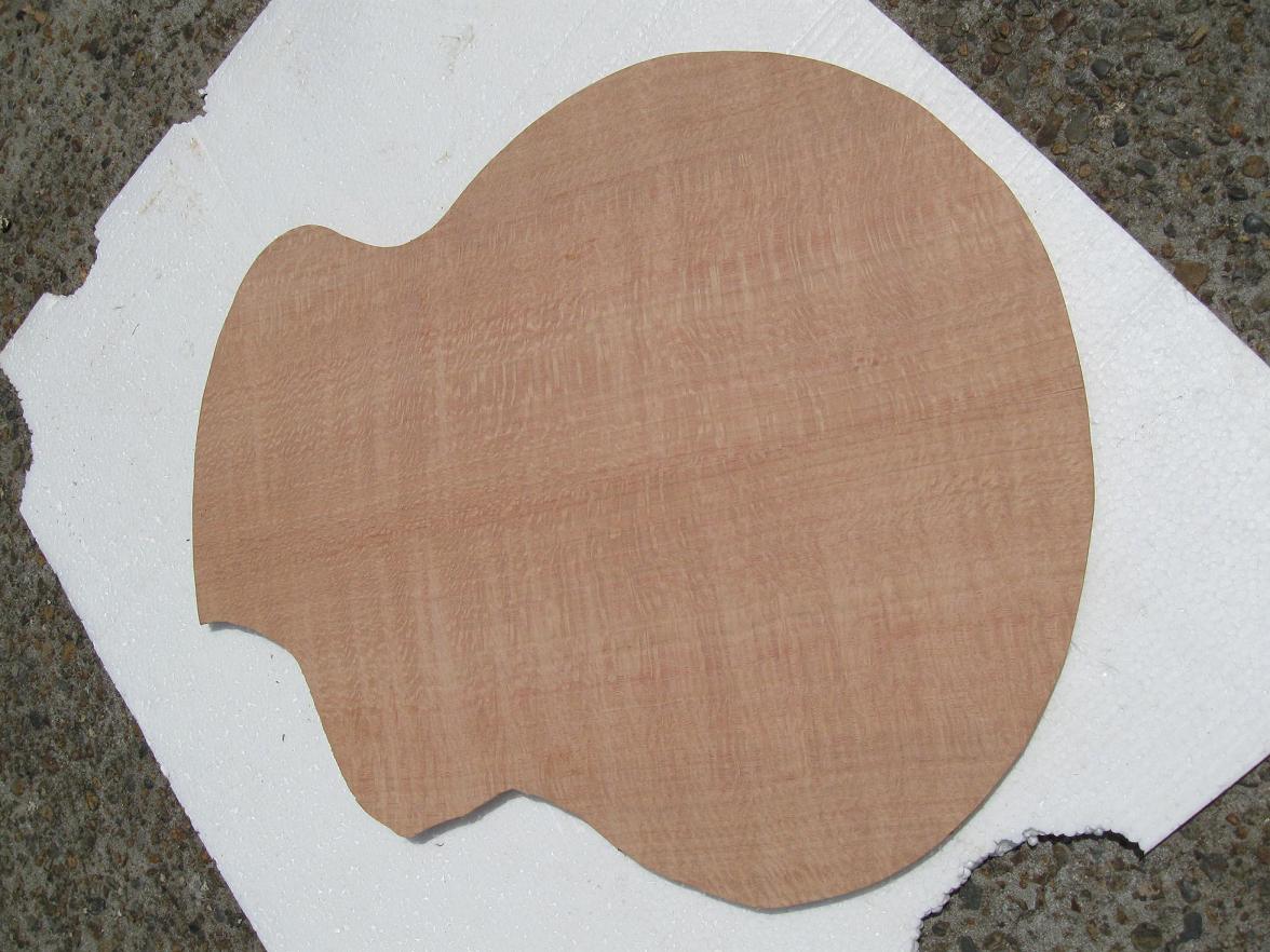

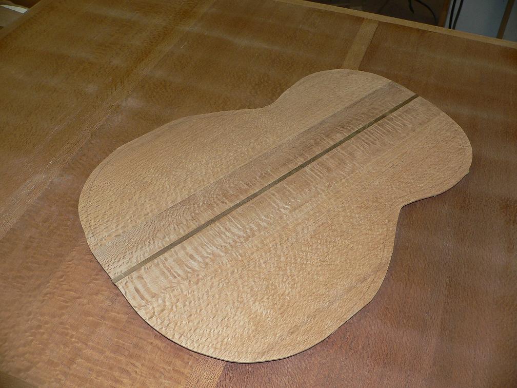

Silky Oak, (either Grevillia or the northern Cardwellia) generally gets its spectacular figure from the medullary rays, which only show on the quarter.
If your timber looks like this:
or the centre panel here:
it is likely your back is q/s. Flatsawn is more like the edge of the lower bout...... very little figure.
Post a pic for confirmation, as these are Cardwellia, not Grevillia.
So I would go with 3 and 4 above.
Also would suggest that discarding is not necessary.
If the figure is good, (and hence near or on the quarter), you can carve off the braces, allow to flatten out, equilibrate your mc at a suitable RH, ad then rebrace.

Alistair, All my Grevillea robusta is showing rays only if Flatsawn. When cut on the quarter it shows only little dots. So I'm confused by your post??!!

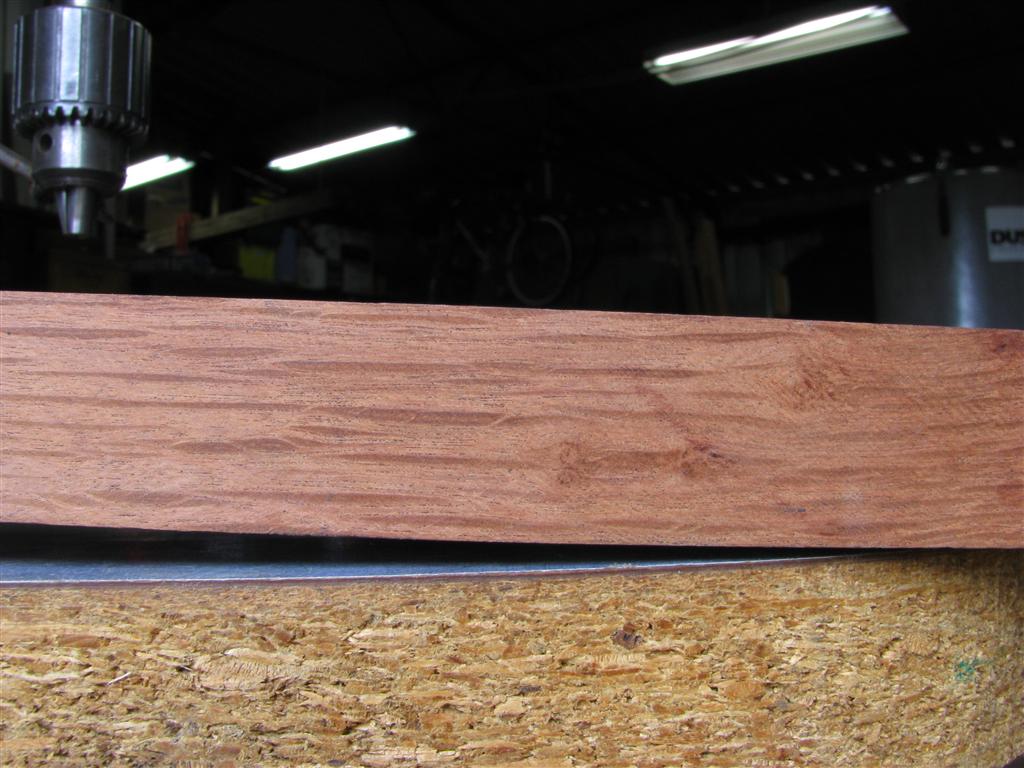

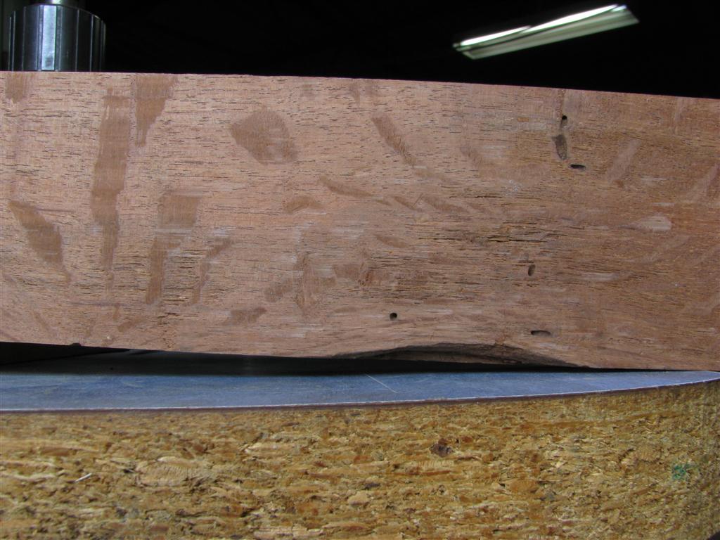

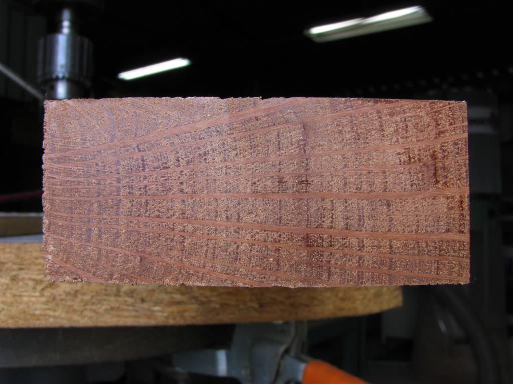

I am not saying this is the case in this instance, but for the uninitiated, woods like oak which display prominent medullary rays can be deceiving when looking at the end grain to determine whether or not it is flatsawn or on the quarter. This is because the medullarys can 'look' like grain, but they actually run 'opposite' to the grain. Therefore if the billet has been resawn with the blade cutting in the same direction as the medullary rays, it will produce quarter sawn wood with the rays being more broadly exposed upon the surface to produce the figure which Alistair has shown in his image.
I know that most would be aware of this but the hope is that the following will help anyone who is not so experienced with wood working to understand what I am suggesting above.
Here we have an image showing the endgrain of some well quartered WA Sheoak. The prominent 'light coloured' markings running left to right, or horizontally across the end of the board in this image are the medullary rays. Medullary rays radiate out from the 'centre' of a round log to its outer edge. If you look more carefully at this image, you will also see much finer markings running in a vertical direction, these markings are the actual grain of the wood.
If we now look at the 'face' of the same board, that is the widest surface, we see large 'darker' blotches. These darker markings are the surfaces of the medullary rays which have been exposed by the saw blade cutting 'across' them, in their same direction, to reveal more of them in the surface of the board to indicate it is 'quarter sawn'.
The same board turned 90 degrees to view the 'flat sawn' side shows none of the large darker blotches. This is because the saw blade had sliced straight 'through' the medullary rays, so whilst they are still darker than the surrounding wood, the rays now appear much narrower and more uniform as they run the length of the board.

Apologies, Alistair...My bad... It is quartersawn. Looking at Kim's She Oak I have taken the rays to be the growth rings when looking at the end grain.
The photo doesn't show it very well but with the right finish I think it'll look amazing. Thanks again.
