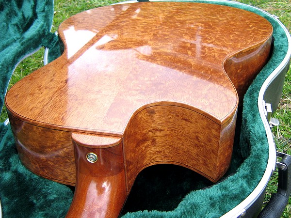

I picked up the art of French polishing 40 years ago whilst serving my piano tech apprenticeship. We had an old English guy in our workshop refinishing our pianos . He had learnt his trade in London during the great depression . All he ever used was hardware bought methylated spirits ( meths ). He never even worried about puting the top back on the bottle of meths when not in use .
I've been using meths ever since with no problems . Although I do like to use a freshly opened bottle when mixing up a new batch of polish , there is probably no need .
If you can manage to get yourself some 100 % stuff it will soon revert to 95 % in any case , so it's really a waste of time ( and probably money too ! ).
I've used the Diggers stuff from Bunnings ( which states 95 % ethanol on the bottle ) many times with no problems. Alan's milky finish problem may have come from applying coats during high humidity trapping in moisture between coats . You have to have near perfect conditions to french polish which includes enough heat , suitable humidity, no dust, good light etc.
I've been using a blonde shellac of late but the garnet/orange variety has a certain look too.I really quite like the look, particularly on a classical. I've found the flakes to last indefinatley if stored in a cool dark place . I make up the polish in the dark also !
The proof being in the pudding :

Craig: Well you blew all my theories out the window. Magnificant french polish there mate! I reckon you could be right with the milky residue coming out due to too much humidity in the air while doing the FP process. I remember dropping a big sweat blob on the back during the process and that took some fixing.
