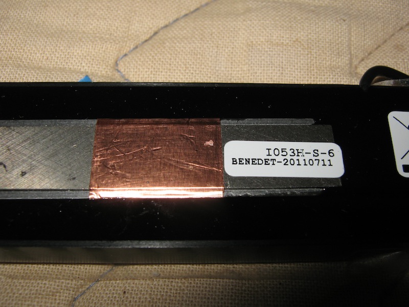

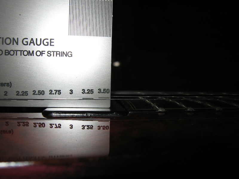

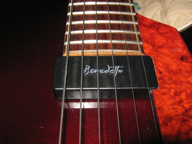

Here's a pic of the pup in situ, one of the gap between the pup and string,3mm, and one of the underside of an identical pup.

Post by ozziebluesman » Mon Feb 13, 2012 6:34 pm
G'day Rod,
Hmmmm, must be a faulty pickup. I have the same model installed in my archie which about 3 mm from the top of the pickup to the bottom of the first and sixth string. The pickup sounds great with good single string volume balance. In my experience it is not very often that you will find faulty guitars strings however I have seen a batch once where some of the strings where crimped during the final packaging phase.

Rod, that looks close enough but it wouldn't hurt to try. If that doesn't work you could be pretty sure you have a dud pickup.
I had the impression you were taking about a pickup with metal flat bar sticking up which is why I suggested shaping it. These are just like the sealed active pickups I use and they shouldn't need any string to string adjustment, they would have built compensation. I've never had a dud pick up, if anything is wrong for me it is always traced to a dry solder or something in the wiring.
Its just seems very unusual that a pick up would stop working on strings 6,5,4&1. Very strange indeed.
