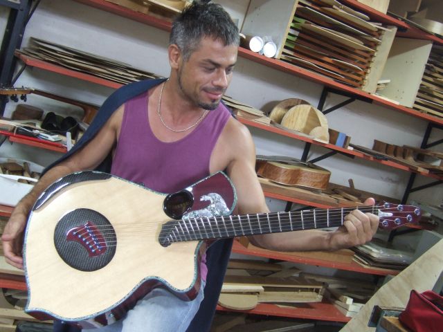

How about a smaller one of these....
Stuart Newman.jpg (70.23 KiB) Viewed 16590 times
Only kidding, but when someone says "purple guitar" this is what comes to mind! (Purpleheart back and sides, but hard to see all that :wink:)
Re: A "little purple rock guitar"!
Post by Allen » Mon Feb 13, 2012 7:09 pm
Stuart is always a bit out there isn't he. 8)
