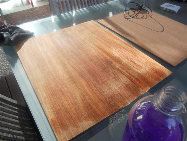

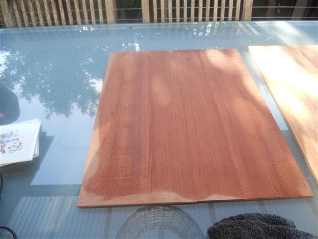

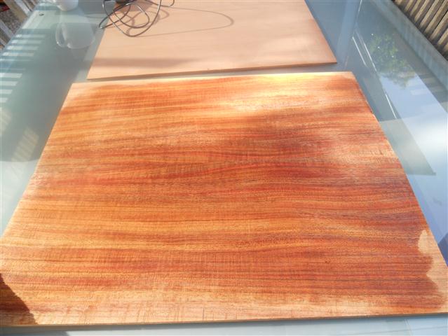

Anyway, I glued up the back and top, and today received the plans for a dreadnaught. Back and sides are blackwood, lightly figured, but quite cheap, along with a rather highly figured neck blank, and the top is cedar(reclaimed). I've never had a cedar top guitar, and am sure that MANY questions will follow in the course of this build....
Here are the blanks, rough sanded and doused with metho...Opinions?

Looks like nice Blackwood and Cedar. You said the cedar was reclaimed...where did it get reclaimed (recycled) from? Well done on your first build. If you have already bought a dehumidifier and a hygrometer you have got a serious case of Lutherie addiction. There is no known cure but you will enjoy it

Yep as John said, No Known Cure, Your Gone Mate
I thought in the first photo's that it was Western red cedar but with the metho it is obviously Aust Red, Yes ? Could be my monitor
But looking good mate
now the fun begins

That Blackwood looks pretty nice.

Sweet bookmatch and nice rich contrast in that blackwood Nick. I have some beautiful blackwood that is quite similar which was sent to me by our great mate Bob Connor and I am sure it will make a wonderful guitar. Vintage resto is rewarding stuff, but having a blank canvas offers something just as special. I personally see them as two completely different facets of the craft, but both are equally rewarding as they allow you to express your skill in the craft in completely different ways.
Looking forward to seeing what you do with this combo.
