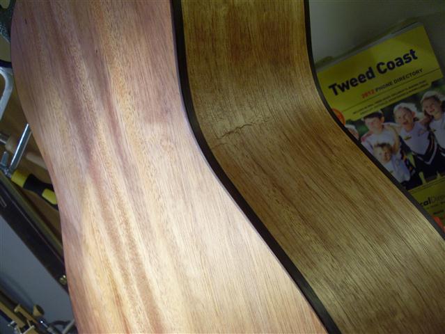

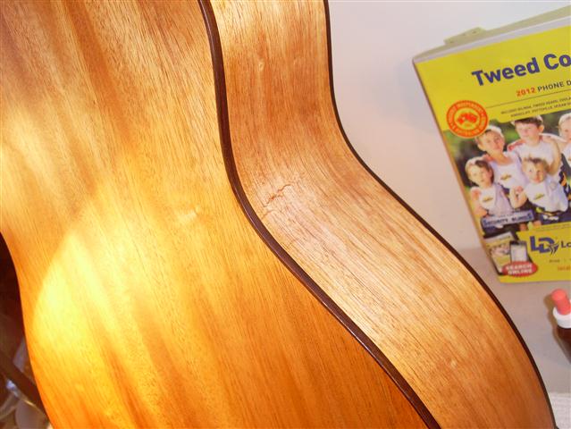

The main reason I ask is that in Kinkade's book, he recommends soaking rosewood before bending. Now, not having the faintest idea what I was doing, I soaked the Qld Maple before bending....
It was very hard to make it maintain it's shape when I got the curves I wanted, and I ended up with a little "wrinkle" in one of the waists. I strongly suspect all of this was due to it being too wet...
Here's a couple pics, one with, one without flash.... I have no idea what the consequences of this will be...
I'm really only looking for a guitar that plays OK for my first one, and to learn as much as possible about the entire process....
Re: Blackwood Stain.
I've never used any softening agents. I know some guys who have a hell of a lot more experience than me use them on stubborn woods, and others with just a much experience won't touch them with a barge pole. As long as I'm not having difficulties, using them is not on the cards.
The "Old School" ways of soaking many woods I think stems from having to bend them on a hot pipe. Today with the silicone heat blanket and solid forms you can get away with a lot less water. There are quite a few of the uke guys using 2 blankets. One on each side because so many of the bends are every bit as tight as a venetian cutaway.

Allen wrote:If you read through Benedetto's book on arch top guitars he tells you to take them down to around the 1.8mm if memory serves me. Doesn't reinforce them after either as the area in the bend is stronger than that on the flats.
You're right. I mainly just look at the drawings after a skim thru the text.

I suspect that wrinkle is because the wood was not pliable enough when you bent it.nnickusa wrote:The main reason I ask is that in Kinkade's book, he recommends soaking rosewood before bending. Now, not having the faintest idea what I was doing, I soaked the Qld Maple before bending....
ie
1. it wasn't hot enough or
2. the bend was done too quickly
or
3. the side was too thick.
