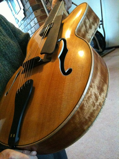

G'day Rod,
I've been working on my second Archtop from the Benedetto book and plans and I'm using Queensland Kauri for back and sides. The back set I have are not book matched but the pieces I have are straight grained, match well in colour so I figured it would be fine to use. The sides where very easy to bend even around the cutaway area. I have a Queensland Maple archtop backset in the stash and it is one piece with wings. The Queensland Maple and the Queensland Kauri backs I have are very similar in weight so I thought why not use the Kauri as back and sides. The tap tone on both backs are very different so it is going to be an interesting project. The Kauri is a beautiful golden brown colour and I have a Stew Mac AA spruce wedge set to go with this Kauri.
Looks forward to seeing your progress pictures.
Re: Kauri top
Try this then John.The NZ Kauri has a beautiful golden luster that I have not seen in Aussie Kauri
Queensland Kauri (& qld maple)

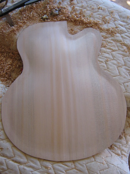

Cheers,,,
- Posts: 1169
Re: Kauri top
Yep, I reckon you'd be getting excited about that already!
It's going to be nice Rod.

Wow Craig !!
that guitar Looks beautiful, love that warm honey glow looks pretty similar to NZ kauri.
your top looks great Rod !!!
you should use your Ancient Kauri for the back and sides would make a great combo !!
