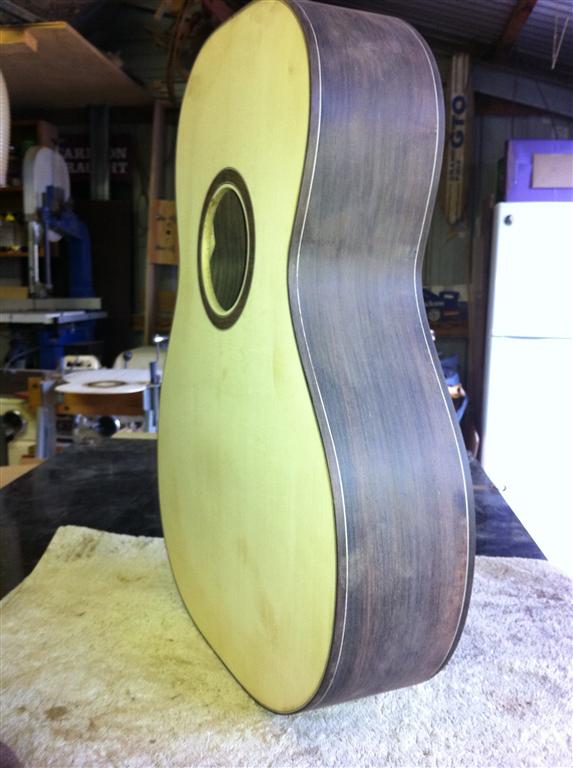

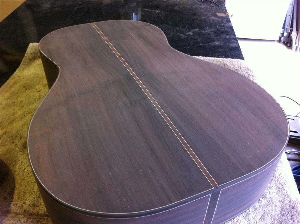

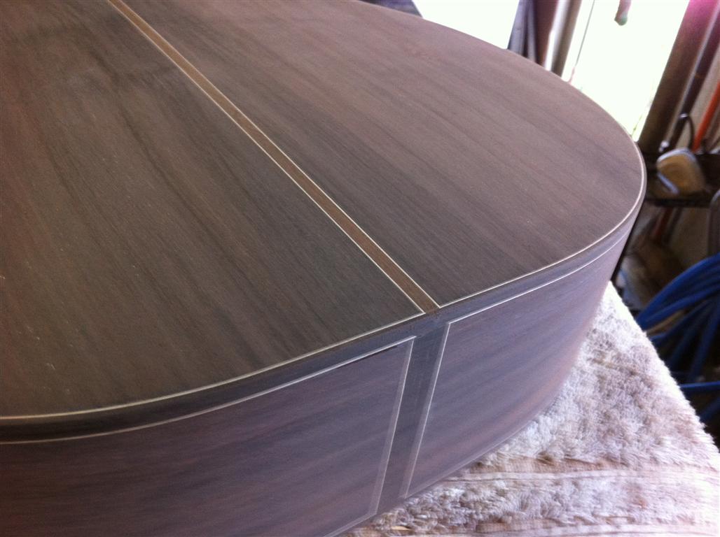

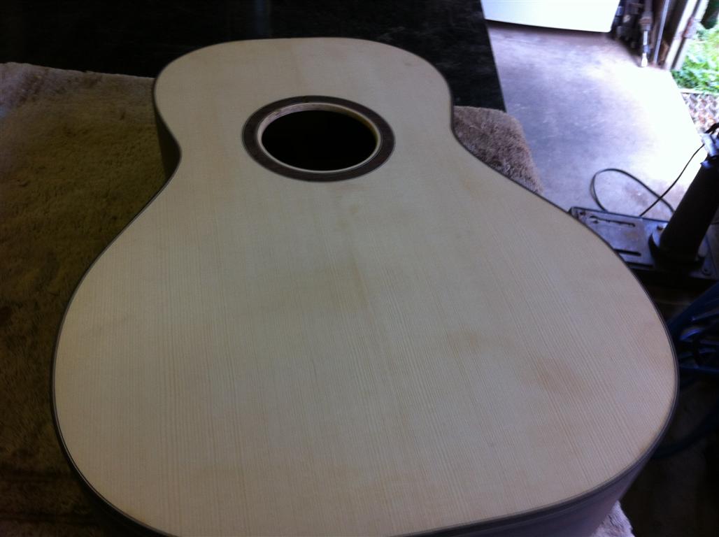

Alan Hamley asked for a few pics on how this one is going so here it is.
Brazilian Rosewood Back, sides, binding, rosette, bridge and fingerboard (when the neck gets done) Those purflings are Maple
Euro Spruce top and the neck'll be Spanish Cedar wirh a slotted headstock.

Thanks Bob, I've been waiting to see this guitar take shape. The BRW looks so classy. Beautiful work as per usual mate. The lower bout looks like it's a bit wider than a typical parlour. So how long have you been sitting on this set of BRW and is this guitar for yourself?
Thank you again for the progress pictures.

Alan - I think it's just the camera angles that are making it look a bit barge-arsed.
The body shape is a Martin O-16 which I got from John Hall a few years back. It's a 12 fret to the body job.
I've had that set of Brazilian for a number of years and it's the only set that I have so I decide to pull the trigger and build with it. I'ts nicely quartered and has a reasonable tap tone. The workshop has smelt pretty good for the last few days.
I guess I'll keep it but then I suppose everythings for sale at the right price.

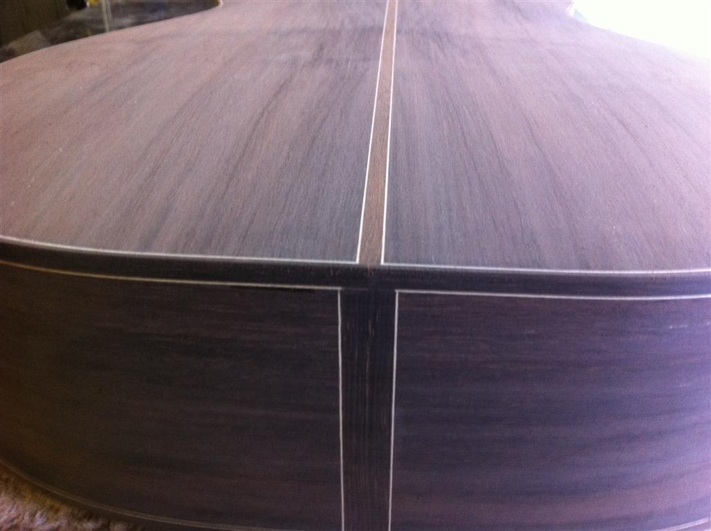

Bob,
That is looking fantastic. My current build will have a similar look as far as the purfling goes, I have Australian Red cedar B & S , Lutz top with Rosewood Bindings and a silky Oak purf, I have been worried that the rosewood and Au Cedar may bleed into my Silky oak and lutz, I would be interested in knowing what precautions you take to prevent this ?
Cheers Tod

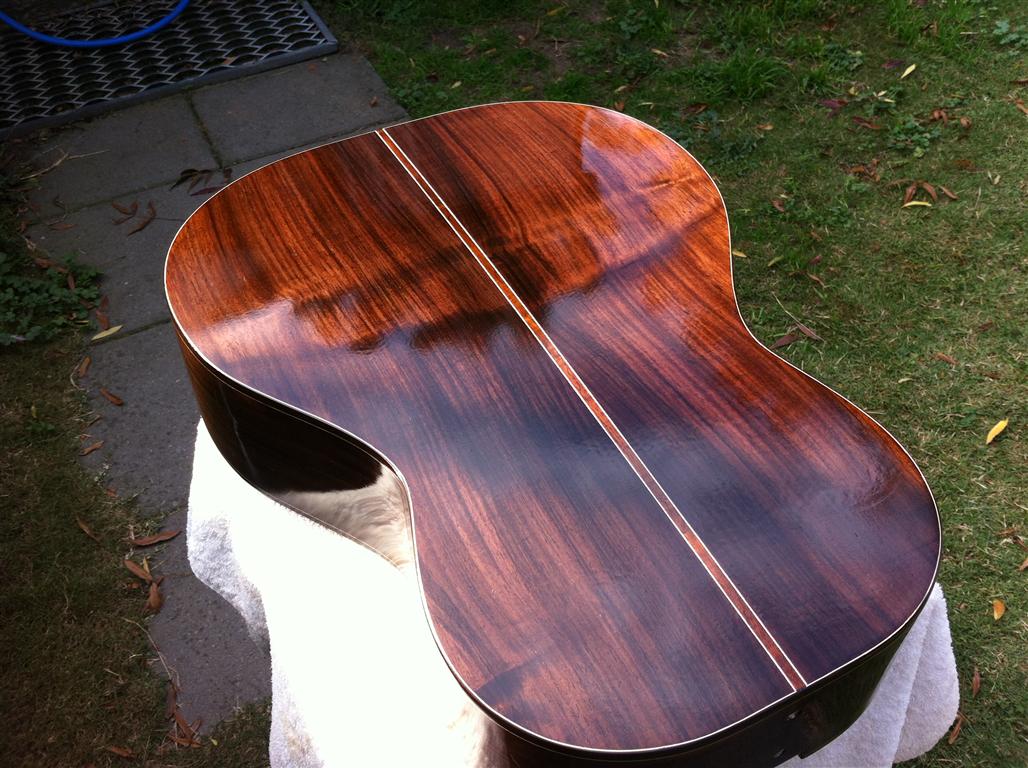

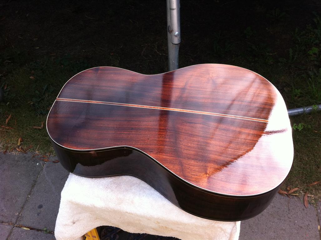

Jam time. Started puting some finish on it today so it's looking good after 5 coats.

Mate ,,, You can't sell this one . Truly superb Bob

I'm still using Z-poxy Craig.
Re: Braz O-16 New Yorker
Through my monitor the 'dry' pics almost looked like IRW
and I'm thinking "whats all the fuss about with this stuff?" but now the finish is going on & it's starting to pop I'm thinking "Now that's what I'm talkin' 'bout!"

The last few weeks while I've been sanding it the whole workshop has had a beautiful, sweet smell to it. Nothing like EIR (which I reckon smells like dog turds)
My mate Mark (who I rent the workshop from) loves the smell of it and has been getting a regular whiff of it due to the fact that his beer fridge lives in the shed.
He was most disappointed yesterday because I'd started sanding some Huon Pine. Nothing wrong with the smell of Huon mind you, but I do love the smell of a Brazilian in the morning.
This stuff is fairly plain as far as Braz goes Nick. It's cut dead on the quarter unlike most of what you see for sale now which is usually flatsawn stumpwood.

That's such a nice looking guitar Bob
The Brazilian really pops with the Z-poxy I think I will give it ago on my next build.
