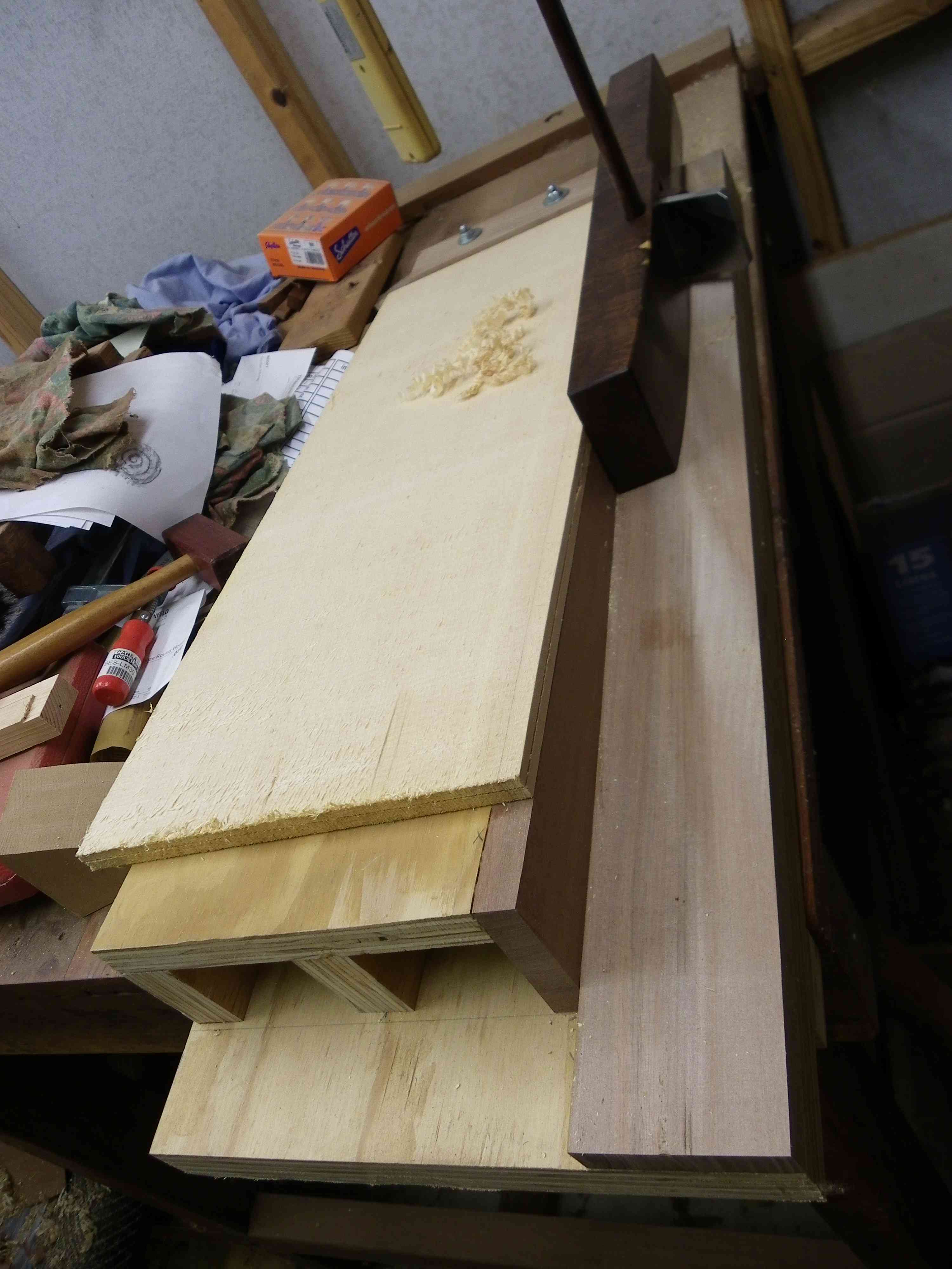

Hi,
I've just finished making a shooting board that is 2 months too late for Steve, but maybe still of interest. I only had plywood and a few brush box floorboards handy, so that's what I used. The photo shows the shooting board in use on a pair of Shane Neifers "Low Grade Lutz" top halves (21cm x 56cm).
Thanks,
GregL.

Hi Tod,
Thanks for that. I don't see the "upload picture" button indicated in that tute, I think it's because I haven't posted enough here.
Martin (kiwigeo) has offered to post the photo for me.
Thanks,
Greg.

Hi Greg,
Here I have added an updated screen shot which should explain how to upload a picture with the current forum software version.

Thanks Markus. Now I know how to upload pictures!
Thanks Steve. I saved up my pennies and finally got that HNT Gordon Trying plane (in beautiful ringed gidgee) - it works well on the shooting board.
GregL.
