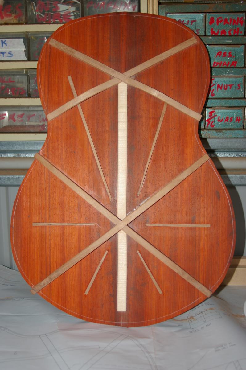

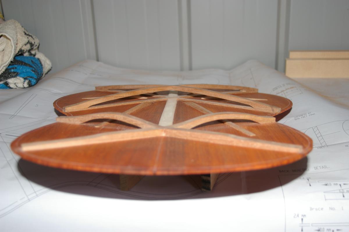

Hi Graham, i'm currently building a Kasha style guitar. It's my first Kasha a bit of work involved. Hope the photos help. Wayne

Looks much more involved than other methods. Does this pattern add more weight to the top and back?

I'm not sure of the benefits of this bracing system, it's an ordered guitar and the guy is pretty keen on having a Kasha. The top is actually very light considering all the braces on it, it's made from Italian alpine spruce. The back has a bit more weight in it, it's made from Padauk with q/land maple braces. Wayne

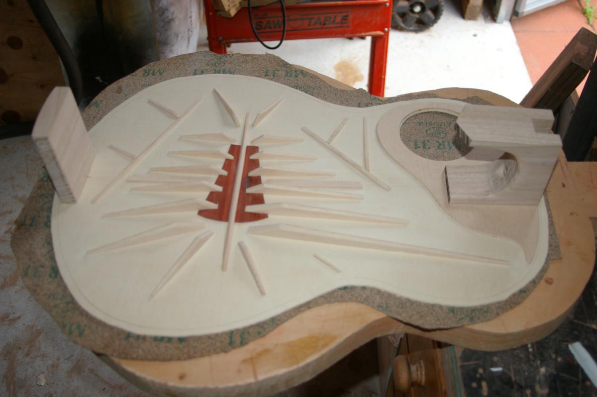

I've not built a Baritone in the style, however I have built a Tenor Ukulele in Kasha.

The principle of the design style is respectable - to increase the 'active' area of the soundboard and distribute the load over a wide area, evenly. There are many ways of achieving this, indeed you could even see 'Falcate" bracing of Trevor Gore's as a variation of this, at least in principle and superficially - though far more involved and considered as a whole and complete design.
I would not be preaching it as a "superior" bracing scheme to the more common bracing methods found on ukuleles, but I would not write it off either. Some great sounding ukes I have heard have had very rudimentary bracing indeed, however they often suffer from short life spans as a result. I can't comment as an authority on the subject though, only having made one in the Kasha style, but I currently have another in the making.
To me, it has more to do with bringing the most out of the specific piece of timber you have in hand, by whichever method of bracing you choose and meeting your targeted objectives in tone, projection etc. All bracing methods require a fine balance between achieving sufficient support, whilst creating a responsive instrument. I think most bracing styles when done well can attain excellent results.
