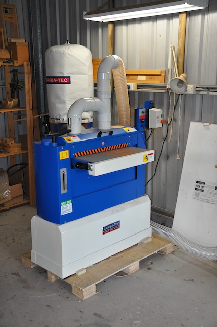

I've had plans on upgrading my drum sander for over a year now. I've become so busy that it has got to the point where the little 10/20 Jet takes far too long to accomplish what the new one will do in just a fraction of the time. And then I got a weekly specials email from Carbatec putting this sander on sale, with the savings being almost spot on what the freight to Cairns was going to be. Teamed it up with a 2hp dusty and jobs done....well almost done. The mobile base I ordered was put on backorder so I had to crab walk this thing by myself to the back corner of the shed. No mean feat I can tell you because this thing is bloody heavy.

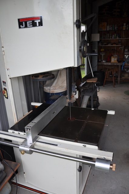

As well, when I was down at Micheal's we knocked up a precision fence for my bandsaw, as the factory one is just a complete piece of crap. Made from stainless, alloy and bronze with quick adjustment by sliding and then locking the fence in place, and fine adjustment with the knob on the end. It's just a joy to use.

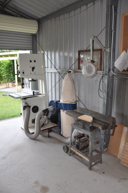

And finally, Micheal has a collection of old cast iron, with doubles or triples of things. He passed this little Kiwi built 6" jointer on to me. It's a little beauty and works like a charm.
And while I was at it, the shed is getting a good clean out. Man the dust and debris has a way of piling up in the corners.

That bandsaw fence certainly looks the dogs bollocks Allen

Your comments on that drum sander would great, my 300mm belt sander might destroy a top if dare to use it for that, let us know if the Carba-Tech is a good sander.
By the way that fence is a credit to you guys, so much of the equipment we buy today is made in China and the attention to accuracey is a lot to deal with sometimes

Nice sander, lucky bugger. My home-made one scares the crap outa me.
I hear you on the Jet fence, the Jet bandsaws are great in every other respect, why they put such a crappy fence on them I'll never know. Don't suppose you've got any drawings for the one you made that you could post? I've got a lathe, and that looks like a very worthwhile project.

Micheal has had this sander for well over a year now and we've used his to process over 50 uke sets for class's we instruct. As well he's used it for surf boards, work benches and God knows what else. I also pushed 3 sets of Milo through this one yesterday just to see how it goes. Comes out far better than the Jet and so bloody quick you'd wonder why you waited so long to upgrade.EricDownunder wrote:Your comments on that drum sander would great, my 300mm belt sander might destroy a top if dare to use it for that, let us know if the Carba-Tech is a good sander.

Twin drums with the back drum finer than the front and micro adjust so you can take as little or as much with that drum as you like. I think that a combination of 60 grit and 100 grit would be the go for most everything luthier related.
I've used the Jet 16/32 and the 22/44 plus their fancy oscillating one. They all pale in comparison to this baby.
This fence isn't really our invention, as he's got some old cast iron in the shed most likely 70 years old with the same style of fence. We knocked this one up by utilising parts of my fence assembly and a bit of a mud map of my machine down at his place. Came out pretty damn good for not being able to trial fit anything on the saw.
You would need a mill and a lathe to build this one. Almost as much milling work as lathe.
I'm going to draw up the plans for Micheal, as I'm practicing my CAD skills. He's got a bloody big Bridgeport style mill and 2 metal lathes. Really getting into his metal work as a diversion from all that wood he has stashed away for a rainy day. He may decide to make a few. I know of a couple Jets that need a fence upgrade in the worst way.
It's also a design that could be quite easily adapted to other machines. Stay tuned for further developments.

Lucky I couldn't head down with you. I would have had to nurse a jointer on my lap for 2000km.
Probably around Tugan the door would've accidently flung open and the jointer would've been a speed hump for all the boy-racer cars that frequent the goldcoast highway.

Nice fence on the band saw Allen.
I bought the same sander as your one from Carbatec a while back, it's a beauty and has come in handy on some paying jobs, I would not be without one now.
I have not changed the belts on mine yet, I haven't needed to yet and also cant find the 2 new belts that came with the machine.
When I find them I was going to try and use them as a template to cut out other replacements as well.
Do you know yet if the clip in these machines is the same type that can be a pain for belt changes that others have talked about with other machines before ?

Not tried changing the belts, but I asked Micheal about it and he said it's pretty easy to do. I never had any trouble with the belts on the Jet one.
Mine didn't come with any extra belts. I've got to get on with getting replacement stock. Cause when you need them, you need them. I hate to have to put everything off until they arrive.

I recently bought a Jet JWBS-14Q, which actually has a decent fence on it - looks quite similar to the fence in Allen's photo at the top. The bandsaw is actually manufactured in Switzerland by Walter Meier AG. http://www.jet-tools.com.au/Media/JWBS-14Q.pdfPaul B wrote:I hear you on the Jet fence, the Jet bandsaws are great in every other respect, why they put such a crappy fence on them I'll never know.
Re: A bit of new kit for the shed
That is the exact fence that was on my saw and every other Jet I've seen Nick. And it's a total piece of crap! You just haven't used yours long enough to realise that yet.
We've replaced the locking and adjusting mechanism with the precision one and just used parts of the original to make it easy to still fit the saw.
If you pop your fence off and have a look at the locking mechanism on yours you will notice a cam type lock with what looks like a plastic or teflon pad. It's that set up that will leave you totally pissed off when you've set up to do a cut and it ends up slipping on you. Happened to me far too many times to put up with that. As well, as time goes by the glue that is used to hold that teflon type pad in place fails and the pad slips making getting the proper tension impossible without repositioning it. If you let it go too long it falls out, leaving you to search around in the dust bin 'cause you swept it up.

Been there, done that, agree entirely.Allen wrote:That is the exact fence that was on my saw and every other Jet I've seen Nick. And it's a total piece of crap! You just haven't used yours long enough to realise that yet.
I cut up a cork sanding block and used a piece of that as a replacement for the teflon pad. It works better, only 'cause double-sided tape will stick to it. But the whole fence system still needs to be discarded and replaced with something reliable.
