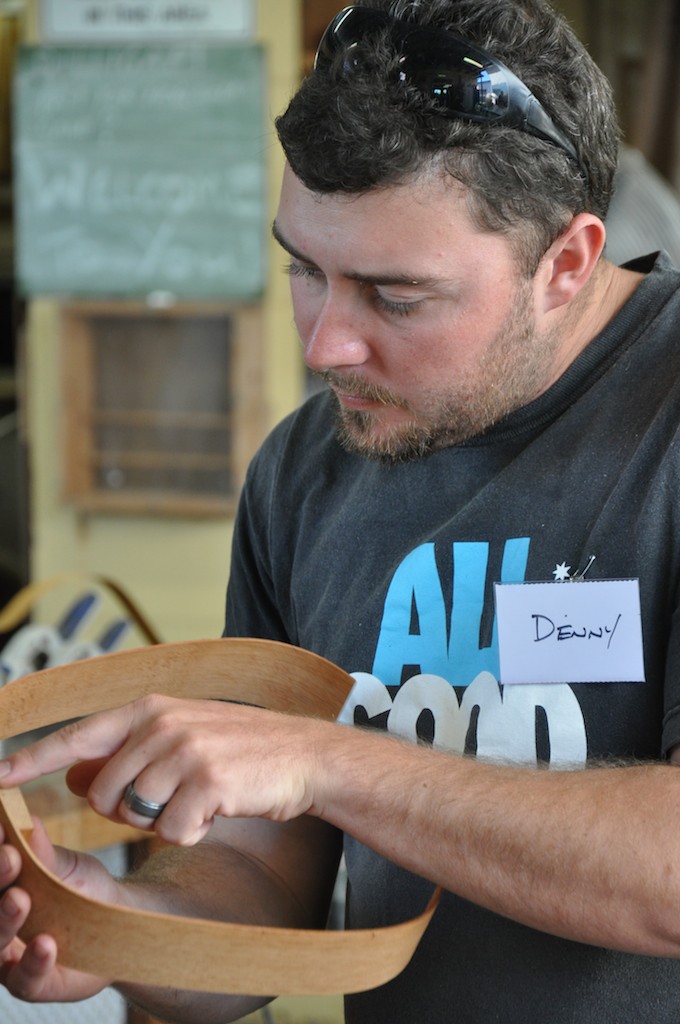

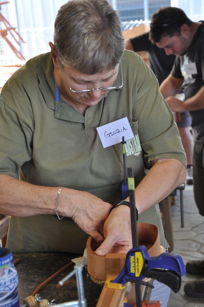

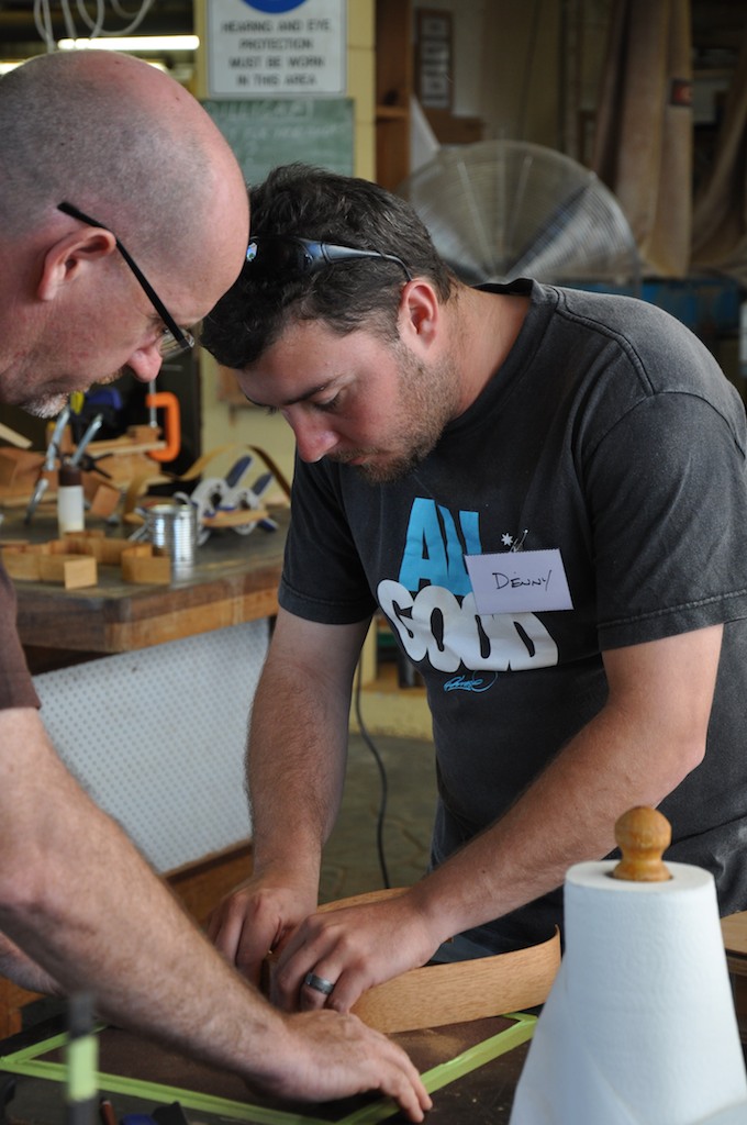

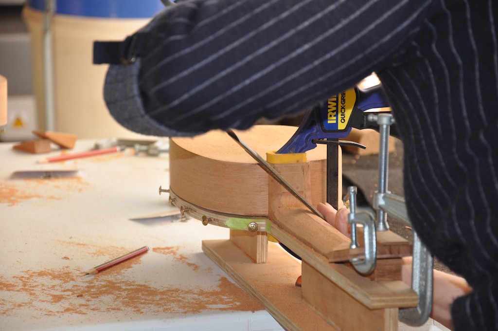

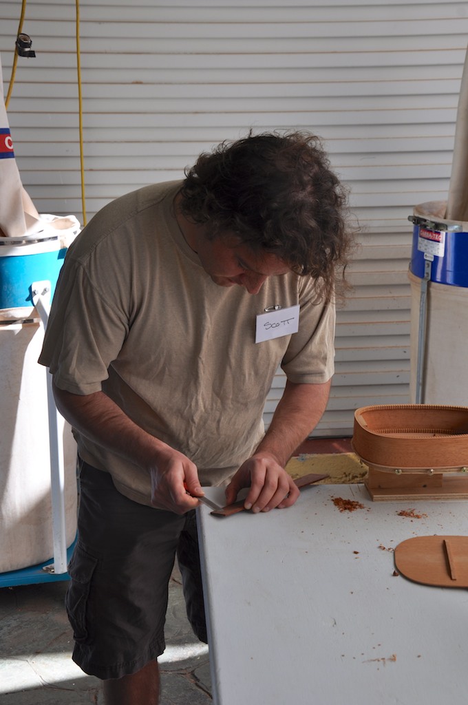

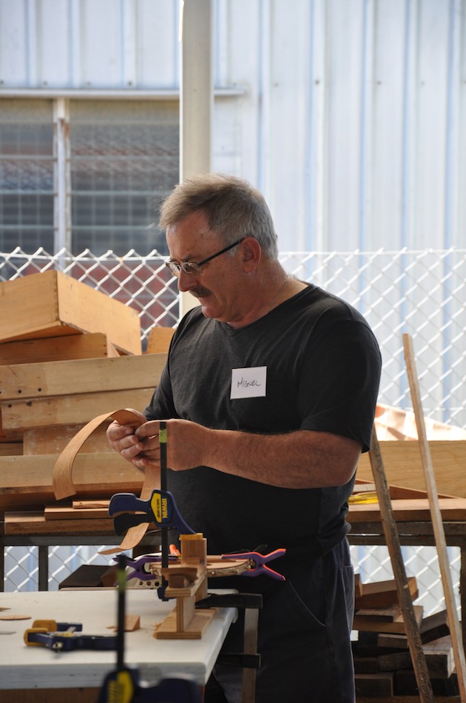

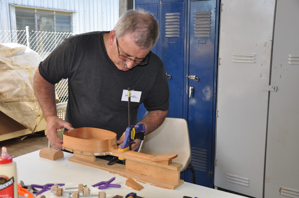

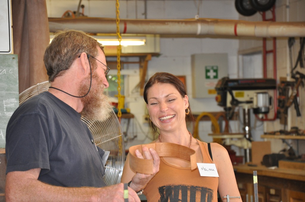

The Ukulele course started Monday morning with an eager and happy bunch. One came from as far as New Zealand to be part of the experience, and I think to escape the cold didn't hurt either.
Tail Block is glued to sides first up.
Levelling it and inspecting

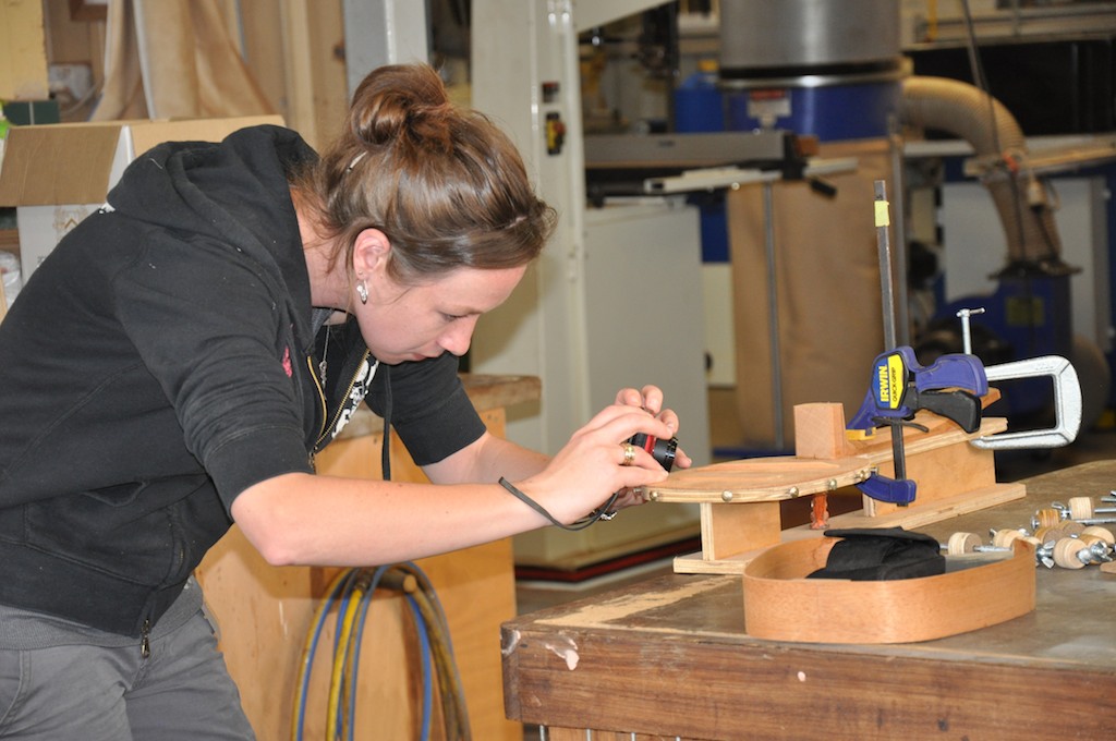

Pleased with the results
By the end of the first day we've got up to the back linings in, plus braces glued to the back.

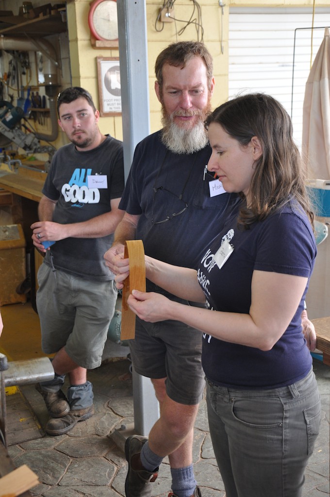

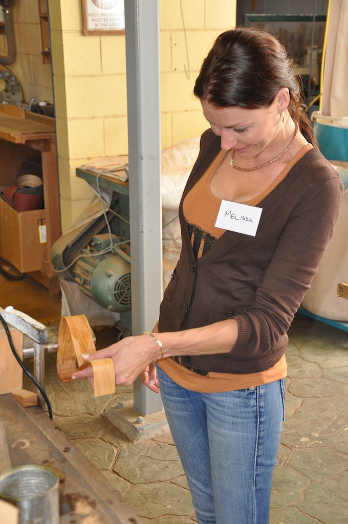

We also give everyone in the class a chance to hand bend some wood. Easier than they thought it would be too.

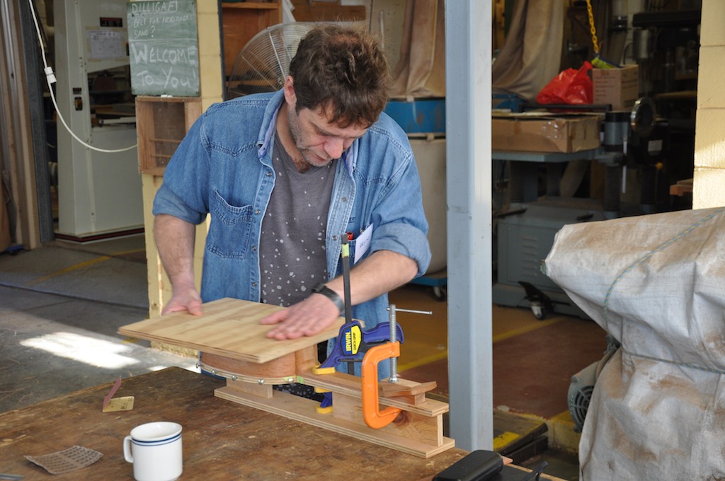

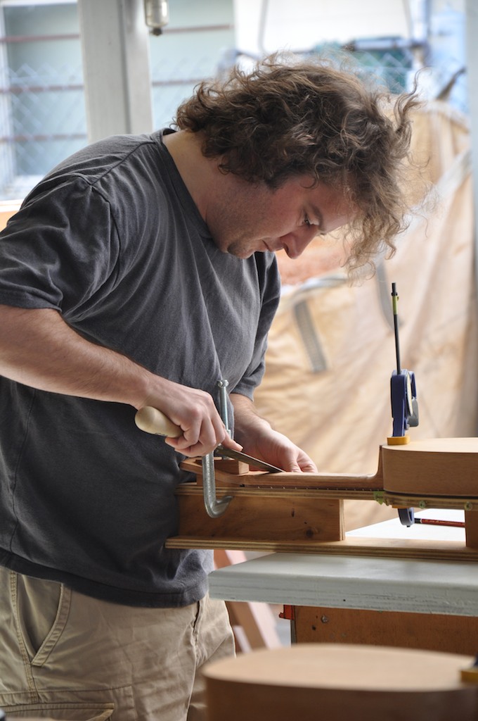

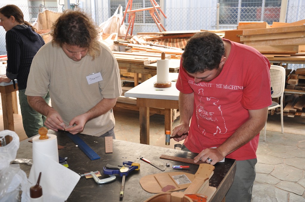

Post by Allen » Tue Jul 03, 2012 6:43 pm

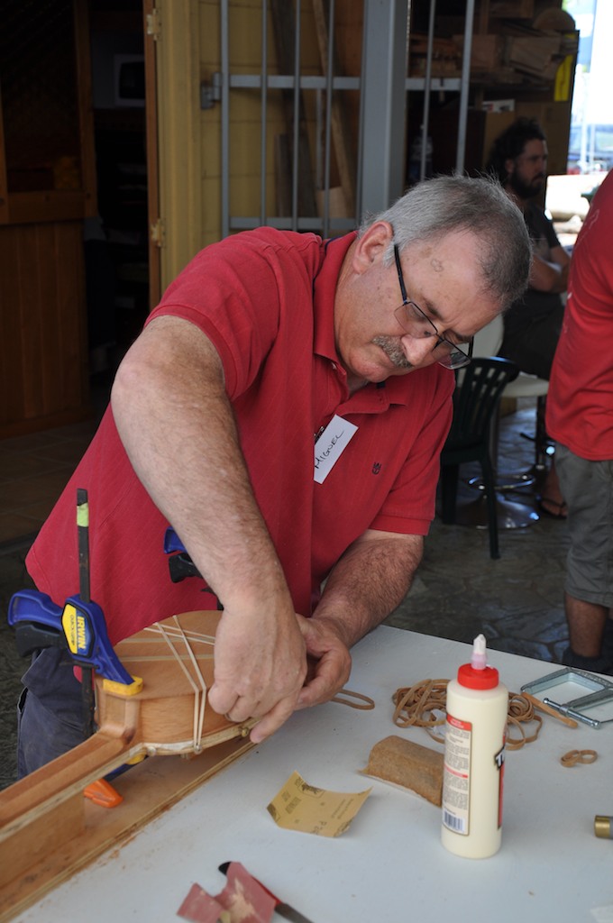

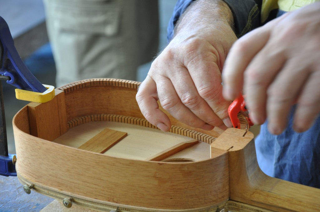

Another great day with the class. The body is now closed up and yes, there was a little bit of air uke play going on this afternoon. 8)
They must all be pretty keen, because even though the class was set to start at 9am, they were all eager to start with one even beating Micheal and I to the premises well before 8am.
Again, it's a pretty tight schedule we have to keep in order for joints to be glued up with enough time to set before we can take the clamps off and progress. So first up was to get the builders label on the back, level the linings and get that back glued on. We had a request from a couple of people for the addition of pickups to their instrument, so I gave them an option of either a MISI under saddle with on board preamp, or a K&K twin spot internal, as I have used both on several instruments and know that they work well in ukuleles.
We installed the K&K before the back was glued on, with all the jack holes drilled in the tail blocks for both the K&K and MISI. Makes life much easier this way.

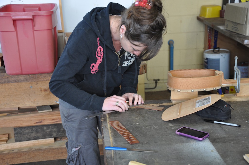

Then there was the fret board which as many will know is a fair bit of work getting right. Especially when you have this many students whom have never done this type of work before.
By the end of the day the fret board was installed to the neck, as was the peg head overlay.

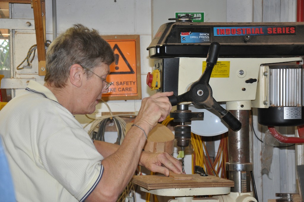

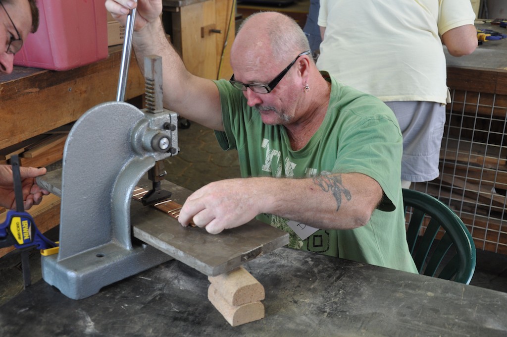

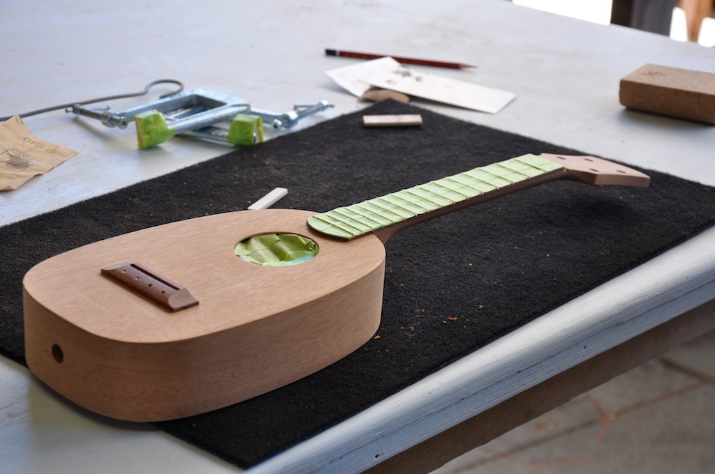

And let's not forget the most anticipated and talked about part of this ukulele building course. It's the food. The catering that the women of the Cairns Woodworkers Guild provide is simply amazing. Home cooked meals that will put the kilos on to the point of needing a new wardrobe by the end of the week. They are even sending the students off with takeaway containers of left overs for their evening tea.

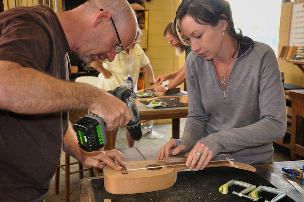

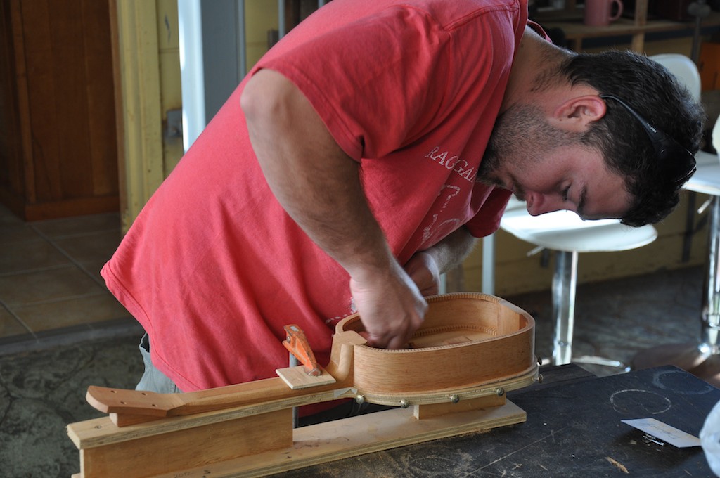

Post by Allen » Wed Jul 04, 2012 7:16 pm

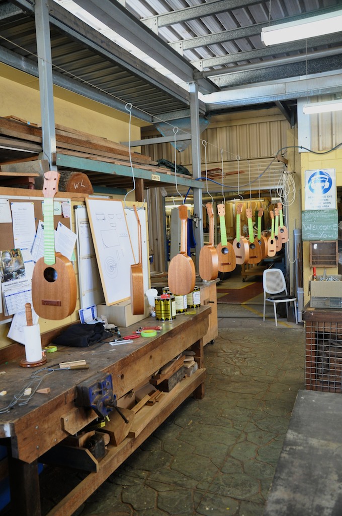

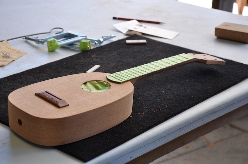

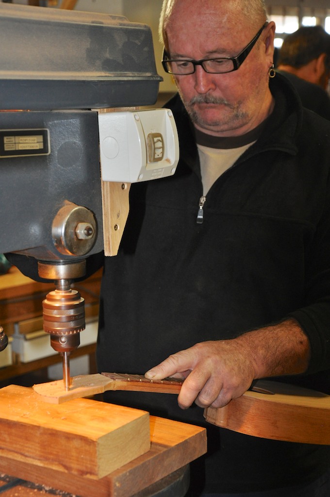

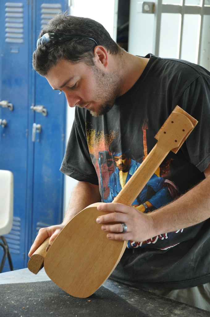

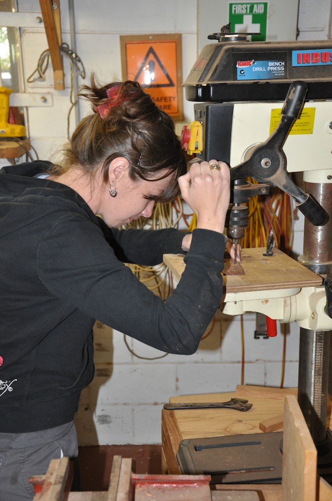

Another big day in the workshop and we've got the bodies add done and in their lacquer. This is the first class that I've taught that everyone liked sanding and really hooked in and did a fantastic job of it.
First up we flush trimmed the top and backs to the sides with a laminate trimmer. Didn't let students do that step as it's fraught with disaster if not done correctly. But then it was on to the sanding blocks etc. to get everything looking shmick. We then had to drill the peg head overlay for the tuner post, and then counter bore for the tuner bushing. All easy jobs with the right tools and a little guidance.

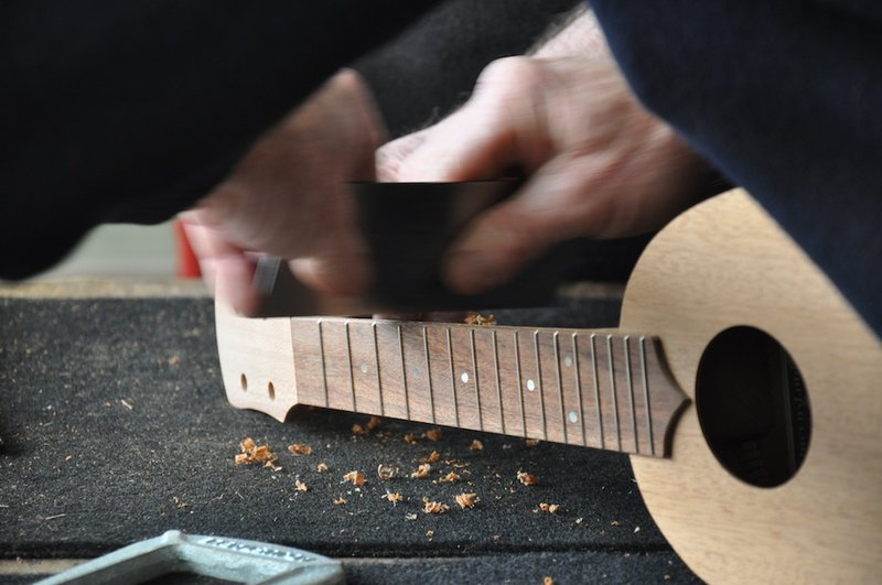

Then the big challenge for everyone is shaping the neck. We spent the most time with that, and it was interesting to see the varying shapes that came out of the class. Depending on their musical background seemed to determine the shape that they wanted for the neck profile. Everyone of them turned out great.
Finally I gave a bit of a lesson on spraying lacquer for anyone that was interested. 4 coats of satin lacquer with a light sand just before the last coat to give a really nice finish in a short amount of time.

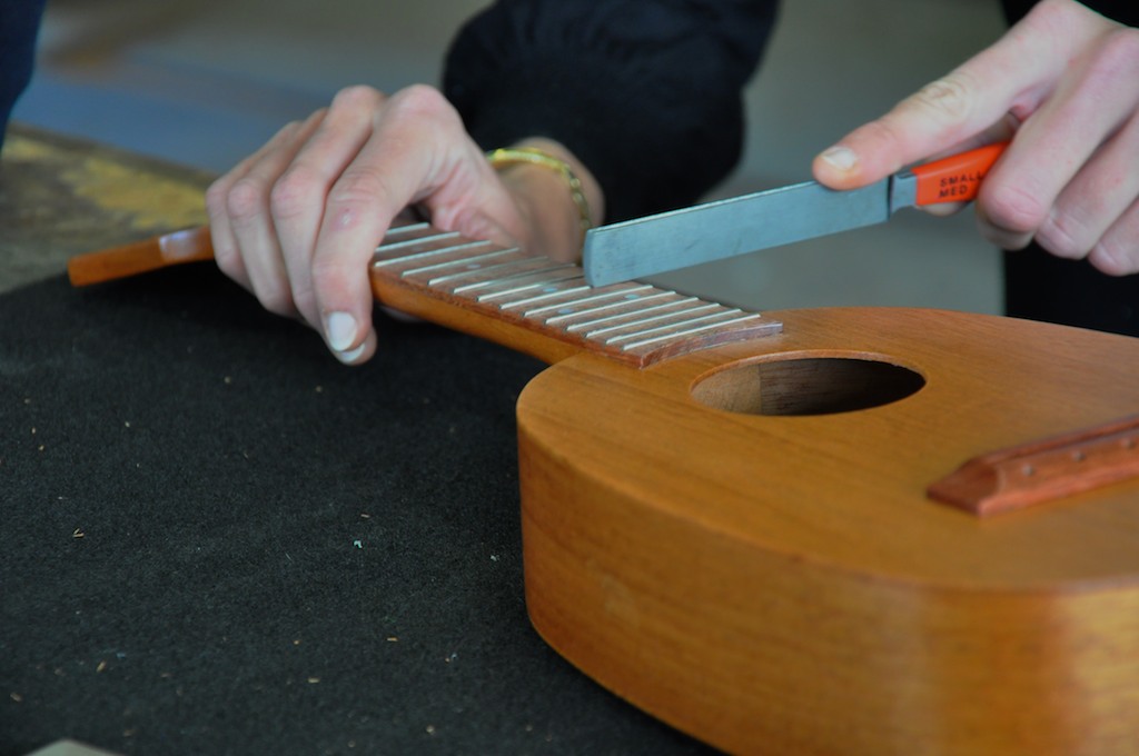

We've hit Thursday running with just the set up left to do.

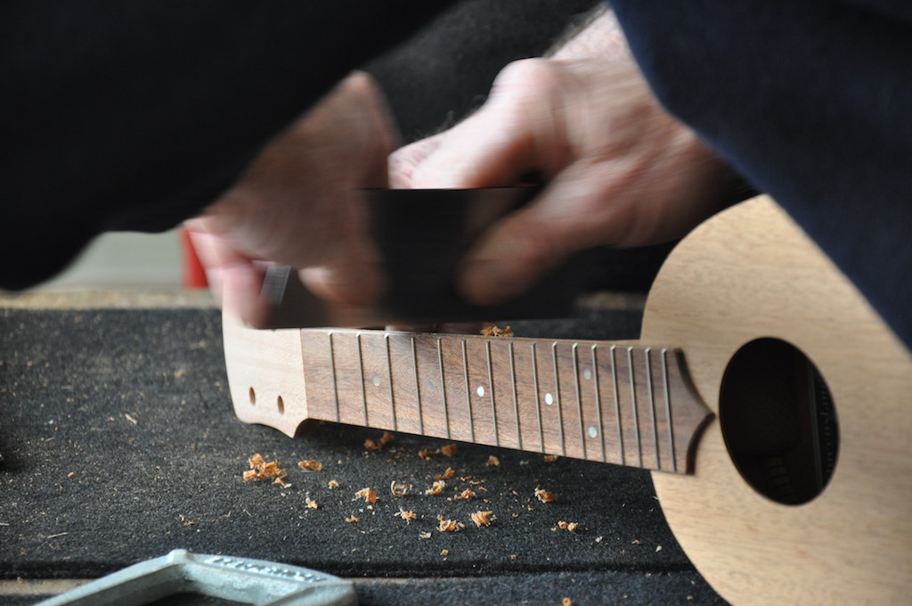

First up was levelling frets with a 6" diamond stone and then dressing frets.

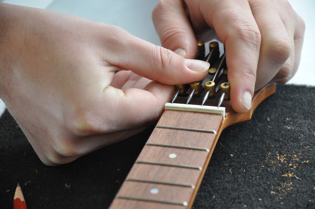

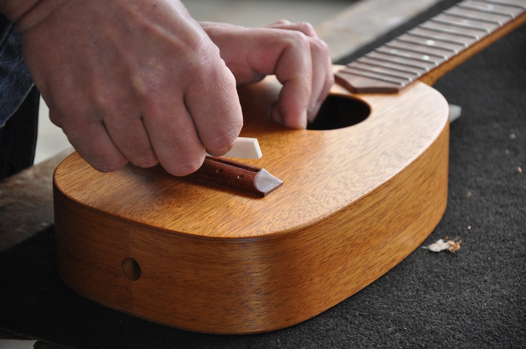

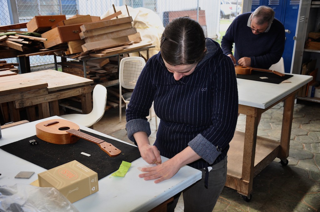

Then their is making the nut and saddle. I purchased a little tool from a ukulele and tool maker in England for laying out the nut thinking it would be handy for students. Turns out it's really handy in the workshop for me as well.

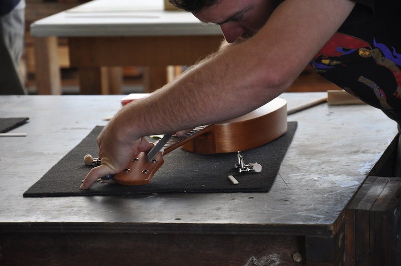

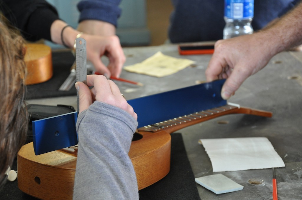

Calculating the height that the saddle will need to be for correct action at the 12th. We use a 1/8" drill bit at the 14th fret and a straight edge resting on the first fret. It's a very quick and easy way to get that saddle very close. Only needing adjustment if you can't read a ruler very well.

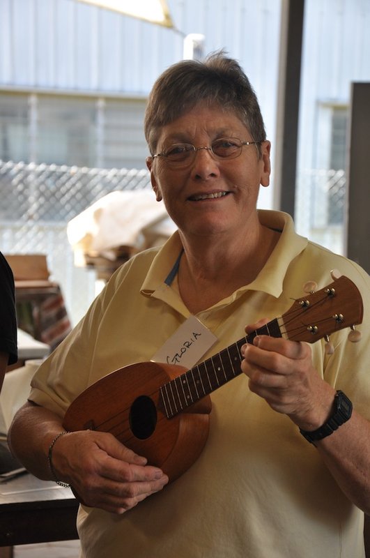

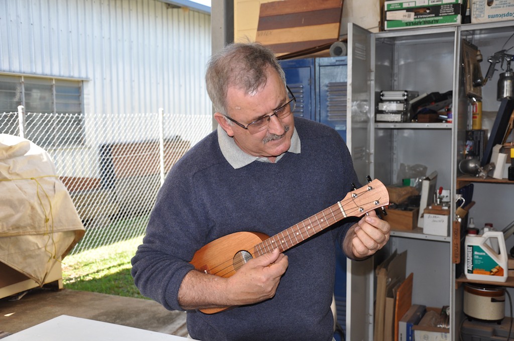

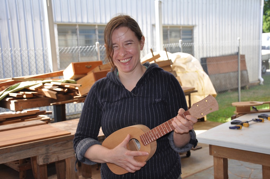

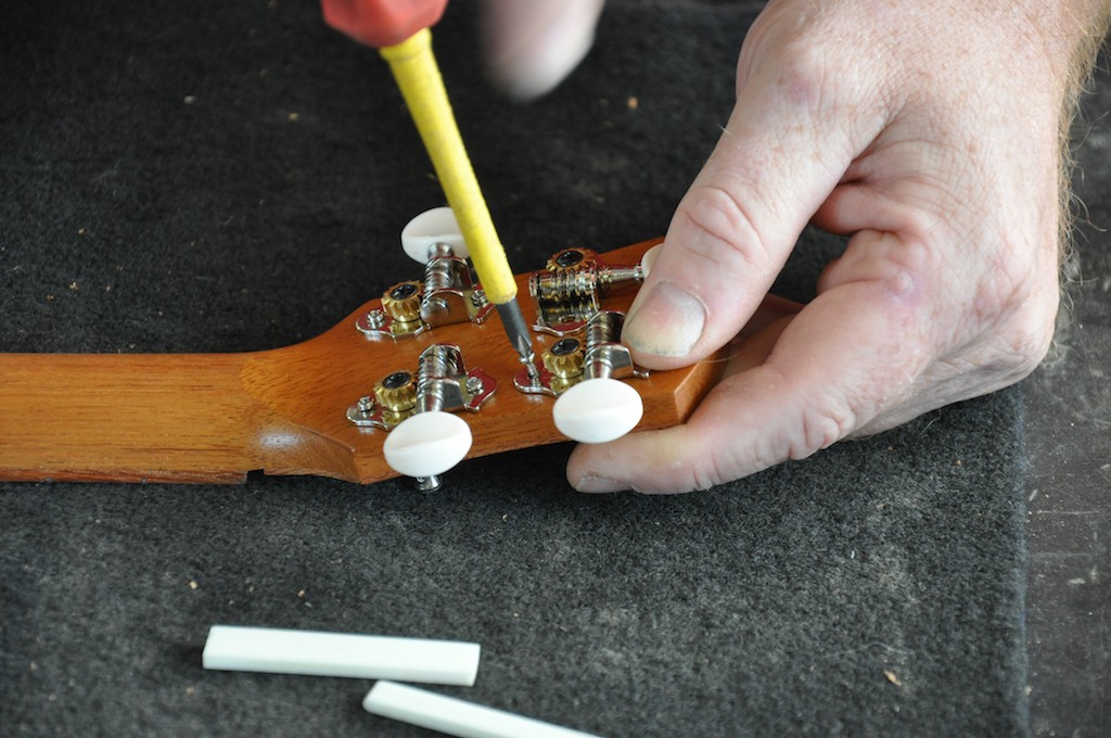

With tuners and strings to install we went around the class demonstrating how to do setups including chasing down balance issues on a couple of the instruments that had installed the MISI pickups.

Even spacing Nick as it doesn't go from fat strings to skinny strings.
Re: The 2012 Cairns Ukulele Building Course
Post by Nick » Fri Jul 06, 2012 2:11 pm
liam_fnq wrote:Even spacing Nick as it doesn't go from fat strings to skinny strings.
Thanks Liam, that's what I was thought the reason would be, once I'd started actually thinking about it :oops: .

Have just finished the course and am now the proud owner of a Brazillian mahogany pineapple uke. It's a really good instrument. An equivalent instrument in a shop with a recognised brand would sell for an amount far in excess of the cost of the course.
Allen and Micheal were brilliant instructors and extremely generous in sharing the secrets they've learned through the years. Once again, the value of the information the provided was worth far in excess of the cost of the course. The attendees were a great bunch and a real pleasure to work alongside. The catering ladies did a brilliant job and some of them brought in ukuleles they had made in previous courses. It was a great "family" experience with members popping in and out and everyone getting totally involved.
The finale was being invited to Allen's home to see his workshop (and pizza oven). A real privilege.
It's the best holiday I've had in a long, long, while. I cannot recommend the course highly enough.
