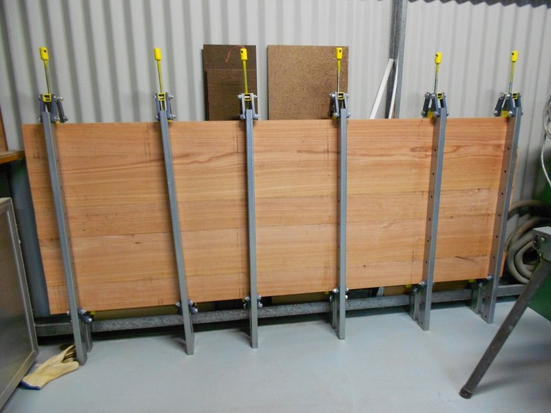

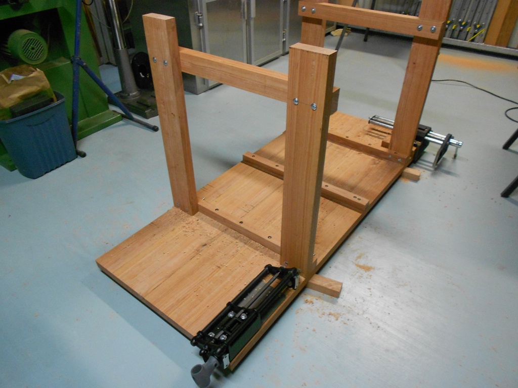

As the debate continues, my new bench is one spur of the moment decision a few weeks ago when I was trying out a field bandaw I've fixed up and had for a long time but hardly used. There was a dead tree standind in the paddock, cut it down and turned it to 50mm thick lumber, hmmm. now what to do with it, I know Ill build a decent workbench as I have allways put up with a door on tressels etc, my current bench was put togeather out of whatever scrap I could find and placed on top of a discarded shop freezer, now in my 60's I whant something better, something that doesn't rock all over the place while planing etc. but most of all having a chat with friends and relies around the bench and wow has it created discussion at home, my kids nowin their 20's are starting to think, what can I make? this makes it all worthwhile & fun.
25Years ago I built a kitchen out of Jarra and coated it with Cabothane poly with a hardener additive and it's still going strong doesn't even need re-coating yet.
I am going to try to add some picks for all to see.

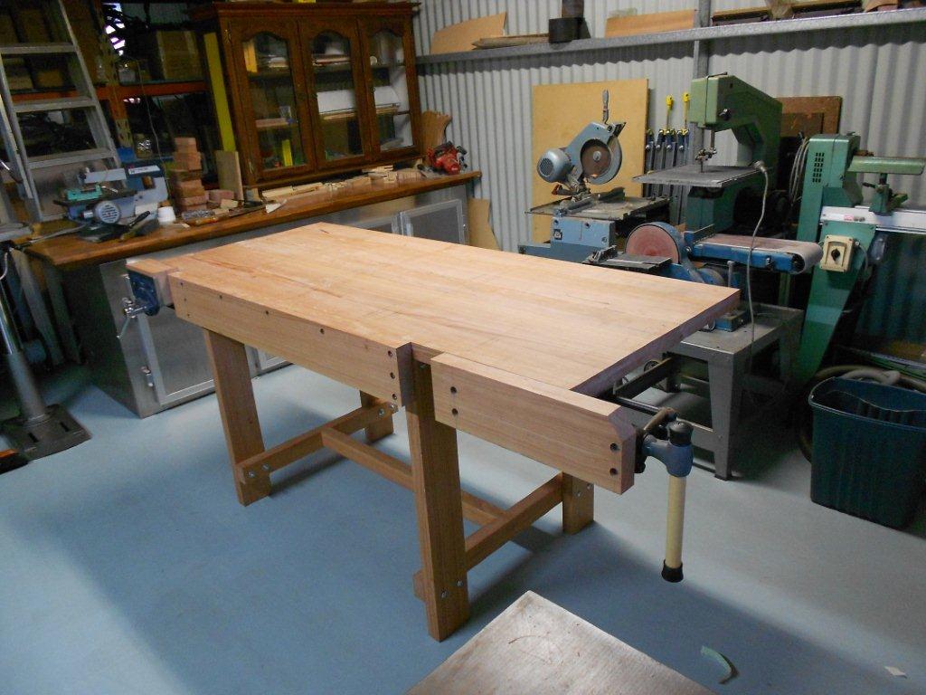

Very nice bench Eric
But that floor bothers me!.........It's far to clean!
Re: workbench finish
From your own tree and into your own bench , that's cool Eric.
How are you going to do dog holes for the tail vice? drill in round ones ?

The floor is coated with 2 pack concrete paint and yes I do believe in a clean shop floor it reduces the chance for accidentsNick wrote:Very nice bench Eric![]()

I like the idea of 20mm round dog holes and dogs with sqaure blocks on top to allow for different shapes, when I know where to put them and how many. I plan to use a 25mm steel block with a 20mm hole as a guide to keep the holes verticalauscab wrote:From your own tree and into your own bench , that's cool Eric.

Looks like it'll be a very nice bench and a pleasure to work at. Nice work....

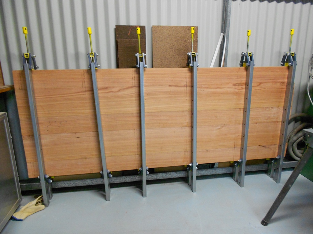

Nice bench. A bit of previous woodwork experience evident in that and a pretty well stocked workshop too. Those panel clamps are not exactly cheap! Very handy for that job though no doubt.
- EricDownunder
- Posts: 170
- Joined: Wed Apr 18, 2012 12:59 pm
- Location: East Kurrajong, NSW
I made the panel clamps from bits and peices laying around.J.F. Custom wrote:EricDownunder wrote:What would be the best product to finish off my new wood workbench? Australian hardwood!
And here I was thinking you had asked the question, then gone on and answered it in the same sentence...Shortest new thread ever!

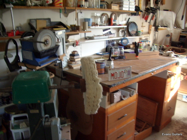

I don't rush the coating of my benches, it takes time. They are covered with a mixture of varnish, glue, paint, lacquer, coffee [rings], and the occasional phone number and small drawings of light bulb moments of design ideas.
Ah.....a bench with MOJO....nice
