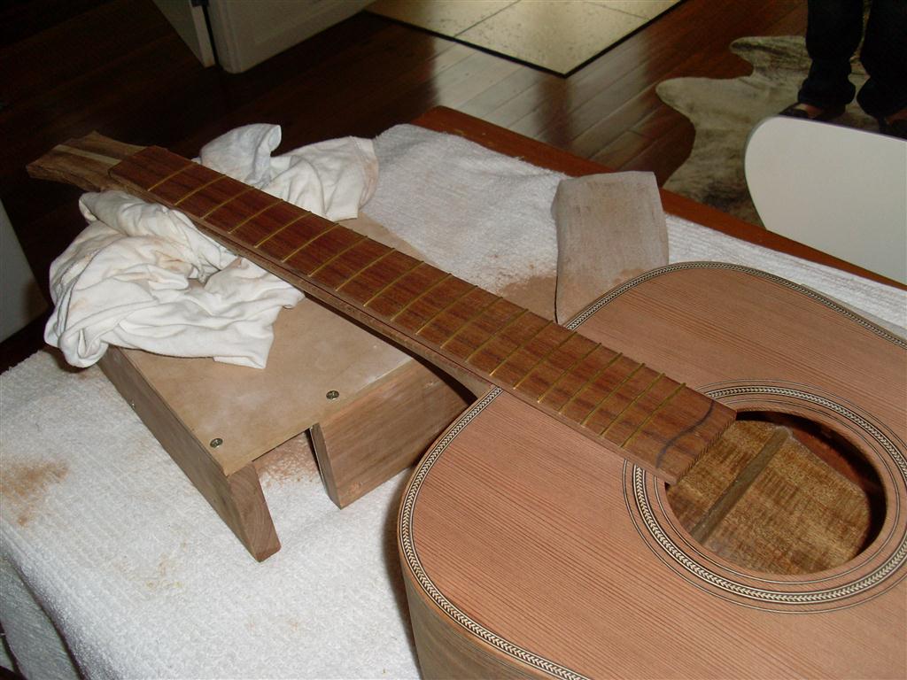

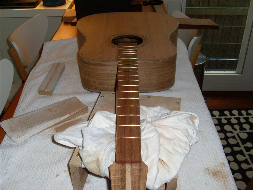

I'm in the middle of doing bound fretboard. Pink Gidgee with Blackwood binding. Here's what I did.
1: make the fretboard to 1mm over each side, and cut the fret slots.
2: radius the fretboard--I went 12".
3. re-cut the fret slots to match the radius, and knock the corners off the tops of the fret slots.
4. trim the fretboard 1mm thinner on each side.
5. glue on the bindings, .5mm oversize, and with 1mm over on the top and bottom.
6. sand the back flush.
7. sand the top flush using a radiused block.
8. sand the sides on a shooting board, until I got the widths right.
9. dither a bit until I got up the balls to do the frets.
10. watched Robbie O'Brien's video on fretting.
11. stopped dithering.
12. ground my sidecutters to a slight crown at the cutting edge, and cut the tangs off the frets and bashed in the frets. 28oz Estwing framing hammer
13. gonna put the side markers in tomorrow and glue the bugger on the guitar, but this is what it looks like today....
Actually, I've trimmed the end of the fretboard, and sanded it, but you get the idea....
Edit: this is my second, but I'm trying some new things

And thankyou Nick your step by step process was also helpful,I can't really tell from your picture ,but have you bound the soundhole end and nut end of the board or just the sides ?
Cheers Tod

Re: Fretboard Binding
Hi Tod,
No. I didn't bind the sound hole end. I thougt about it, but the pink gidgee looks pretty cool on the endgrain. If I was going to, I'd do the end first oversize, and trim it off with a craft kife and mitre the sides into that.
I also left the nut clear. I've left the fretboard long, even though the zero fret is cut, because I have a small hole dead centre of the fretboard, and I'll tack it to the guitar with that to keep it from moving during glueing up, and cut the whole lot off when it's set.
