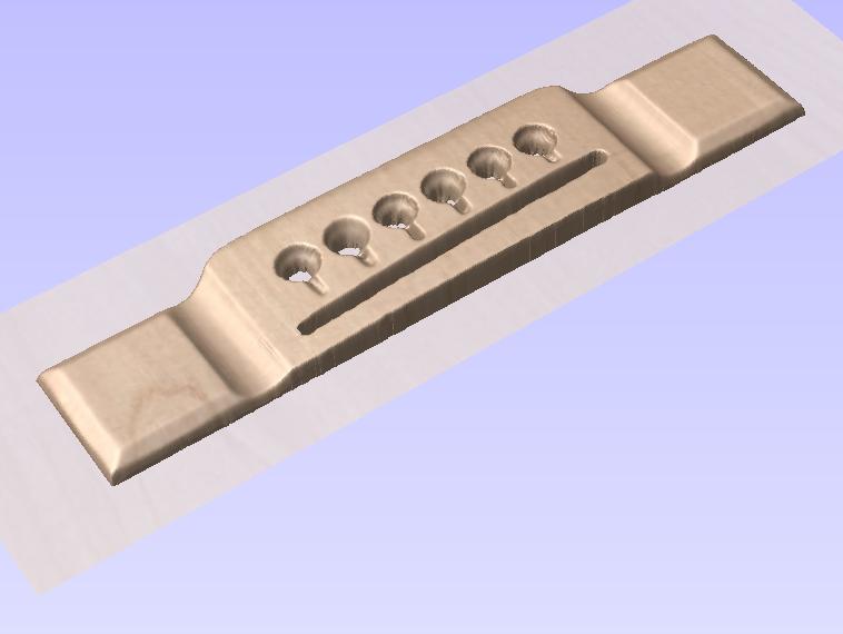

Got to take my hat off every now and then, when I can see what can be achieved with modern technology

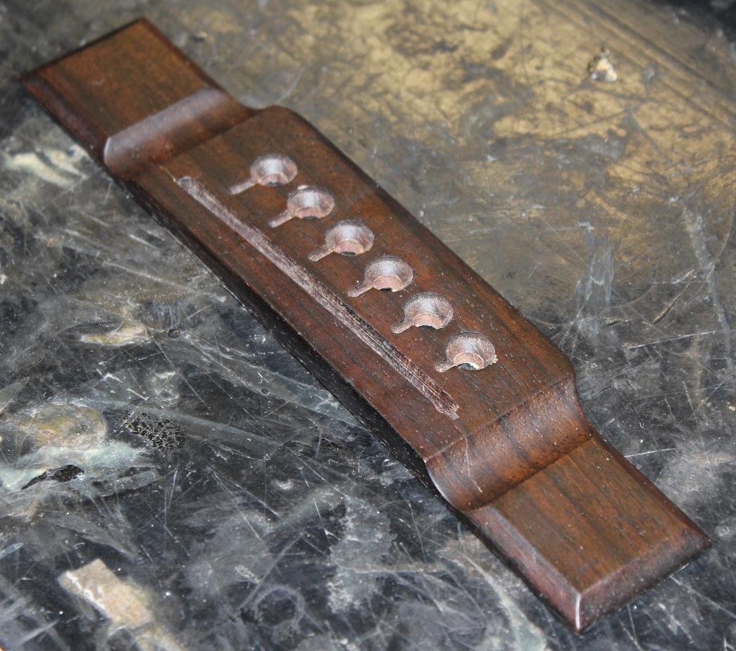

We have had a few washburns in with cracked bridges, Im old school hand make a new one, but we currently have three in at the moment that need replacement, Ummm washburn """design flaw maybe"""
So I have a cnc laser scanner which has been used as a storage shelf, completley covered in cases for musical instruments, thats how often I use it.
But stuff it I bought the damn thing for this exact situation, so after finding a computer plugging it in / wiring it up pulling my hair out trying to re-learn this crap, I had success....yay
Cracked Bridge
Re: Modern technology
Post by simso » Sat Jun 09, 2012 2:49 pm
Laser scanned image
washburn laser scanned.jpg (24.38 KiB) Viewed 12852 times
Post by simso » Sat Jun 09, 2012 2:50 pm
Notice it scanned in the bloody crack as well.
I just need one of my guys now to reverse engineer it and punch a few out on the cnc, :)

Better yet just open the split a frag and glue and reclamp. Then sort the break angle or saddle angle in the slot. A: Glue is as strong as wood B: The bridge has split from the saddle top pulling to the north.

Lee wrote:Money on a bridge blank +home-made copy carver, drill press and 15 minutes max.
If you can do that on a copy carver in 15minutes to a finished product Ill eat my hat. Not possible, and yes I do own a copy duplicator
Allen wrote:Cool technology, but it seems to me it would have been so much easier just to design it in CAD in the first place.
I'm certainly no guru at this stuff, but that wound not be more than 1 hour total to design in 3D ready to go to the CAM software. Actually after looking at it for a bit, I'm thinking it's more like 1/2 hour tops.
Allen you could be right, however I know very little about cad drawing.
Post by simso » Sat Jun 09, 2012 5:29 pm
Lee wrote:Better yet just open the split a frag and glue and reclamp. Then sort the break angle or saddle angle in the slot. A: Glue is as strong as wood B: The bridge has split from the saddle top pulling to the north.
The purpose is to make it better, there is a design flaw in these bridges with the scalloped edges making it weak, bit pointless gluing it up to then have the same thing crack again.

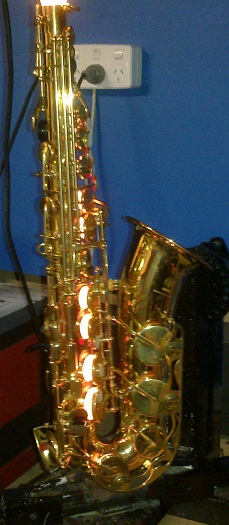

The scanning possibilitys are endless
Imagine scanning one of these in and making a wood reproduction....
If it was in my shop I'd make a whole new bridge.....design of the bridge isn't the best...in fact it's downright ugly.

Slightly intrigued by the "split" which from here does not appear to follow a grain line. Good lookin or not it's what it is and once worked. Am in the same area myself. Pick the "split" has come from abuse rather than good use.
