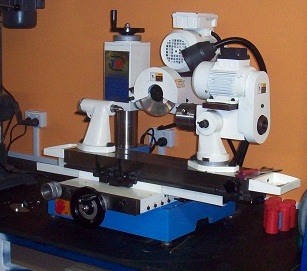

Im spoilt,
I use a diamond grinding wheel, resharpens router bits, milling machine cutting bits, screwdrivers drills chisels etc, and no water or coolant required
Super spoilt
Super spoilt

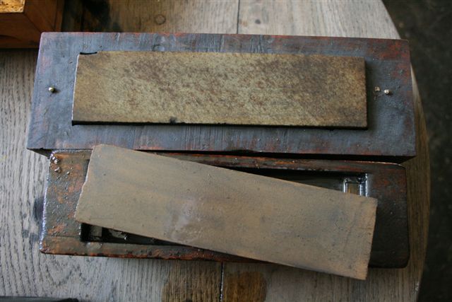

Re: Diamond Sharpening Stones
The top pic are the two I use most , the upper one being the fine one. Could be a man made one . not sure ? the lower one Man made.

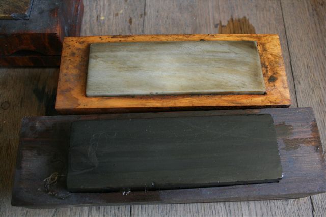

The next picture shows two green stones.
The top one is a Charnley forest. The Charnley Forest was one of two types of stones available to the English woodworker before the year 1889 according to Walter Rose in his fantastic book “ The Village Carpenter” first published in 1887 . Walter also talks of a Turkey stone being the other stone that was then sought after, Brown to white in colour, and considered better than the Charnley Forest . In 1889 he writes the Washita came, and was “Hailed with delight by all woodworkers, who straight away discarded their Charnley Forests for ever” Must be how I got to buy one .
The other Green spotted one could also be a Charnley Forest , but I don’t know for sure.
The last picture is a White Arkansas and a Black Arkansas, you can see the fine swirls I was doing the other day on the Black showing it off to some friends.

I have some second hand diamond teeth that have been brazed to a bolt head which I dress the stone with before each grind session, if the wheel looks like it needs it.
One of the best tools ever pointed out to me . I never used to dress my wheel. The difference is huge.
