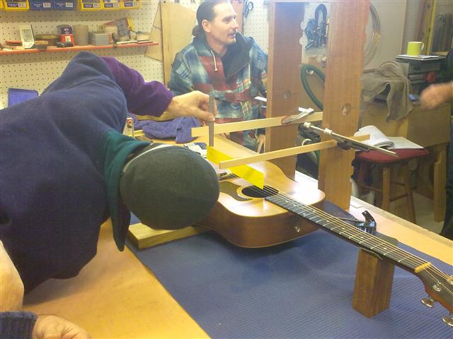

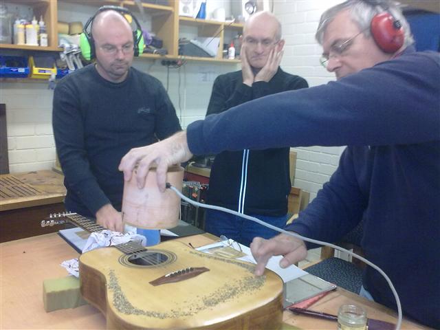

Well, us locals donned our beanies & welcomed a great bunch of guys to our frosty little corner of the world.
Straight up I'd like to thank Dom, on behalf of everyone, for organising the course AND for opening up his house & workshop to a bunch of guitar geeks. Cheers mate.
I'd also like to thank Trevor, not only for coming down here to present his knowledge, but for being so open and receptive to questions, queries and confusions.
Finally, I'd like to thank everyone for bringing their instruments with them for us to 'peruse without pressure'.
Damn you guys do some good work! Note: All persons depicted in the above photos are 'stand in actors'.

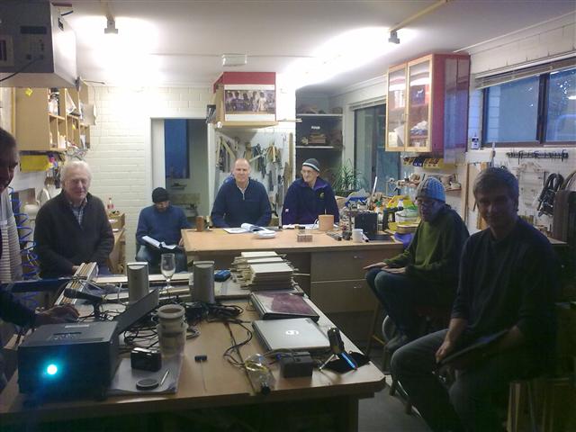

Can we get a few names to the line up in the last pic Craig? I see your names on the forum everyday but it's quite nice to be able to put a mugshot to the name when the opportunity such as this (when all suspects are assembled in one place) arises

The bottom photo from left to right shows Trevor (with his head cut in half), Bruce, myself, Frank, Nick, Dom and Mark. The next shot up shows Craig and the back of Nicks head. The only one missing from these shots is Graham.

Is Dom the one with the tea cozy on his head?68matts wrote: The bottom photo from left to right shows Trevor (with his head cut in half), Bruce, myself, Frank, Nick, Dom and Mark. The next shot up shows Craig and the back of Nicks head. The only one missing from these shots is Graham.

Yes that's me Martin, green jumper. I was bloody cold. I've never spent so much time in my workshop just sitting.kiwigeo wrote:
