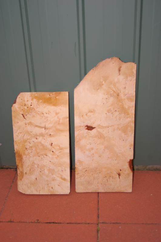

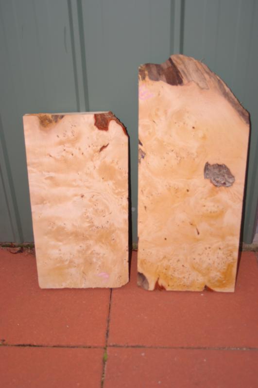

I had this Huon sent to me by a guy who wants me to use it for a rosette and headplate on a guitar i'm building for him. He was dead keen on having Huon pine on his guitar so he bought this on ebay. There's enough for a stack of rosettes and headplates. Only problem is it's still a bit green.

Resaw close to required thickness and it will dry out quick smart..you'll probably need to keep it stickered to keep it flat but then you can run a low speed fan near by to really push it along.
- Posts: 1643
Re: Some nice figured Huon Pine
That usually works with "straight" wood, for sure. But I've had a lot of trouble when I've tried that with high figure/burl. It shrinks fast in all different directions and cracks like crazy. What I've taken to doing is putting it in a plastic bag (thin Woollies style) and leaving it in the house for 6 months then move it to the dry room for 6 months minimum. It still wriggles a bit after 6 months, but is better after 2 years. Bet you didn't want to know that!Kim wrote:Resaw close to required thickness and it will dry out quick smart..you'll probably need to keep it stickered to keep it flat but then you can run a low speed fan near by to really push it along.
All you can do is try both Kim and Trevors methods. A few pieces both ways and hope for the best. But I've not had a lot of luck with force drying burl either.
- 56nortondomy
- Posts: 717
Thanks guys, i was thinking along the lines of Kim's idea, but i might try both see what happens. I don't think the client wants to wait 2 years though.

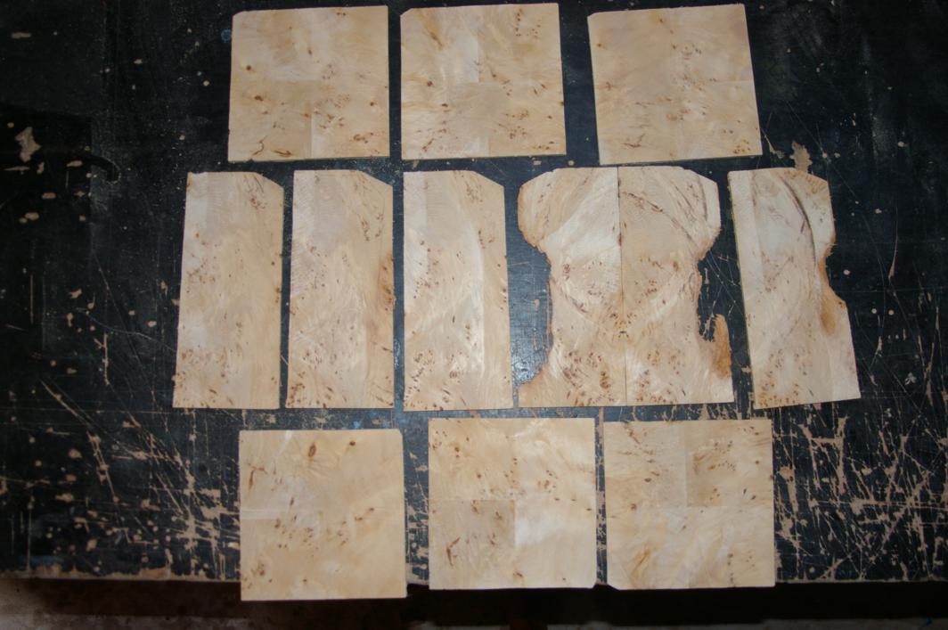

I cut some veneers off today and it seems it's not that green after all, it came from Distinctive timbers Tasmania Bob, i can only assume it's legal, it was passed on to me by the buyer.
