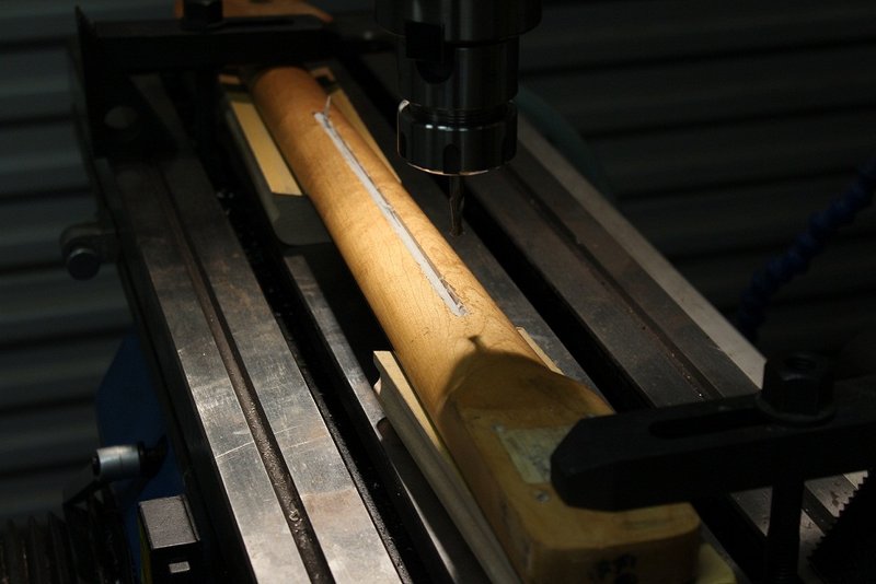

Post by simso » Sun Jun 24, 2012 4:29 pm
Speaking of truss rods,
This person didnt like the thickness of there bass neck so they sanded the back down to make it a bit more comfortable,
Whats that under the skunk stripe, a truss rodm, whoops, they then removed the rest of the skunk with I have no idea and now given to me to fix.
Yay....

Re: Truss rods
Post by Allen » Sun Jun 24, 2012 4:58 pm
Idiots. I hope you slug them good for there F*^@K up. :shock:

Re: Truss rods
Post by charangohabsburg » Sun Jun 24, 2012 7:17 pm
simso wrote:and now given to me to fix.
Just paint that bldy neck. Black or pink or whatever. They will love it.
Re: Truss rods
Post by simso » Sun Jun 24, 2012 7:21 pm
If it wasnt for the fact its a vintage fender original bass neck, I would have told them to bin it.
Re: Truss rods
Post by charangohabsburg » Sun Jun 24, 2012 7:29 pm
That sounds good Steve. Let them know that vintage Fender neck repairs are extremely expensive. 8)

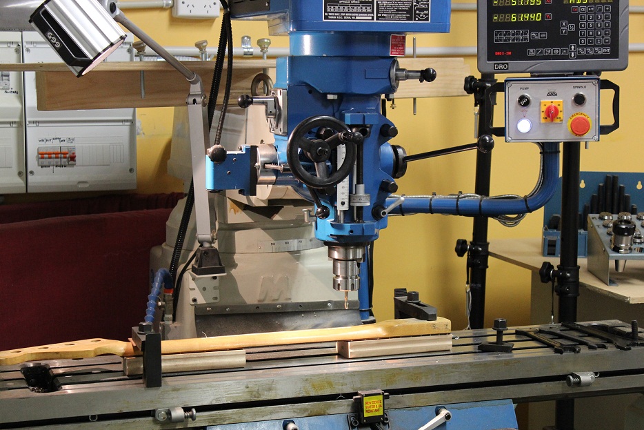

Re: Truss rods
Post by simso » Sun Jun 24, 2012 7:33 pm
Yeh got a mortgage payment coming up, sounds kind of a familiar number 8)
You can see the modified side profile on this shot, duhhh
Re: Truss rods
Post by Allen » Sun Jun 24, 2012 7:37 pm
Shite !......I want one of those :shock:
Re: Truss rods
Post by simso » Sun Jun 24, 2012 7:47 pm
Super cool for cutting fret slots, you can turn the head to 90 degrees and mount a 20" thick circular saw blade in it, then the digital readout tells you exactly where to place the cross sled.
Im still paranoid as hell however standing in front of it when its spinning a circular saw blade.
