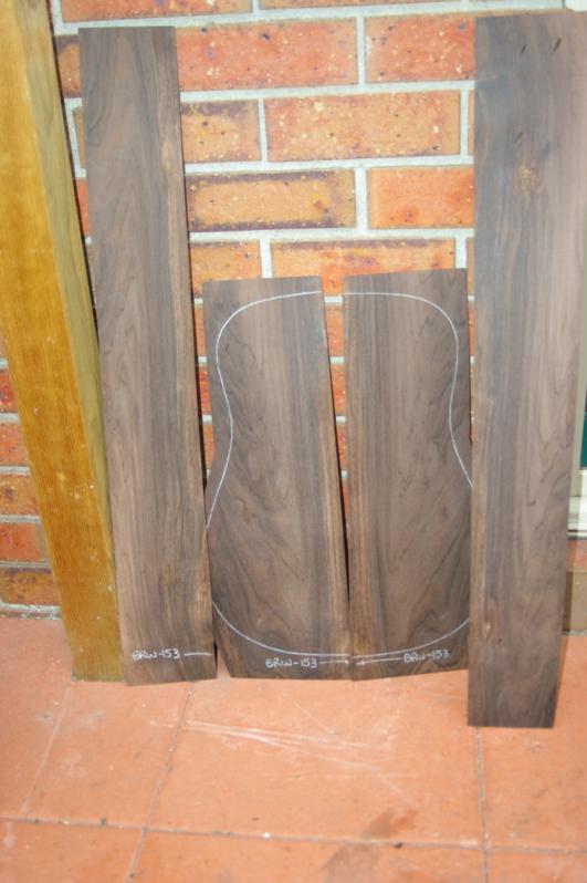

I've just had this set of BRW sent to me by a customer that wants a LaPrevotte style romantic guitar. I won't be able to start it for 5 or 6 months, any ideas how i can store it so it won't crack, which is a possibility with this timber. I'm in Melbourne so it's not that hot at the moment, it's rained all day today.

Sticker it and seal end grain. Ideally store somewhere where humidity is same as your workshop and not prone to wild swings in RH.
