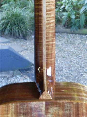

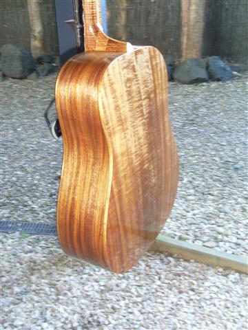

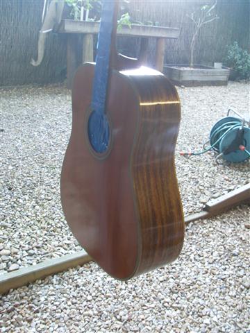

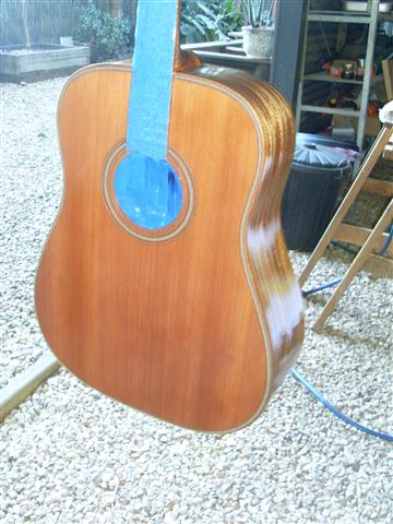

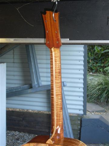

Here's a few pix after today's first five coats: Some with and some without flash....If it looks half this good when I get done, I'm gonna be one happy camper....Now it's time for a
Got mine off eBay. $28. Looks much like yours, but mine is green
Did a decent job. I'll be more conversant with it for the finish round, but I'm happy enough so far. If you're looking for a gun, I'd search for the threads by Allen regarding that topic, I think in the tutes. He knows a hell of a lot more than I ever will

Looks awesome! Hopefully I will be at that stage shortly
. I cant imagine what it must feel like to string up your first, looking forward to popping my cherry
