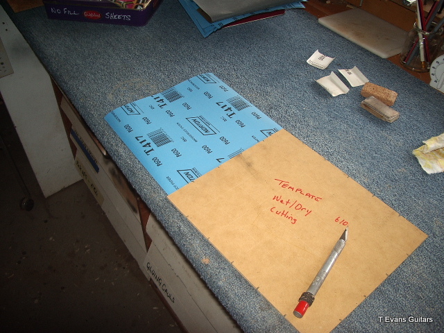

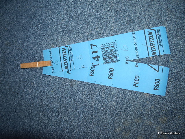

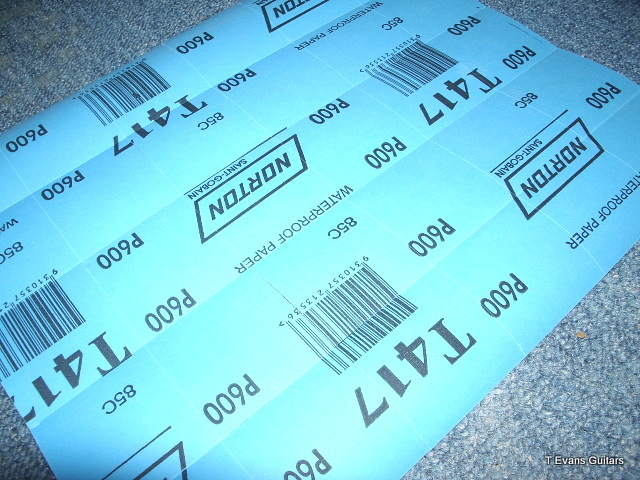

Hi all just thought I’d share this useless bit of info on what I do with my emery type abrasives. I think the pictures will tell the story but what I do is:

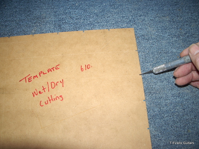

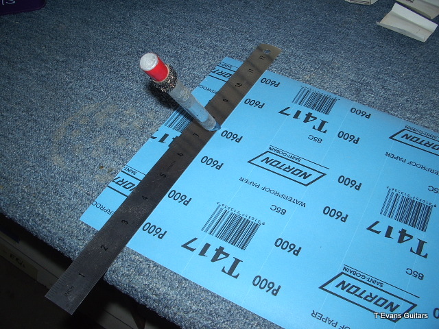

Use the template to nick the edges of the sheets, then score partway through joining up the nicks.
Do this both ways,

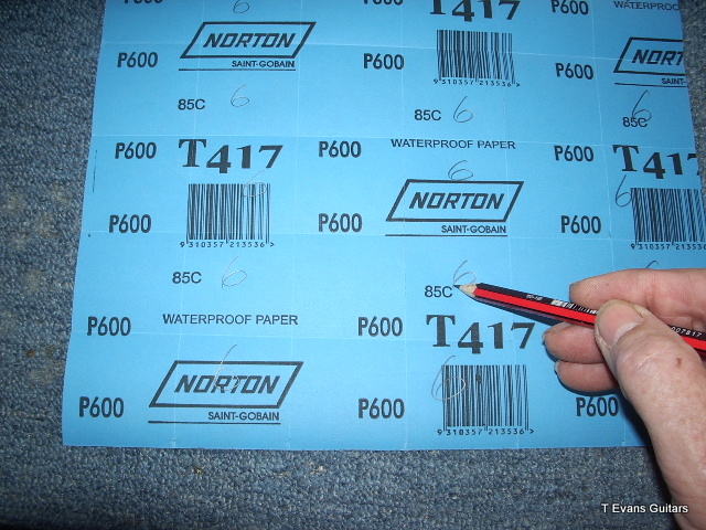

It’s easier to mark the grade at this point as when in tiny pieces some do not have the grade showing.

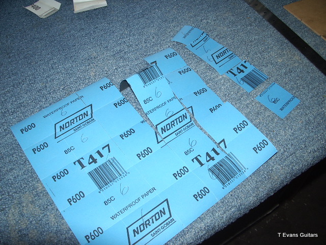

You could leave in strips and tear off as needed

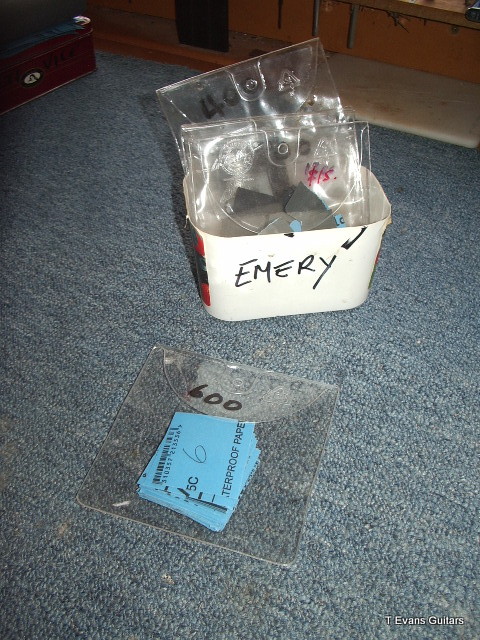

But I cut up the whole lot and store in old string packets with the grade marked on the outside.
Each packet contains a different grade

Taffy, the thing that struck me most about this little technique is that you work with such small pieces of paper. Do you cut back a top or back with the paper that size? Frank
