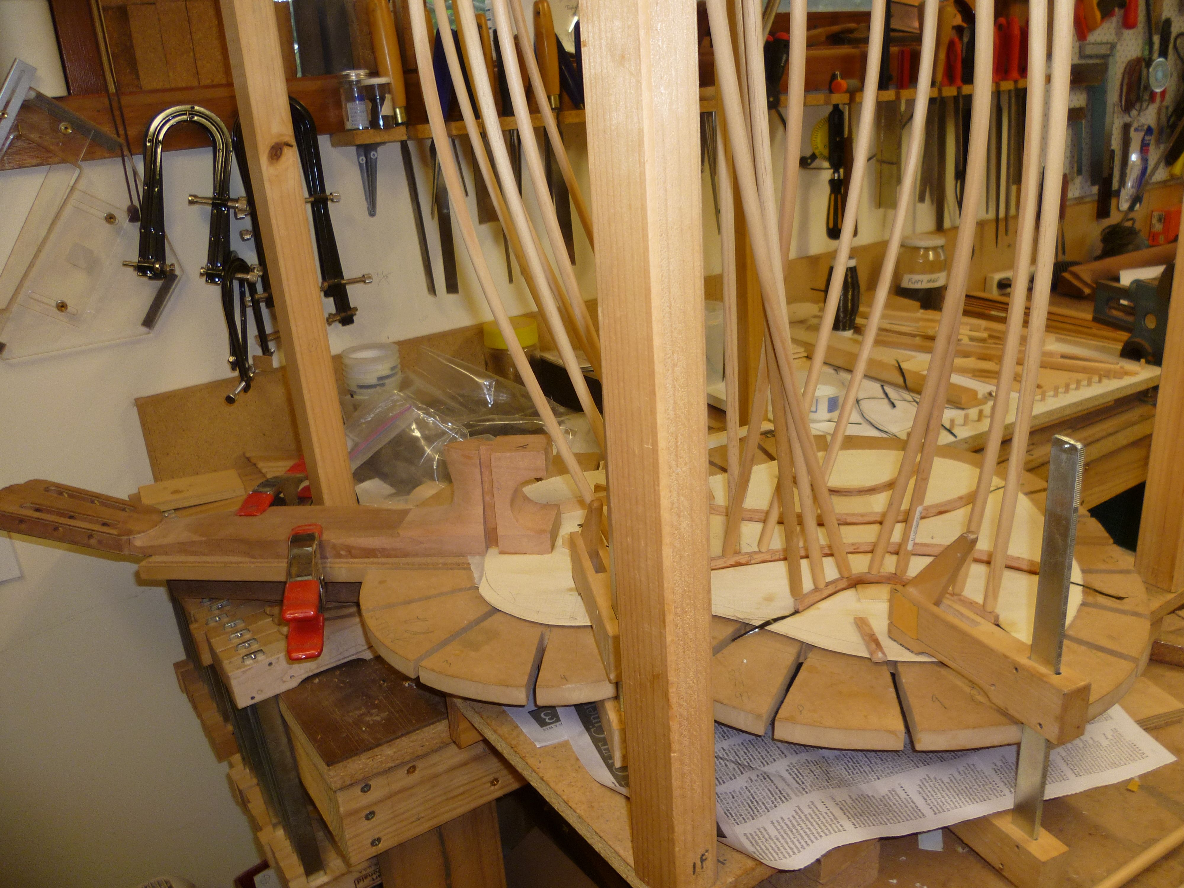

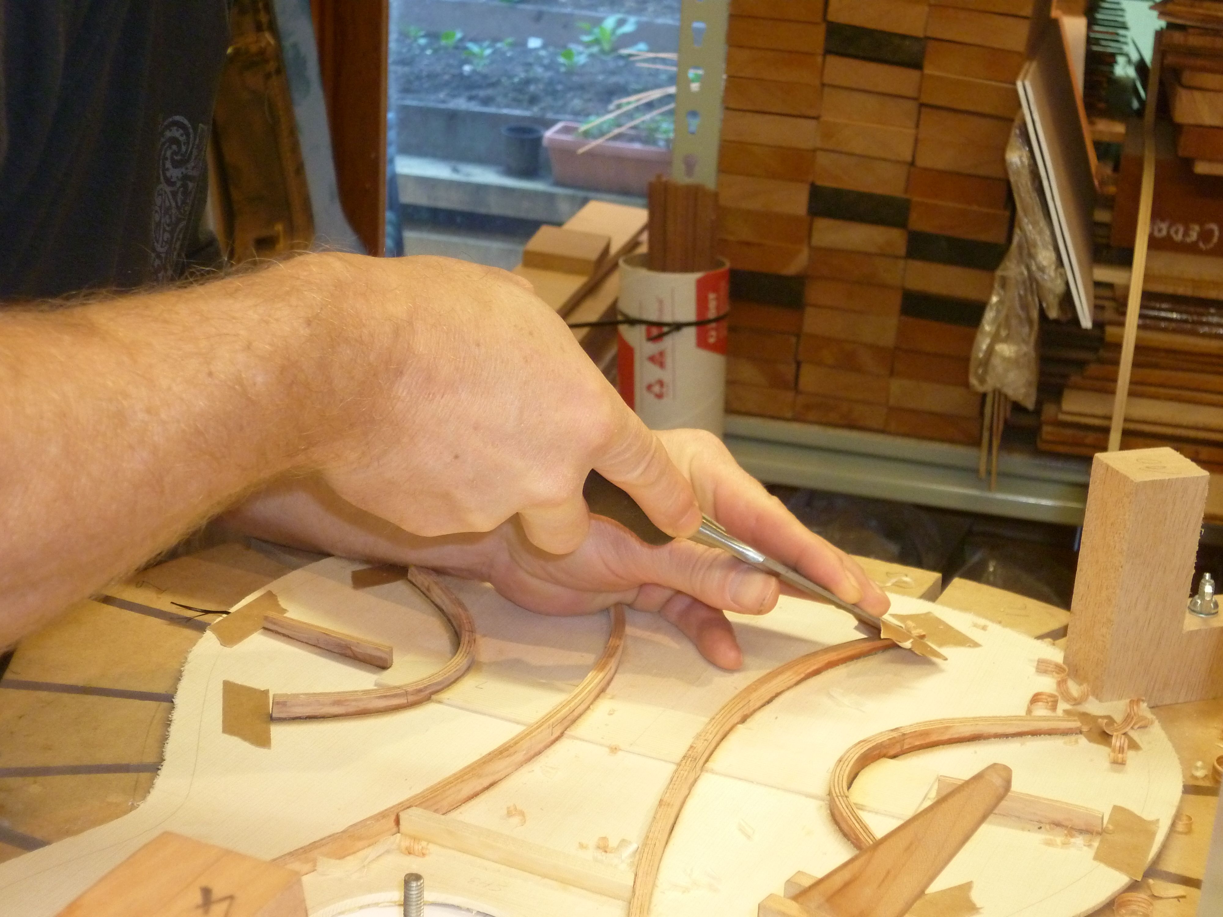

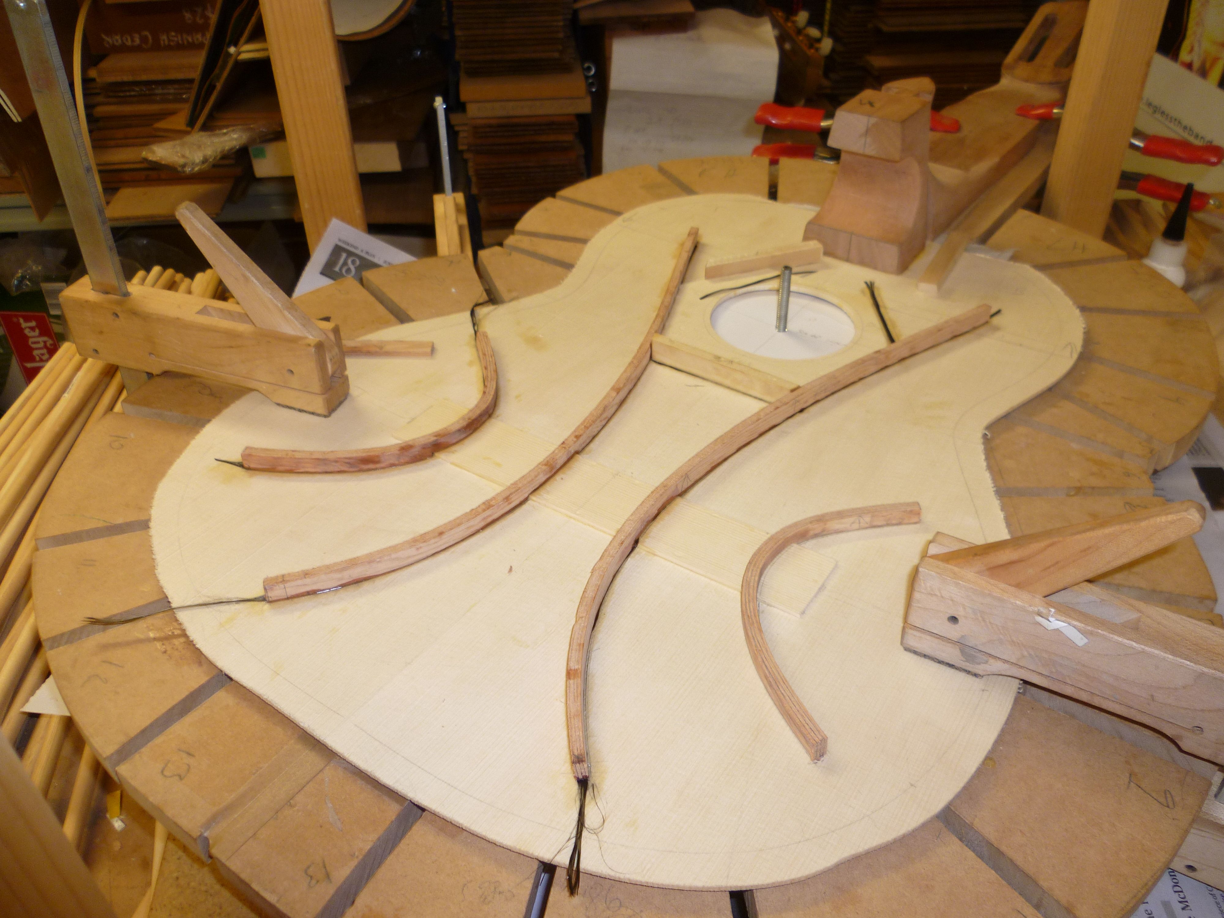

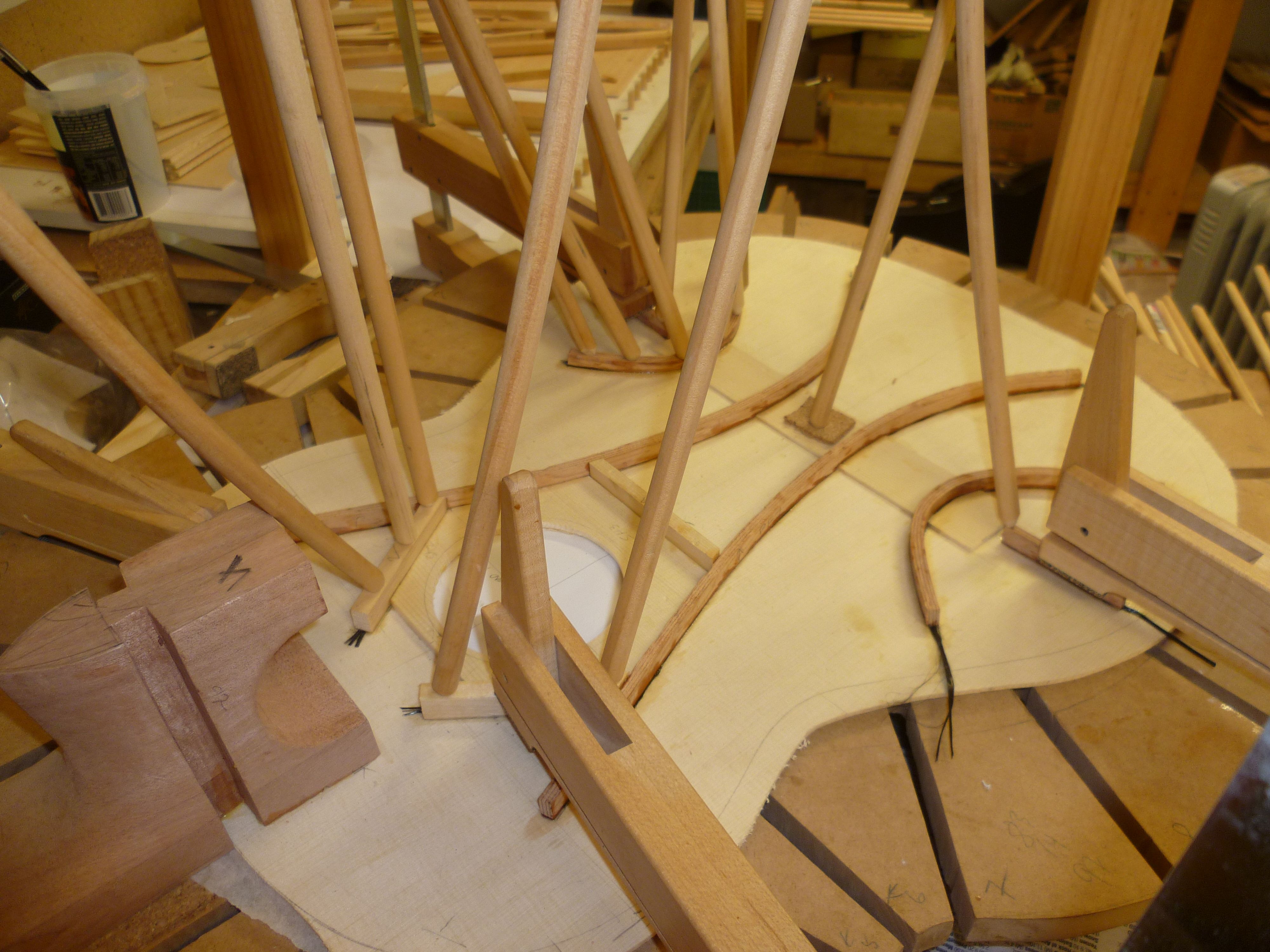

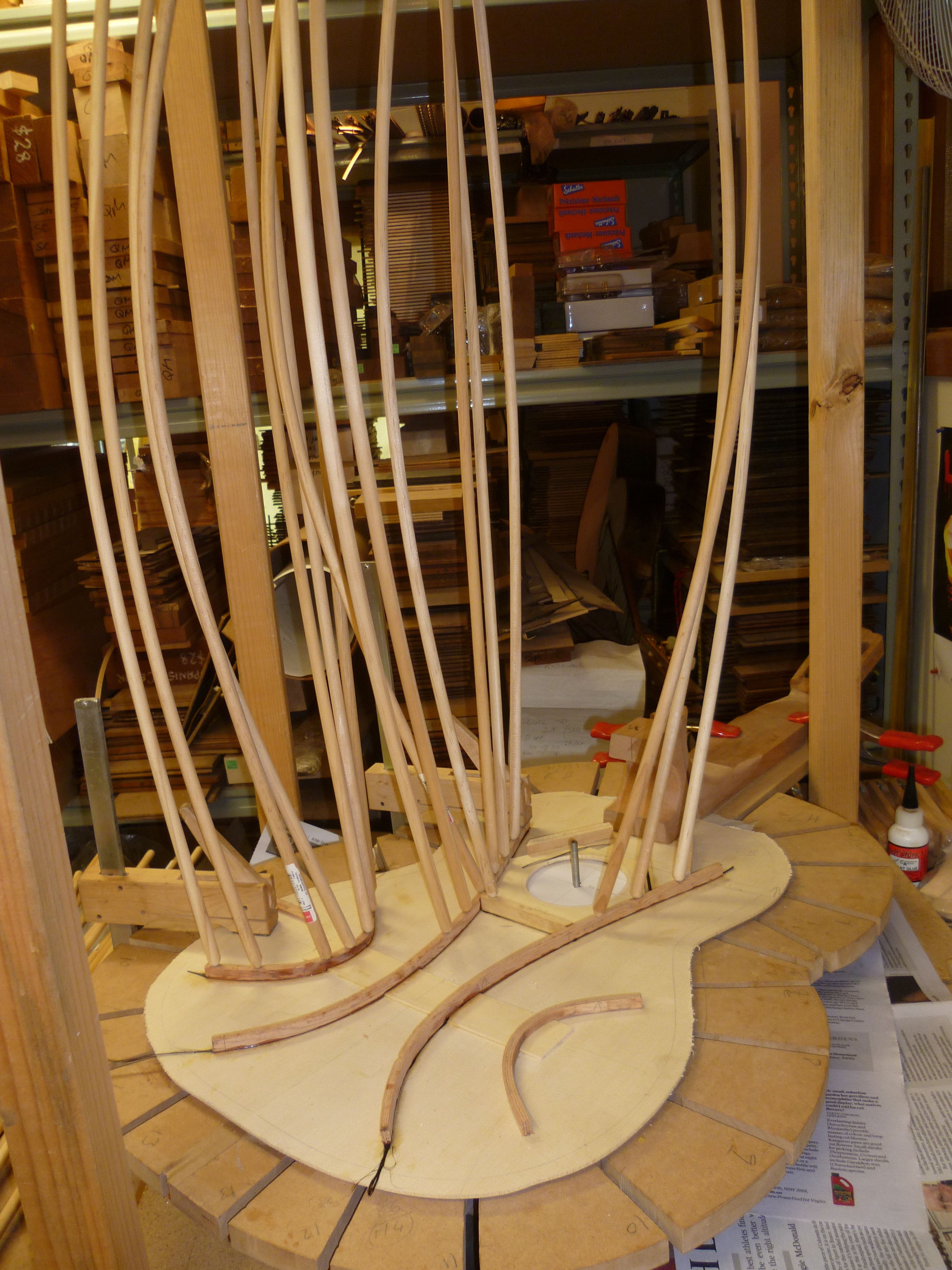

Have been busy in the workshop over the last few days getting my head around falcate bracing. After spome major disasters trying to bend and laminate up the braces using sitka spruce I was close to giving up. As luck would have it a large hunk of king billy pine turned up and after three attempts I managed to churn out some half decent braces. After a few test runs on a scrap of spruce I got going bracing up a classical Im building for a mates daughter. Construction is Spanish Method. Top is Engleman and neck is Queensland Maple. Back and sides will be Tasmanian Blackwood. I hum and harred over the bridge patch but the tradionalist in me won over and I stuck one on. With the patch on Im wondering if the short tertiary braces are of much use. Another concern was whether or not the doming around the bridge/lower bout would be maintained without shaping the braces. Ater gluing in the primary braces I was pleasantly surprised to find that the top was holding its doming nicely. Photos here are of the braces and CF tow going on.

That's looking good Martin, did you practice with the CF Tow ? looks very tidy for a first attempt, I hope mine ends up that good :) That Sitka spruce can be strange wood, my primary braces (Sitka ) bent cold with the nails in the board type jig.

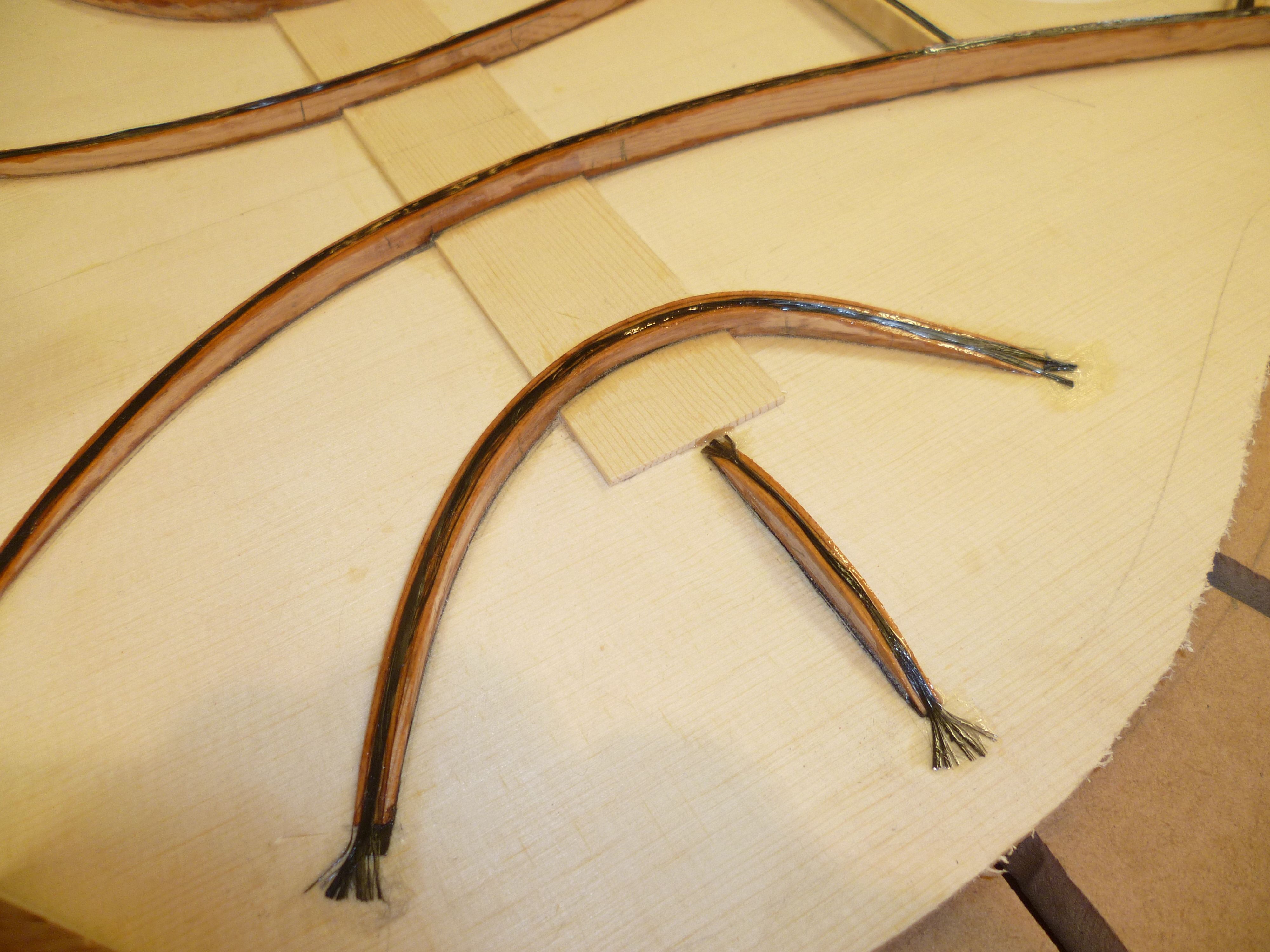

Yeah I did a couple of test glue ups with laminated braces and CF tow. The tow can be a pain in the arse as it will "float" if you have too much resin on the soundboard before applying the tow. The tricky part was running the tow over the bridge patch.....I should have tried pre-bending the tow at the point where it goes up over the patch and then started laying down the tow from each side of the patch out to the ends of the braces. I managed to bend up some passable primary braces sitka by cold bending but three attempts to heat bend some secondary braces was a total failure. The king billy really is lovely stuff to bend and you cant beat the colour of those braces!

But I am keen to get an idea of where your top comes out with whatever brace height and plate thickness combinations you end up with. Did you go through the process of testing your plate to determine thickness etc?
Also, have you just pressed these braces into your usual solera with the radius around the lower bout or a bigger radius?

No I havent gone through the plate testing as per Trevor/Gerards book. The build started as a fan braced hauser style classical and as I was about to start bracing up I decided to go with falcate bracing. Ill attempt a bit of testing after bracing up but I need to sort out software on the Mac.....there arent many decent cheap freq analyzers around for the Apples.
The braces were just pressed into the solera which has my standard scoop in the lower bout area. The top is however mounted on a cork mat with lower bout area removed ala Campiano so the lower bout doming is greater than on my previous builds.

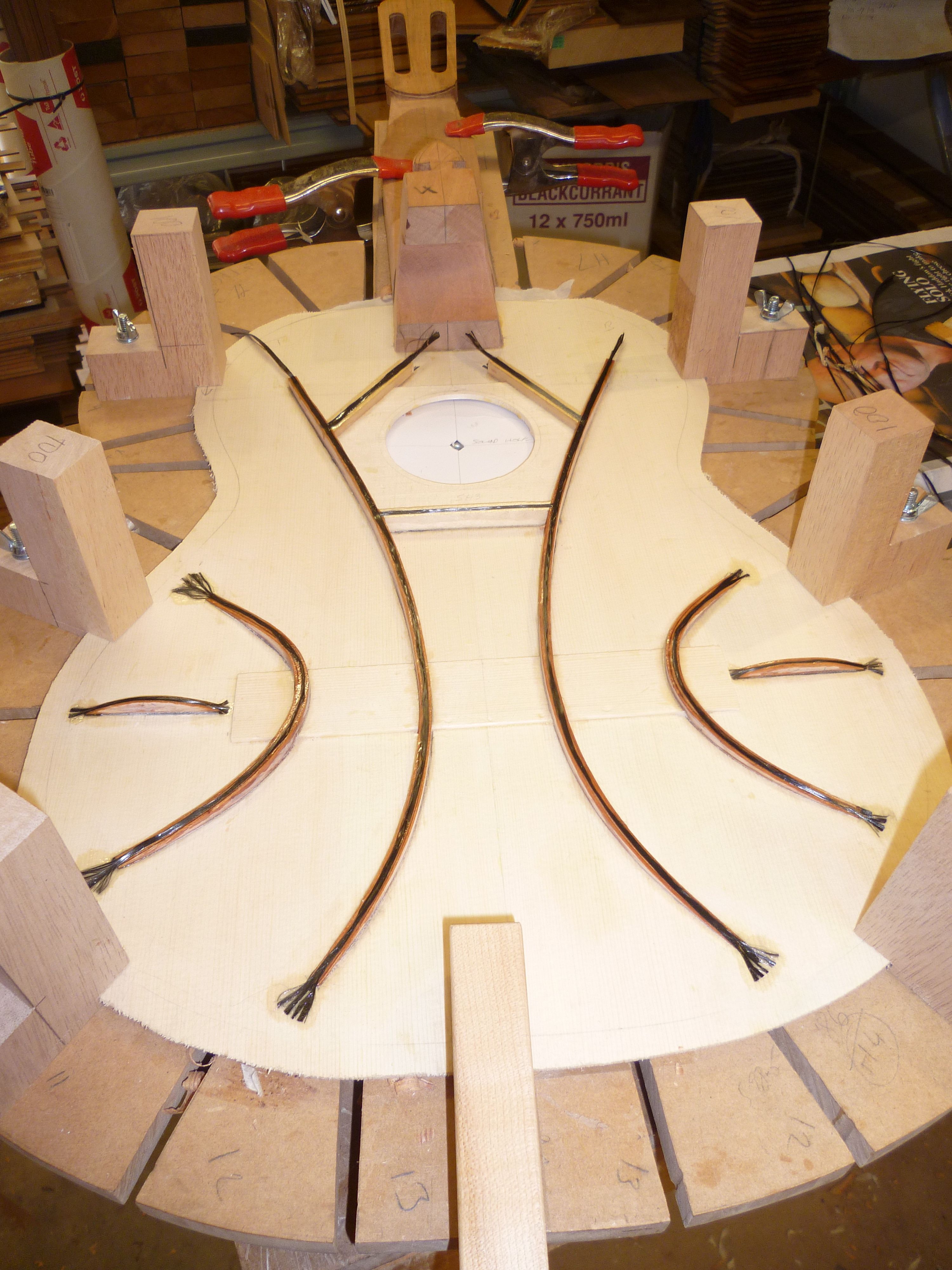

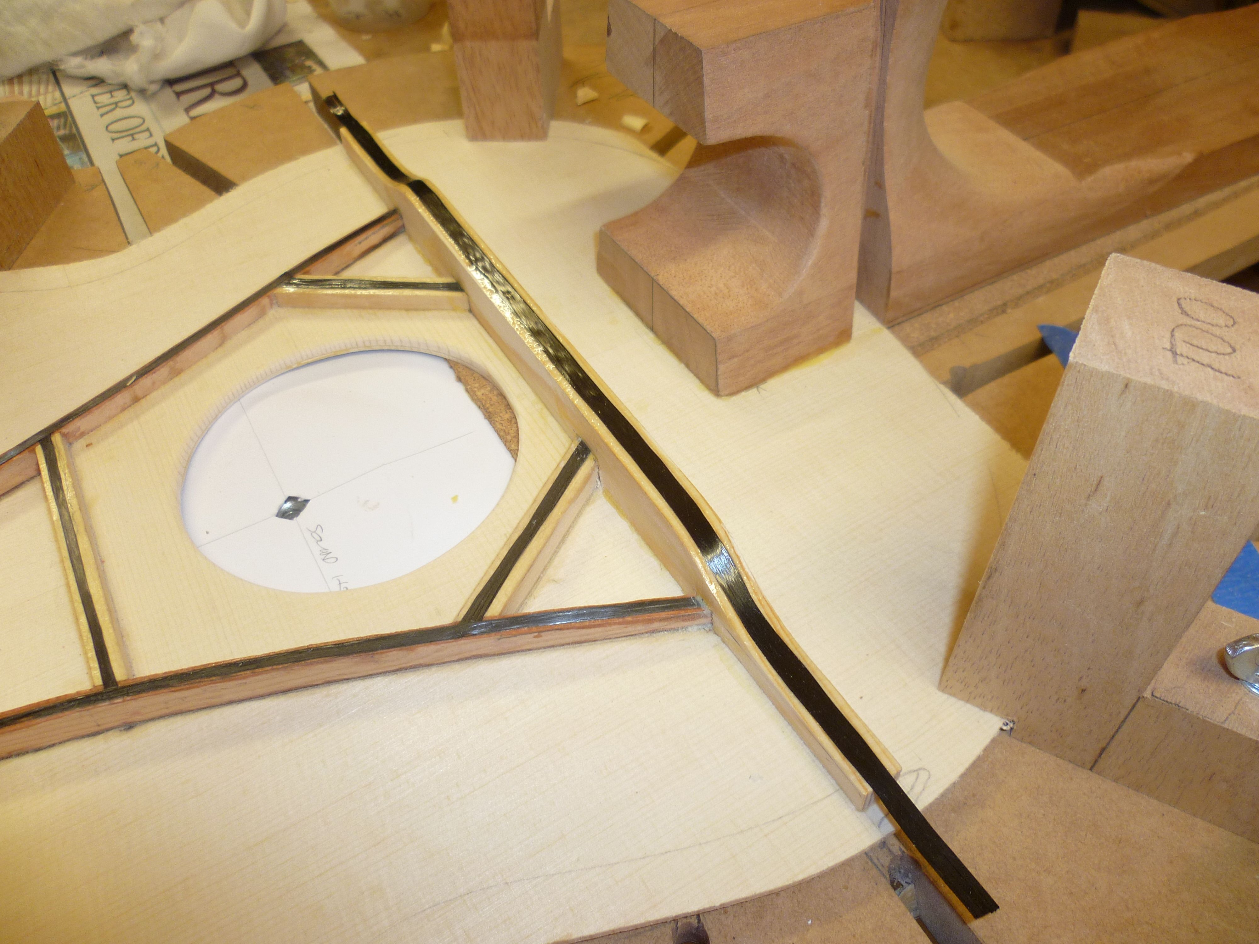

CF tow applied to top of braces after shaping same. In typical fashion halfway through the application of the tow one of my wife's bldi friends knocks on the door of the workshop and wants to waffle on......shes one of these nosey friends who keeps turning up unannounced and at the worst possible moment. :? Nothing worse when youre working with a resin pot life of 10 minutes.
Anyway thats all Im doing today...off to the pub to apply some beer. :gui

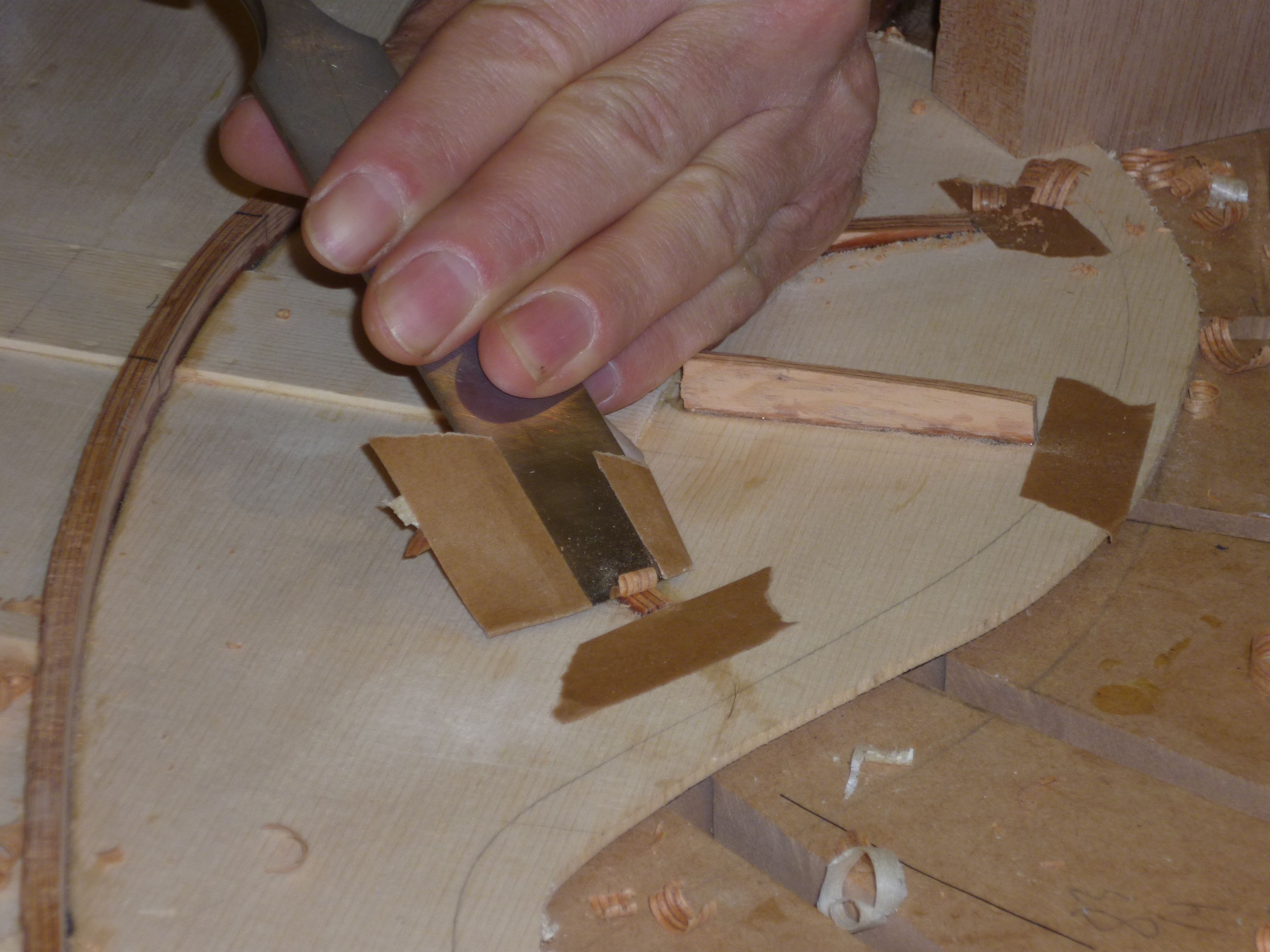

Post by Kim Strode » Tue Jul 17, 2012 3:54 pm
Hi Martin,
I'm a little confused, or maybe just missing something...or a little slow! Why have you glued CF to the top of the braces and then chiselled same off when dry?

Post by jeffhigh » Tue Jul 17, 2012 4:11 pm
The forum software seems to post pictures in reverse order.
The top of the braces is tapered from high at the bridge before the tow is put on top

Post by kiwigeo » Tue Jul 17, 2012 4:21 pm
The flippin' photos are in backwards sequence....
Everybody just turn your computer screens upside down and it'll all make sense :mrgreen:

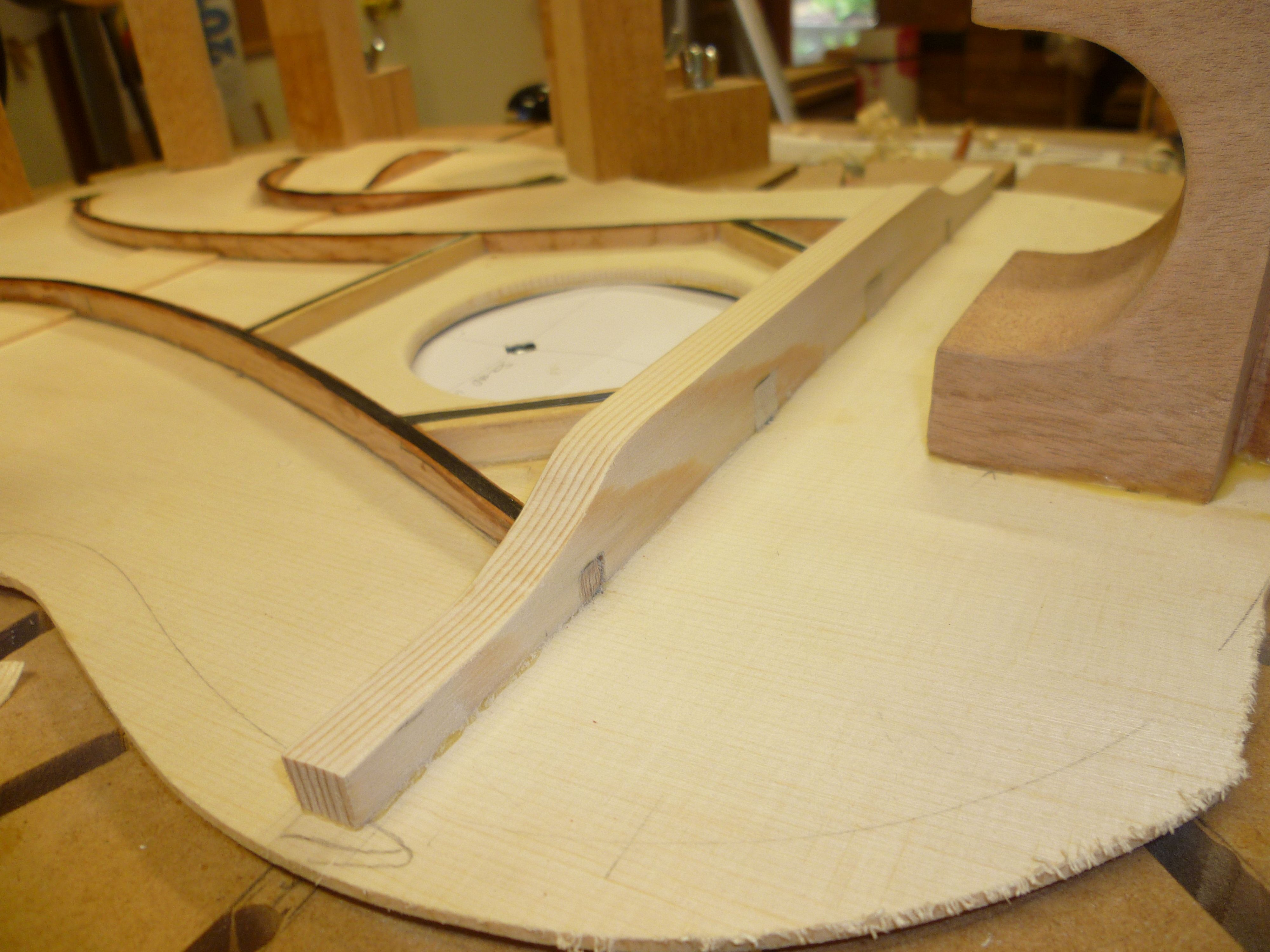

Post by kiwigeo » Thu Jul 19, 2012 3:53 pm

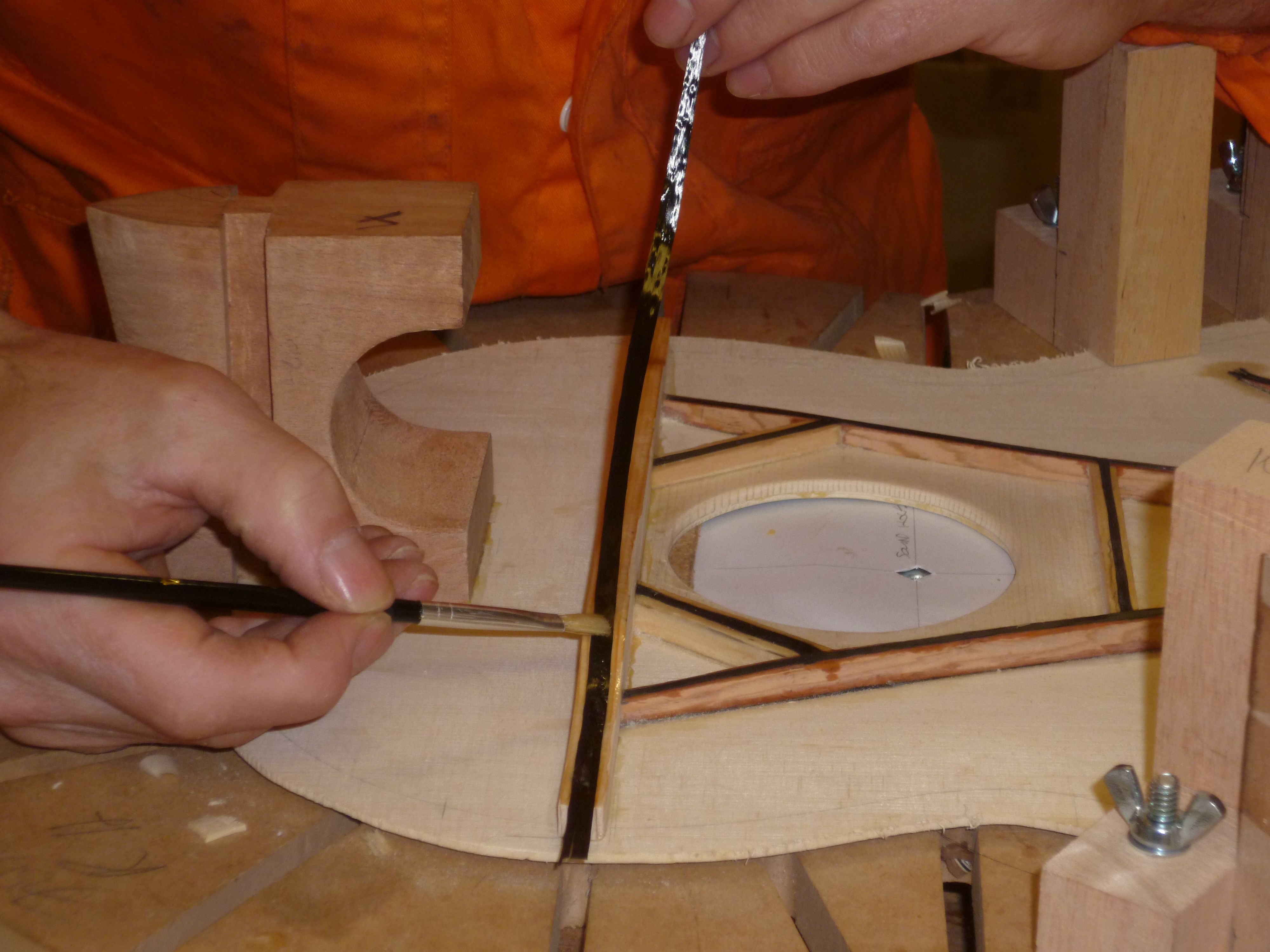

A few more pics. Fitted and glued in the UTB and applied tow to top of same. Cutting out slots to fit the ends of the braces was an absolute P in the proverbial. I have a few ideas for making this job a bit easier the next time around.

"Cutting out slots to fit the ends of the braces was an absolute P in the proverbial. I have a few ideas for making this job a bit easier the next time around."
Make sure you pass on the few idea's Martin, I will be going through this process myself soon, as soon as I get my new work bench built :mrgreen:

Not sure whether you've just not got round to it yet, but filling the gap between the neck block and the UTB is always a good idea.
Posts: 10864
Re: Falcate braced classical
Post by kiwigeo » Fri Aug 03, 2012 8:55 am
trevtheshed wrote:Martin,
I was going to ask a question on that one. Id normally run a cross grain ("paddle pop") patch between the UTB and the end of the neck block.
