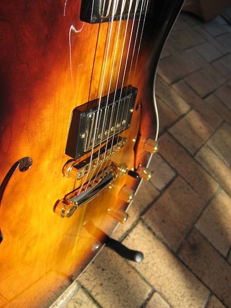

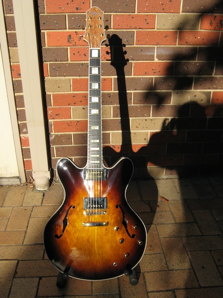

Post by rocket » Fri Aug 03, 2012 4:30 pm
Hey Paul my first full on leccy was a semi hollow build, the pups i pu in it were fro Stumac, Golden Age PAF's very reasonable price, very ballsy hardware check them out, they've got some very nice stuff at good prices,
