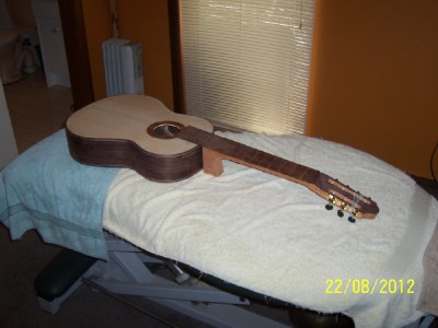

Post by jeffhigh » Wed Aug 22, 2012 11:28 am
EIR/ Englemann
Now ready for neck fitting

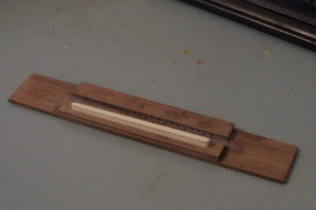

Post by jeffhigh » Wed Sep 05, 2012 11:23 am
Walnut bridge with 2 layers of CF
Currently at 12.5 grams(without saddle) and with a bit more sanding remaining
21 hole tieblock

Re: 7 String Falcate Flamenco
Post by Dominic » Wed Sep 05, 2012 11:26 am
Hey Jeff, is that american walnut or Qld? Pretty light so far. And longer saddle area. I like 21 holes, so much neater not having the string wrap over the tie block.
Look forward to the finished thing.
Post by jeffhigh » Wed Sep 05, 2012 11:31 am
American black walnut, cant stand the smell of the QLD plus it is quite heavy.
This stuff doesn't smell great but not totally disgusting.
Yes, longer saddle section for the 7 string but I only added 5mm to the total length

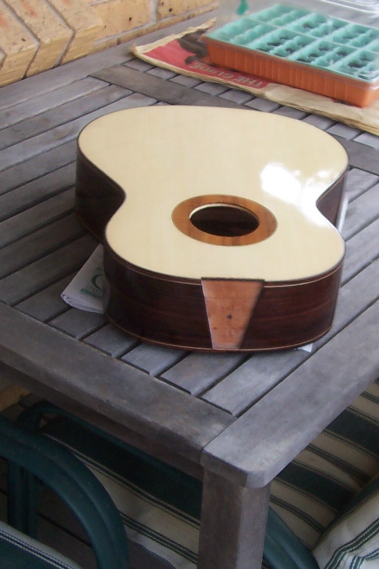

French polishing the body now

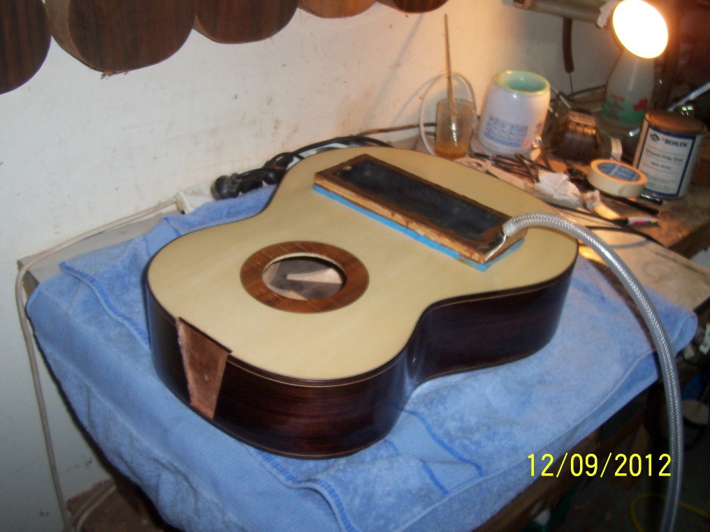

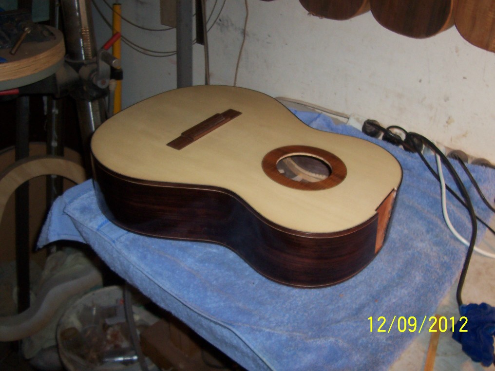

Post by jeffhigh » Wed Sep 12, 2012 8:32 am
Vacuum clamping the bridge with HHG
Post by jeffhigh » Wed Sep 12, 2012 8:33 am
40 minutes later, all cleaned up
Post by jeffhigh » Wed Sep 12, 2012 4:09 pm

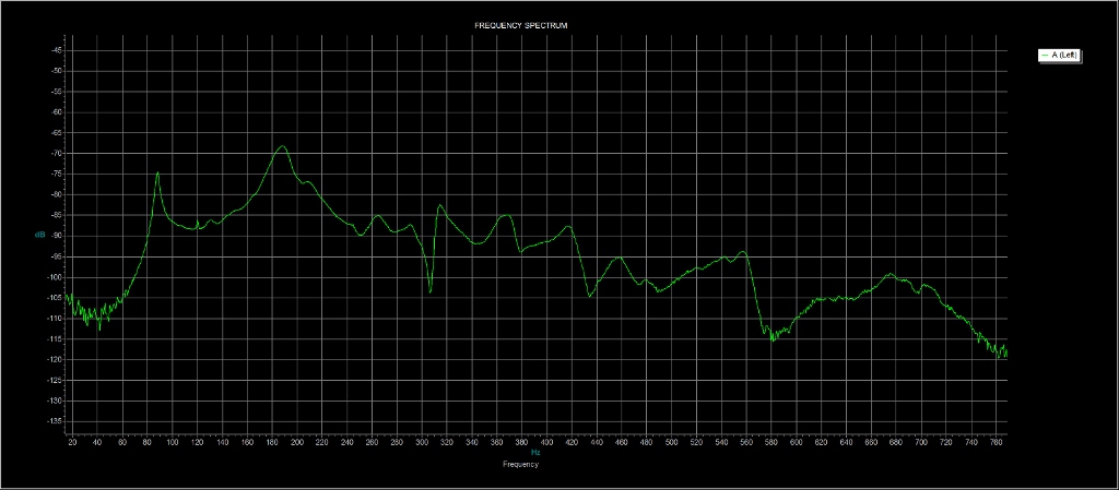

The T(1,1)2 went up around 10 HZ to 189 with the bridge glued on
I'm expecting that with the added mass of the saddle, golpeador, strings, neck (side mass) and the effect of bringing down the back frequency, I will approach 180

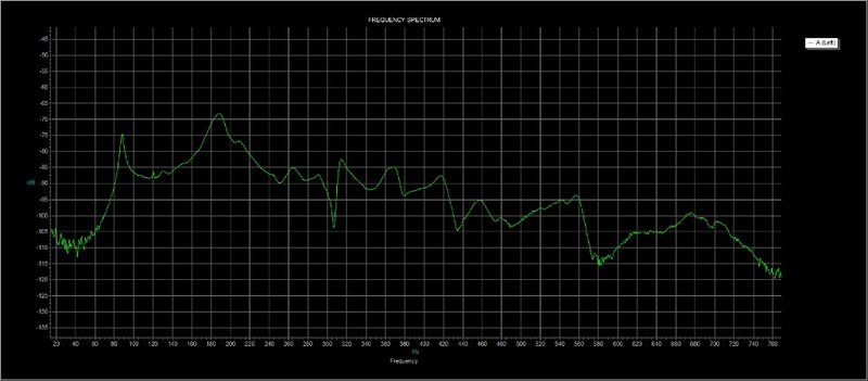

Any chance of a look at the full spectrum Jeff?
Post by jeffhigh » Wed Sep 12, 2012 6:00 pm
Ok lets try this
At the moment, its 87, 189, 265

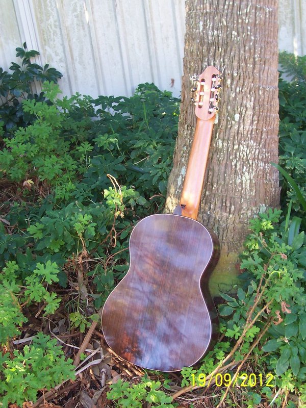

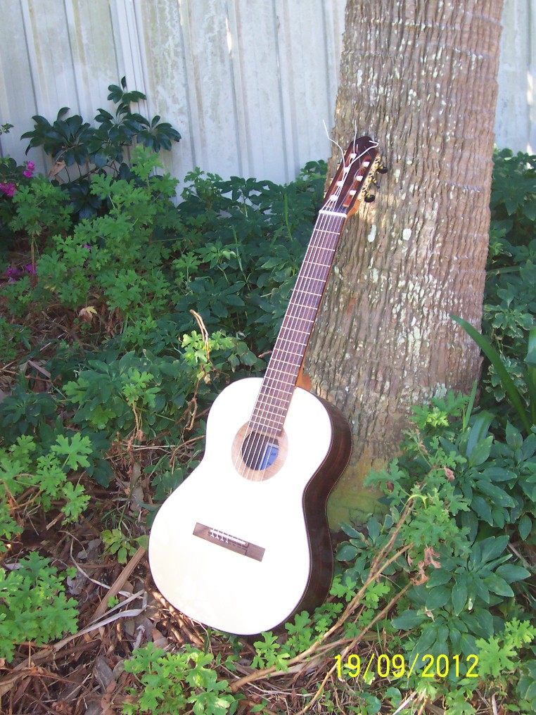

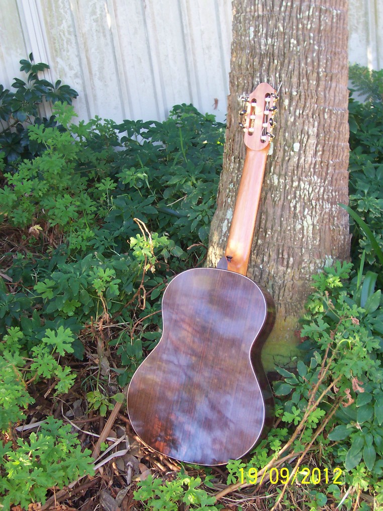

Post by jeffhigh » Wed Sep 19, 2012 3:27 pm
Strung up for setup and tuning of resonances.
Then probably bind the soundhole and a bit of finish touchup.
