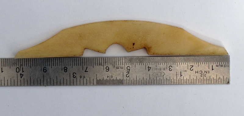

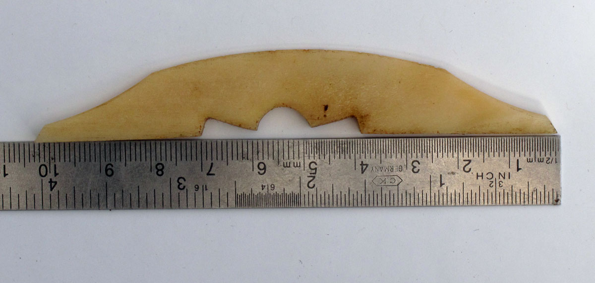

Bridge height is around 16mm. Here is a pic of it with a ruler for scale. Made of bone as is the tradition. The pic will give an idea of the fingerboard radius as well
g
g
Graham McDonald

Graham, thanks again. That bridge pic shows me a lot. And Ron Fernandez' site also helps.
Shane
Shane
