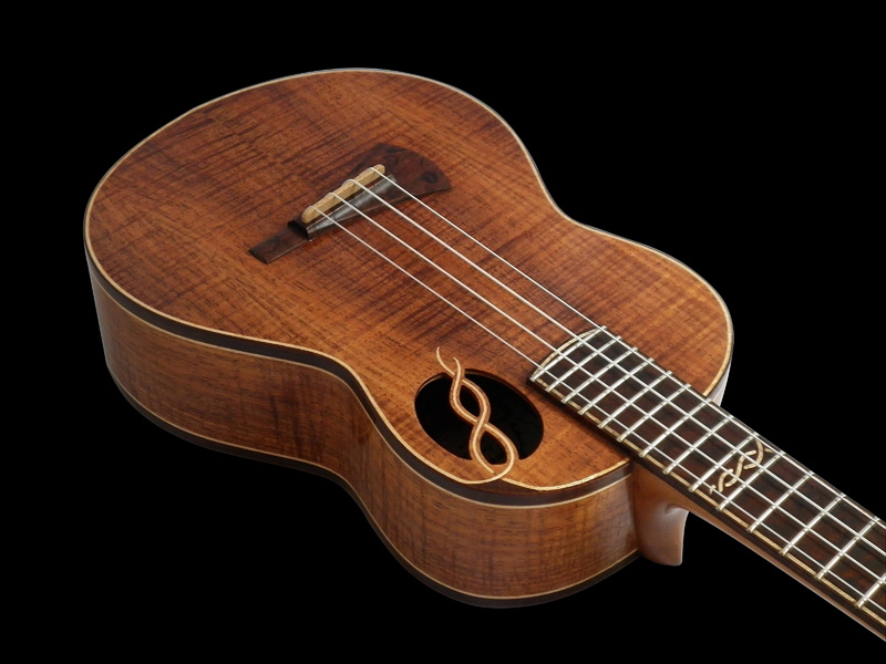

Here's a build I did using a 'styled' soundport Nick (the soundport 'build' starts on page 2), you don't have to get that carried away but it uses a reinforcement patch which, again, doesn't have to be like mine but a bit of crossgrain side material (side scrap) will bolster the hole/port up. I'd be tempted to leave some wood where the two arms of the "K" meet the vertical, similar to, but not copying :wink: , the Kellogs Special K logo

If you were particularly worried with the actual design you choose, you could consider CF (carbon fiber) to assist. Whether laminated in as a piece of sheet in the support sandwich, or with tow covering the backs of the letters to areas of support. The latter is what I did under the ribbon twist in this ukulele -
I ran some tow up both 'laces' of the twist and spread this out on both sides. End result was very stiff - you'd really have to go at it to break that now and it's all but invisible to keep the design looking 'delicate', rather than beefed up and bulky.
Careful planning should allow you to manage what you want to achieve.

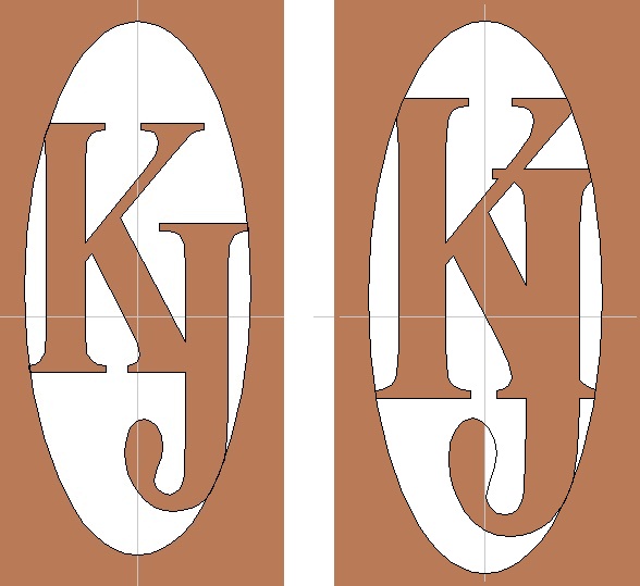

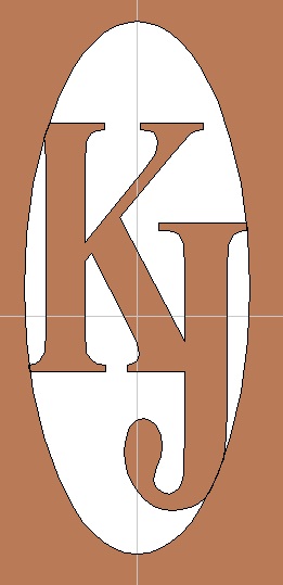

Whoops mis-understood, heres another go at it
Re: Soundhole Re-Inforcing
Post by simso » Tue Aug 28, 2012 12:22 am
Wouldnt let me re-edit my picture

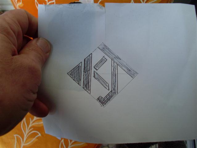

I was thinking something along these lines...
kj 006 (Small).JPG (66.96 KiB) Viewed 9246 times
The shaded areas would be cut out. This was a quick sketch, and I'd make it a bit more elegant, but looking at those samples you posted, I wonder what it'd look like if I cut out the letters thru the B/W/B veneers using a beveled cutter, exposing the BWB, and then put the Rimu plate on the back solid?
Then I could use a font that's a bit nicer looking.
I'd then use BWB purfling on the guitar, and that would sort of tie it together.
This is a thin(85mm +/-) guitar, and I've reduced the soundhole size, along with the size of the top braces, to try and beef up the bass response. Maybe leaving this area solid would help?
