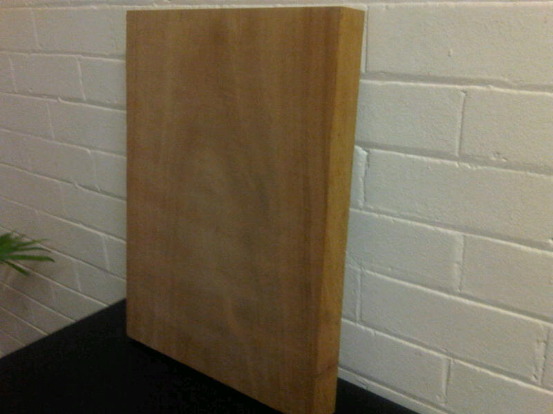

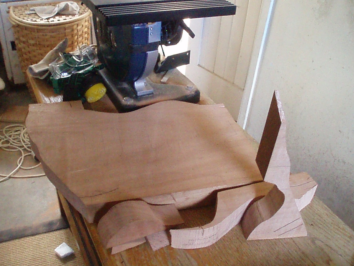

I purchased this piece of Queensland Maple from the esteemed gents at Gilet Guitars a few weeks back – Thanks so much for the advice you guys provided on staining this type of wood : ) No doubt I will be asking for more!! : )
Thought I would post a couple of pics…
This is my first attempt at building a guitar so I am going for a solid body bass...and this may take some time!!

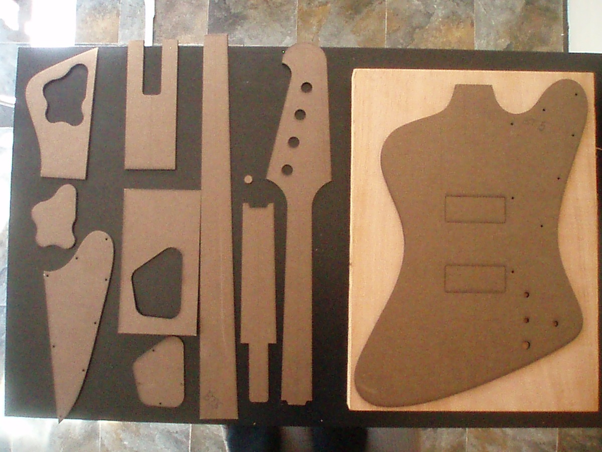

I purchased a Thunderbird template to get me going but hope to move onto my own designs after a few builds

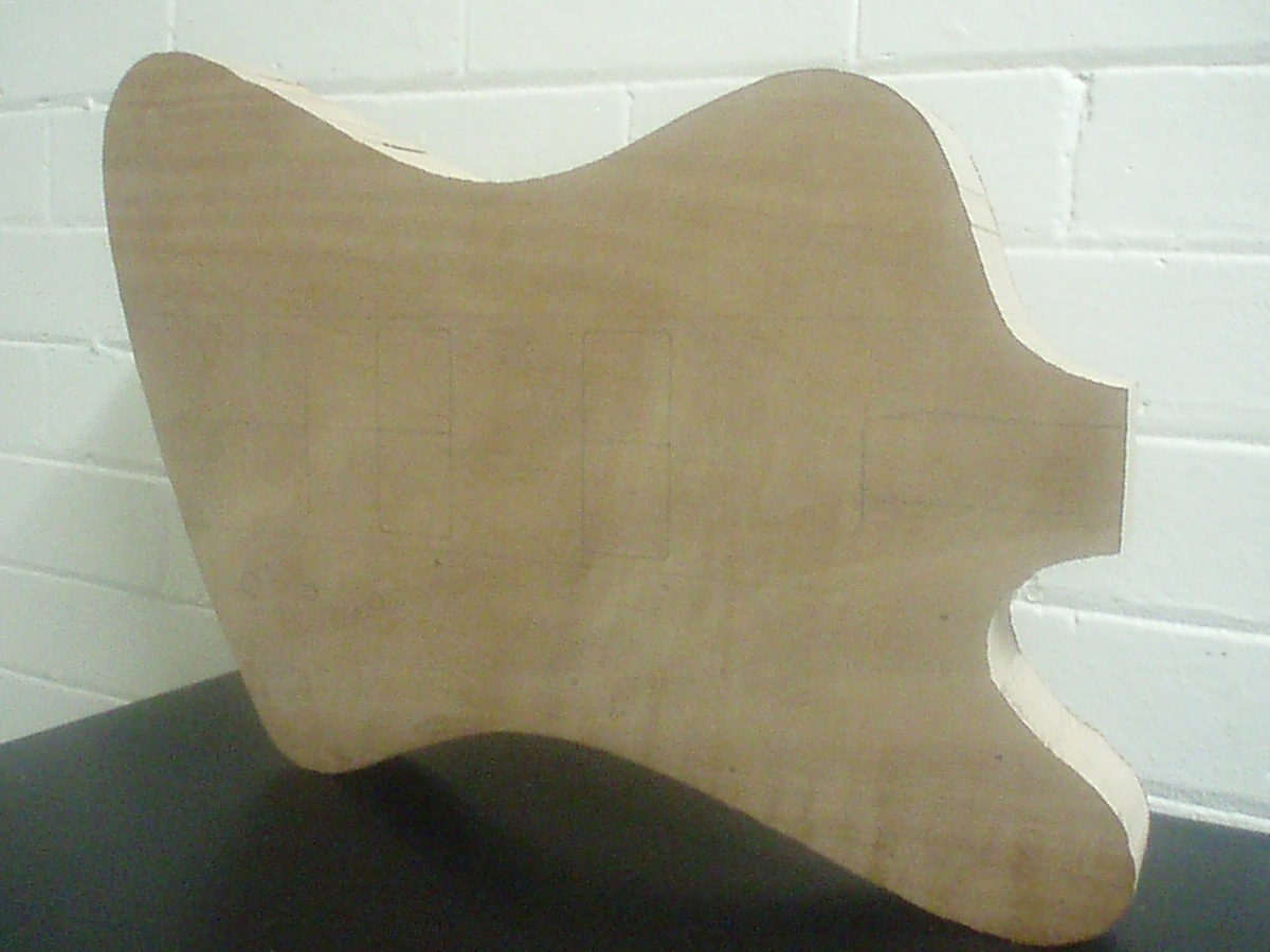

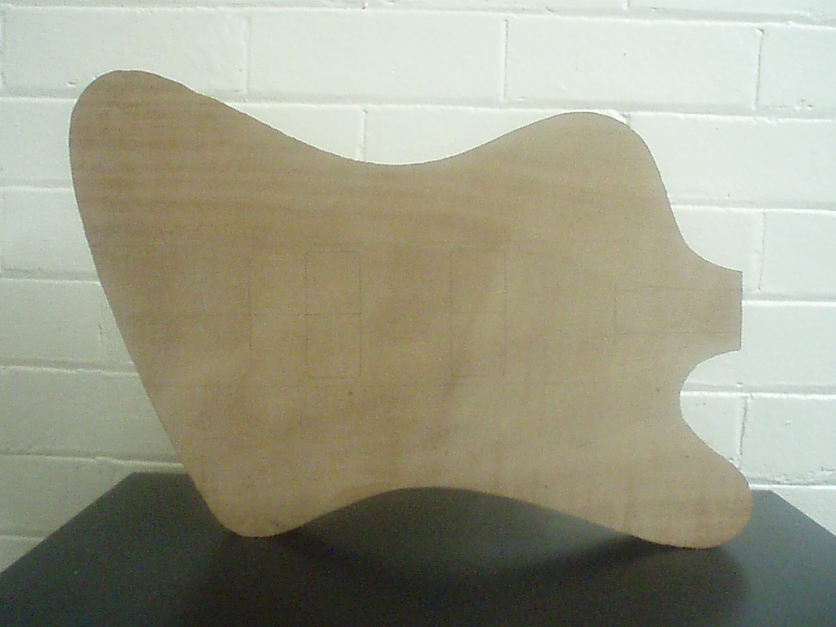

So far I have only completed the band sawing. The next step will be to rout the wings of the body to create the raised centre, which is the through neck on Gibson Thunderbirds. I'm using a bolt on neck but want to keep with the aesthetic of the raised centre : )

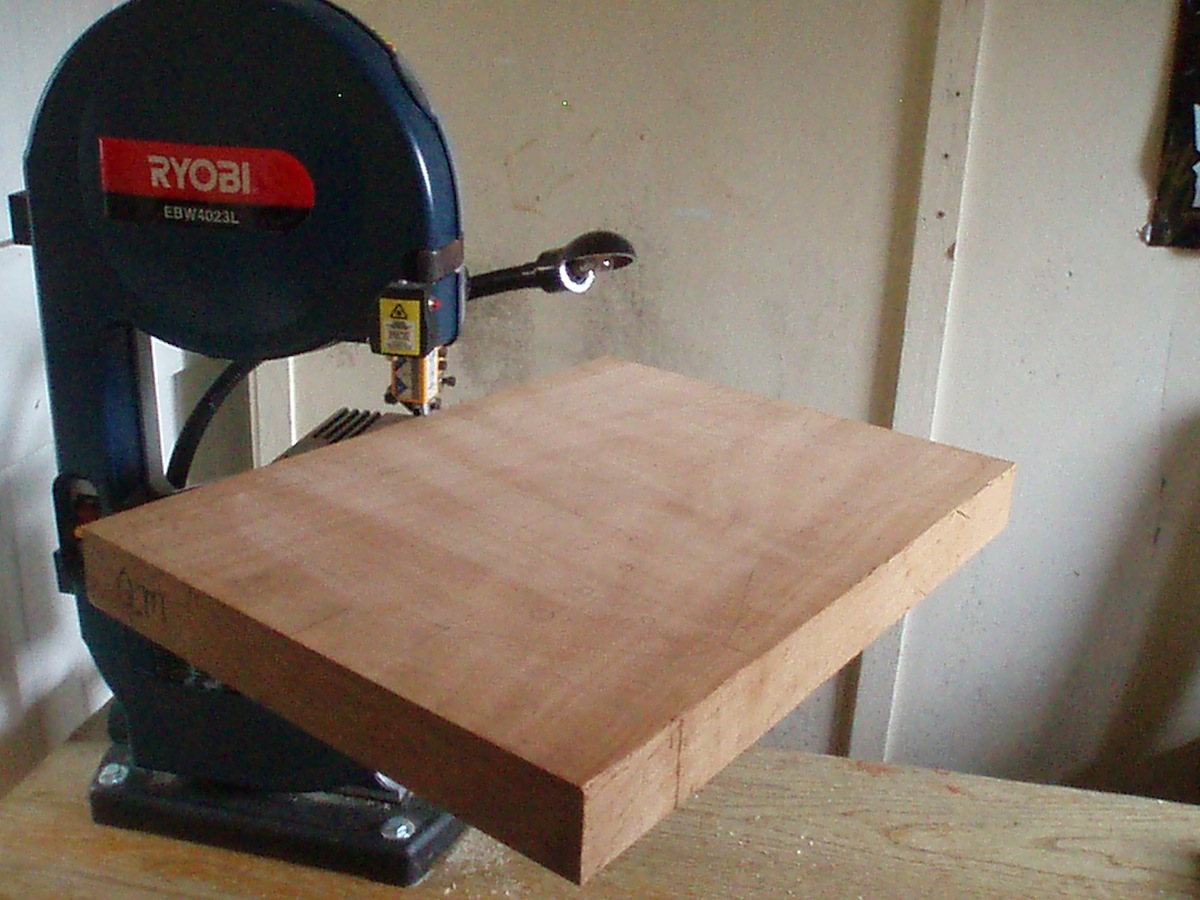

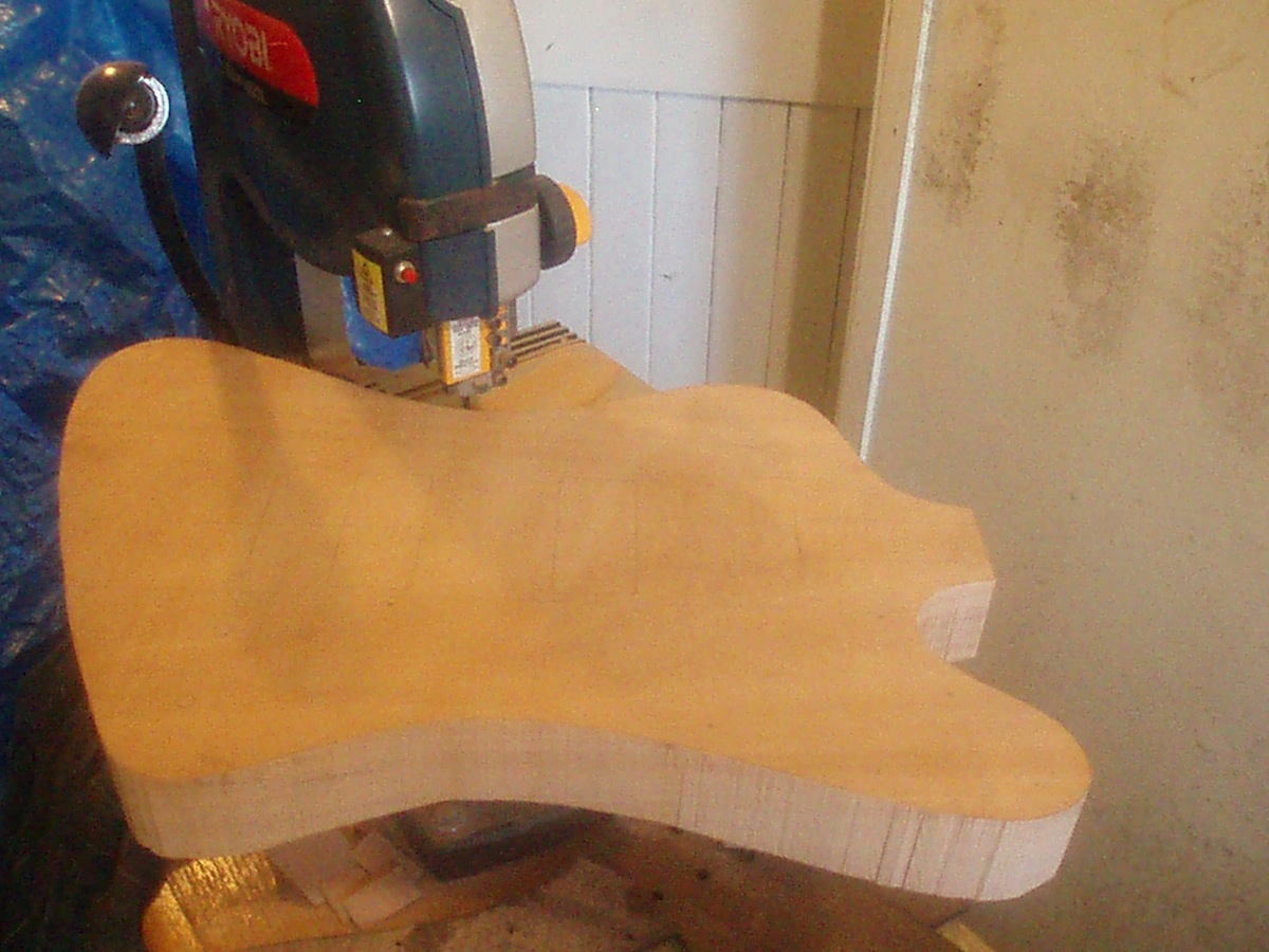

I initially had some bandsaw troubles but adjusted the blade guides so they were much closer to the blade and I slowed right down too and stopped pushing the job. After the body was roughly cut I went around the edges a few times again with the band saw and neatened it all up...Cheers!
- Queensland Maple - 520mm x 380mm x 60mm
- Queensland Maple2.jpg (54.03 KiB) Viewed 10075 times

Cool, I just pulled out a thunderbird bass project that had taken a back seat for a few years. I have a nice neck made but need to do the body. I have the same templates as you. But I am going to do a bolt on neck though. I have some nice EMG pickups for it. Better get going on mine as well then. Got my inspiration from SOAD.

Hey, the neck is laminate with maple and walnut and NGR. Plus carbon fibre deep into the neck. I have some mahogany blanks but I might make the centre section out of laminates as well then add the wings and make the step in the body.
Qld maple would be fine. You'll want to make another one anyway so don't worry too much about wood just yet. I like the electric guitars I have made so far but I always see a way to fine tune them a bit more on the next one to make my perfect axe. Like a carrot on a stick, never quite get there. But its fun anyway.
