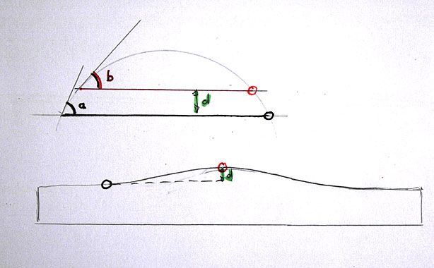

If I built a guitar with say, a 15' radius back, would the angle that the back meets the sides be the same all the way around.

If your sides are parallel (i.e the upper bout bend is parallel with the lower bout) & your back is a constant 15' radius then I would say it should be the same all the way around Liam. The back has such a "large" radius that any variation would only be in the range of minutes of a degree maybe even only seconds of a degree, hardly enough to concern any routing of binding channels e.t.c.

No. The angle that the tangent to the domed back makes with the sides will vary by ~1.5 degrees if the sides are more-or-less constant height all round (i.e. no big wedge).liam_fnq wrote:If I built a guitar with say, a 15' radius back, would the angle that the back meets the sides be the same all the way around.

OK. What you're looking for is the included angle between the slope of the tangent to the back dome and the sides at the edge. The largest variation in slope will be between where the guitar is narrowest and where it is widest (longest). The dome is 15 feet, which I'm calling 5m (or 5000mm). The half narrowest width is at the waist, call it 240/2 = 120mm. The half length is 500/2 = 250mm. The included angle between the tangent to the dome and the side is acos(120/5000) at the waist (88.62 degrees) and at the ends is acos(250/5000)= 87.13 degrees. Difference between the two is 88.62-87.13 = 1.49 degrees (i.e. ~1.5 degrees). If you can't immediately see the acos relationship, just sketch it out and you'll see it.

The "bulge" is a lot smaller than the curvature given by 5m radius; but, anyway, a Jim Williams type binding router (two point support) or a vertical axis binding machine (as per the book) will still work fine. A "rolling pin" binding router, if you have the nerve to use one, might be somewhat more problematic, but this will probably be the least of your problems if you're using one of those things.
Re: Maths boffin angle and curves stuff.
Think of it this way, the top which is a part of a sphere sits on sides that come up to meet it vertically all around so the sphere is not changed. Now the closer you get the centre of the top the closer to 90 degrees you will be the angle betwee the sides and the top. Alternatively, the further from the centre, the further you are travelling around the sphere which at some point goes from being horizontal to vertical. So the waist is likely to have the flatest angle. The head and tail blocks that are furthest away from the centre will have the steepest angles.

As it had been said before, when registering from the sides when cutting the binding rebate the difference of those angles does not matter at all. If you still want to know what angles these are, here my attempt to explain them:
In the following drawing the circle section represents the back doming, the red line the body width at the waist, and the black line the body width at the lower bout. Everything within the drawing NOT to scale!
As per the second figure which represents one of the sides, the widest (highest) point is at the waist (red), and the narrowest (lowest) is at the lower bout (black), the width difference is d (green).
Going back to the first figure you can see that the angle b between the horizontal line and the tangent of the doming (-circle) at the waist is slightly different from angle a between the horizontal line and the tangent of the doming (-circle) at the lower bout. This is why one should not register from the domed back (e.g. its tangent) when cutting the binding rebate.
