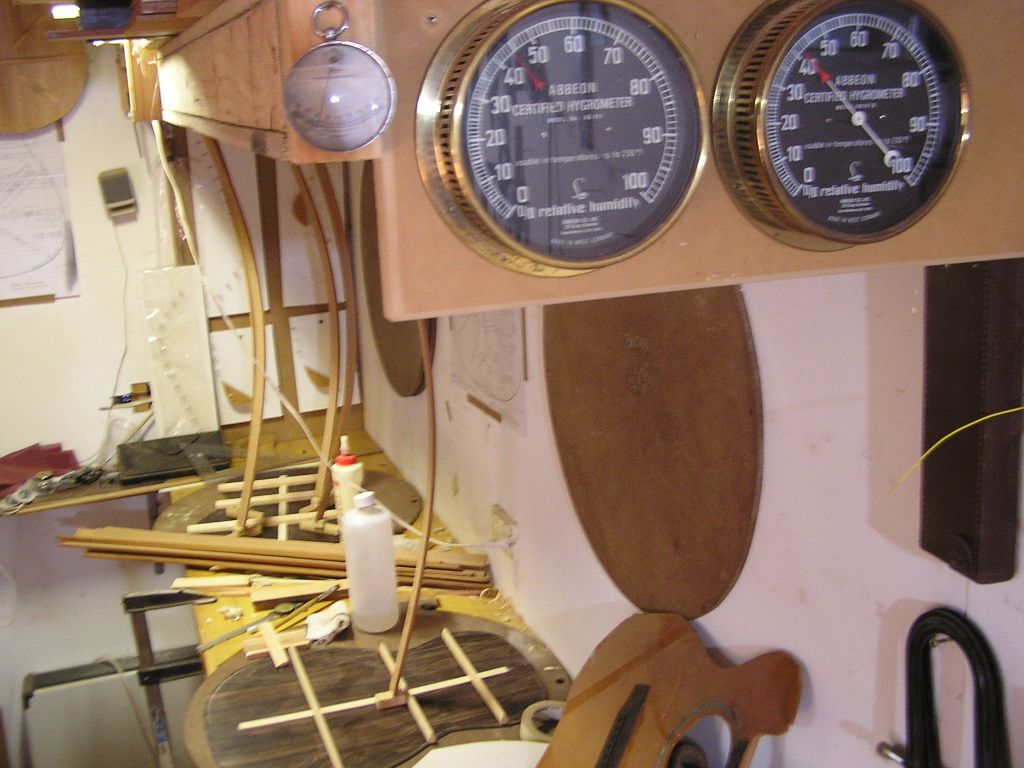

Hi Steve....Sometimes I am manual and sometimes I leave it to the controller on the machine....If I am in the dry room I mostly monitor it myself. The best hygrometer I have is a very old British made vintage one that I would suggest is from around the war years or just after. The brand on it is the word "ON" overlaid on a picture of a dart of the throwing type. It just says Humidity Per Cent and Made in England but its a beauty with a beautiful mechanism that reacts quickly and is accurate. Oh...and by the way I love old instruments with dials so it doubles as a working collection.simso wrote:Looks good john.woodrat wrote:Hi Steve, I have a dry room approx 6m x 1.8 that I have a domestic dehumidifier in to regulate the RH.
So you have gauges in to measure and manually (by hand) turn on a dehumidifer. I this correct.

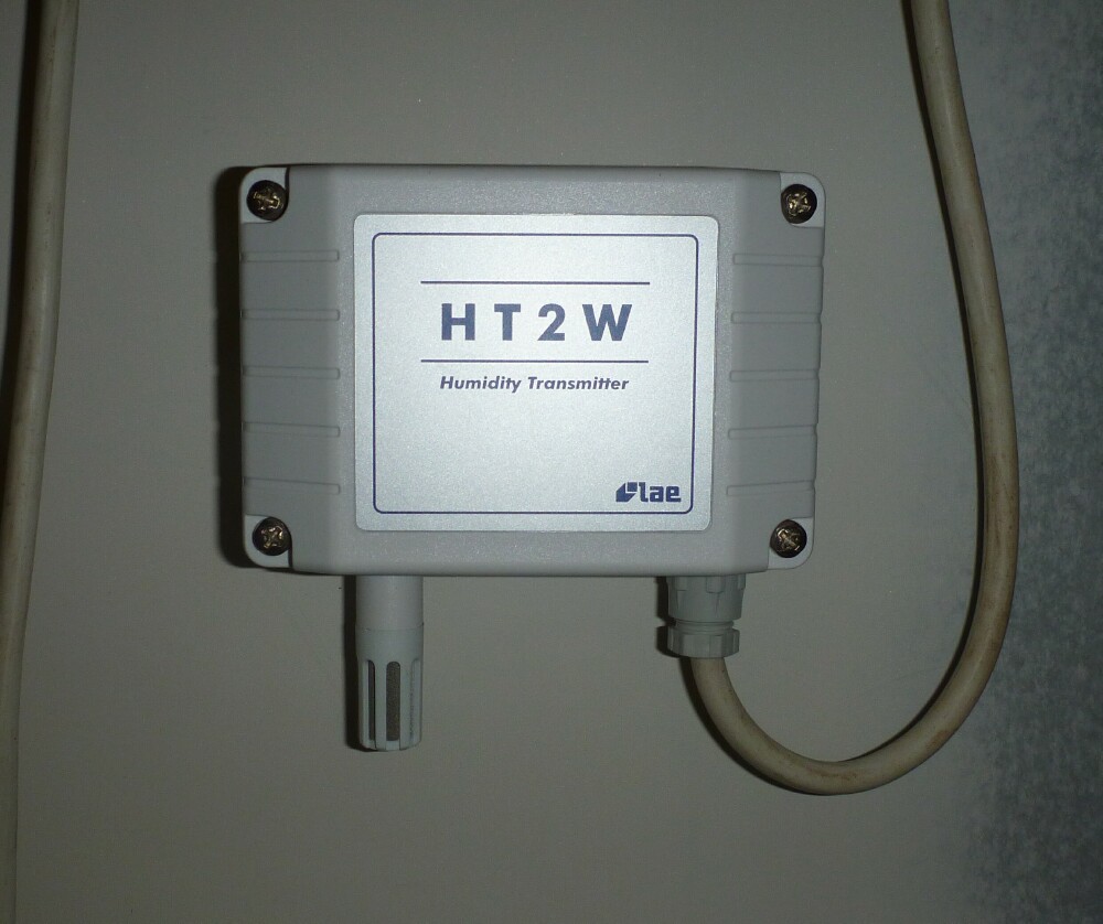

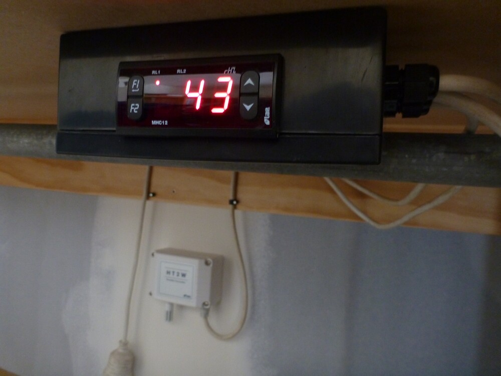

A couple of pics of my bodged programmable humidity controller:Tim Mullin wrote:I ended up building an electronic humidity controller, using parts sourced from http://www.csinz.com. For about NZ$250, they supplied me with an LAE programmable humidity controller (panel mount with LED display), a humidity sensor, and a tiny 240VAC-12VAC transformer ... A little bit of solder and it was assembled. The device is now plugged between a power point and the dehumidifier, with the sensor mounted on the wall.

I should also mention, with respect to the hygrometers in my workshop - this machines readout is the lowest of several at 32%. It sits on the ground and obviously senses at the source of the conditioned air. The next hygrometer is digital and at bench/working height - this reads 39%. The next is a German brass and glass unit, sitting just over head height. It reads the highest at 47%.
Between all of them, I believe it to be in the zone I want. Be nice to have a fully calibrated unit to genuinely check which unit is the closest to an accurate reading though.
