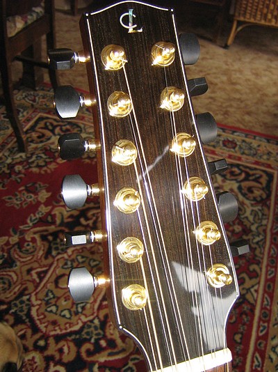

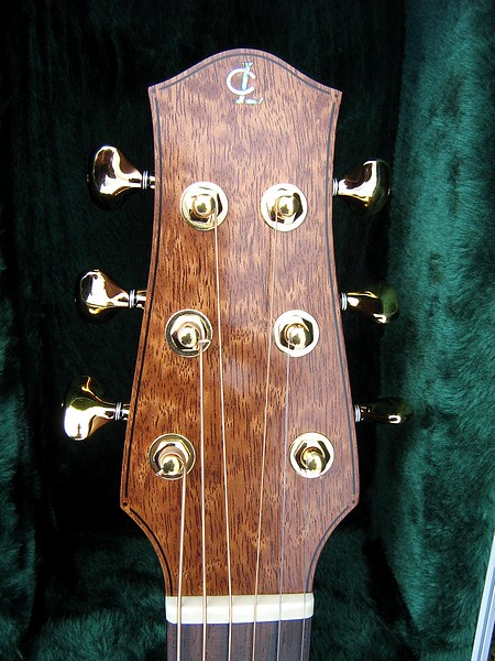

I like the Gotoh 510's with metal buttons . Enough weight to make it almost "neck heavy ".I've also fitted wooden buttons on them but changed back to metal . Seems the extra weight really does make a big difference at the anchoring point.
I'm also a fan of having the tuners pretty much in line with the strings . My reasoning is that this gives the string more flexiblity as the string's tensions can easily pass to and fro over the nut. Also more accurate tuning as the string doesn't get caught up at the nut ( the speaking and non speaking length can equalize ).
I've done the same with 12 strings although had to go with ebony buttons as 12 metal ones just made the guitar Too neck heavy.
The strings are never going to be in complete alignment because of the headstock angle ( 14 degree in my case ) but I do think having the tuners pretty much in line does make quite a difference
