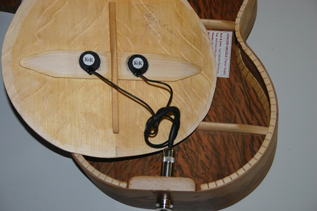

This ‘buyer beware’ scenario relates to the under-performance of a piezo K&K Pickup. A recent commission was for a ukulele with a pickup. The build is a Tiger Myrtle Concert body; 2mm Bearclaw Sitka Spruce top; a tenor-scale neck (i.e. slightly wider fret spacing) and Aquila Low-G concert strings (slightly more tension & brightness) fitted to a WA Jarrah bridge.
I placed an online order for a K&K Twin Spot Internal from Paul Stokes’s sonicwavefactory on eBay. As he was out of stock of the Twin Spots he offered me a substitute K&K Pure Maccaferri for the same price, stating in his email that “the tech specs are the same for both pickups”. In hindsight this hasn’t been the case*. Prior to gluing the pads to the bridge plate I tested each one by plugging them into a small practice amp and tapped each of the metal plates to get an audible signal at mid-volume, so I assumed everything would go according to plan.

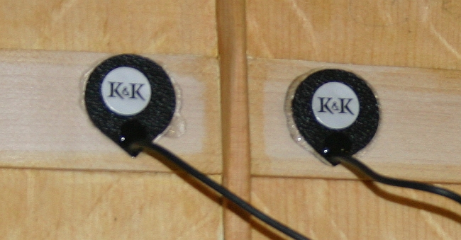

Here are a couple of pics of the pickup installation. I used CA Gel as supplied and followed the instructions to ‘apply a liberal amount of the gel’ to ensure a good bond (note the squeeze-out of gel). The bridge patch is a thin slice of rock maple, and the two pads were positioned to lie between the G & C strings, and the E & A strings … i.e. fairly symmetrical under the bridge (see image in instructions for installation on a 6-string acoustic).
Close Up of Pads: When the uke was finished and plugged into the same practice amp – nothing!! Not even the slightest sound with all controls cranked to the max. I tried testing on Pete Young’s guitar amp but still no joy.

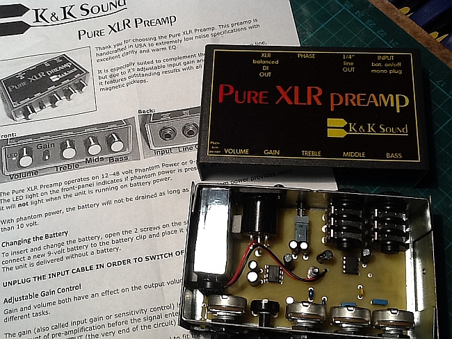

The Pure XLR Preamp has improved signal levels just slightly; at least now I have a signal out of the practice amp which is clear and audible, though the gain and volume controls on both the preamp and practice amp have to be wound almost flat out. Not ideal. I tried the uke/preamp combo last night on a mate’s guitar amp with very similar results. At about $300 out-of-pocket I’m chalking this build down to experience; on the up side I’m the proud owner of a new K&K Pure XLR Preamp and the uke itself sounds pretty good unplugged – it’ll be a keeper.

Hi John, Just looking at your second photo, Is that CA around the area where the wires enter the plastic casing ? and if so,was that put there by you or the manufacturer ?
I only ask because I have been making my own K&K type piezo pups and enclosing the disk in varying density wood,on one occasion I did drop some CA onto the area where the wires exit and ended up with the CA getting into the disk which gave me symptons very similar to what you are describing.

Hi Tod
The CA glue you see in the pics is all from squeeze-out that I applied liberally as per instructions, though I may have gone overboard given this is my first experience with installing transducers. The two pads and associated leads were completely encapsulated in black plastic when they came out of the box (except of course for the brass or copper (?) pads to which I applied CA).
Thanks for thefeedback!

John, I just had a look at the K&K website. The fitting instructions for the two spot internal on a uke appears to show the transducers positioned inline with the outer strings, but well forward of the bridge plate.
http://www.kksound.com/findpickup/ukulele.html
They say to fit them with your fingers through the soundhole using the double sided tape provided. As I said, my own experience with K&K's is restricted to guitar so perhaps there is more to it but I suspect the fact K&K appears to have them position directly to the soundboard in front of the BP could be the reason you have had such grief. Have you checked some of the uke forums to see what others have had to say??

I've fitted a number of twin-spots to mandolins and have had good results placing the pickups under the feet of the bridge.

I've installed lots of K&Ks in both classical and steel string guitars, either the 3 unit mini westerns or the 4 unit mini classics. There's a piece on how I do the installs and some of the (minor) issues you can run into here. The units for the two spot look exactly the same as those used in the mini westerns and mini classics, though I have never used the two spot. I'm inclined to agree with Kim, that you were offered the wrong pick-up. The minis have a huge output and will drive the line level input of a standard hi-fi amp (10k input impedance) quite easily, so with the right pick-ups I find it hard to imagine an install so bad that you would loose nearly all the signal. On guitars, a preamp is really only necessary for impedance matching and EQ, rather than gain and I don't see any reason why you should be short of signal on a uke. So I would suggest getting either the two spot (or the classic with 4 pads and then buy an extra jack socket so you can make 2 two spots, whichever works out cheaper) and installing them in your uke. The install should go fine using the swivel head tool shown in the other thread if you can get the macca ones out reasonably cleanly. I'd be looking at making a custom chisel/mini burger flipper to do the extract (or just leave them in and put the two spots forward of the bridge plate).

G'day John.
I've just installed a twin-spot in a Tenor Ukulele too.
I used the supplied tape on this occasion so as to be able to adjust them more easily should it be required. I also installed them as I have on larger instruments, directly under the saddle. I had not seen the photo Kim posted of the suggested forward position.
Now this brings to mind two questions - Why does their suggested positioning change for a ukulele? I would have thought the best and most direct response would have been under the saddle, but it appears not to be the case? Second, why do they supply only the tape for the twin-spot, not gel glue as with other pickups?
They claim the gel glue to be far superior in vibration transfer, than the tape on the pure mini literature. Yet on the twin spot, they suggest the tape is completely transparent of any influence on signal... ?? They can't both be correct.
In any case, this instrument is incomplete. I have installed the pickup, but the instrument is about to undergo it's finishing regime. I'll be able to move mine if I am unhappy with the performance upon completion. On the other hand, if I'm happy with the signal where they are, I probably won't remove them to use glue instead.
Finally, as the glue supplied with say, their pure mini, is "KRAZY" super glue in gel form, I'd say any gel cyanoacrylate will work just as effectively! Hardly 'top of the range' super glue that...

I'm surprised that you got such little change following use of the pre-amp. Just checking that you got inside the preamp and adjusted the 'hotness' of the input, as I am assuming that this feature exists on this unit.

Jeremy, just my speculation but searching around to help John out I came across other installs of the twin spot, I think a mando and an oud which had the buds fitted directly to the soundboard. Maybe a guitar has the punch to drive three buds from the BP, but perhaps instruments with less drive work better with just 2 buds direct to the board and whilst K&K do suggest that CA is superior to tape when fixing to the BP, perhaps it would make things too hot and brash when fixing the buds directly to the soundboard so the preference becomes tape in order to take the edge off them?J.F. Custom wrote:G'day John.
As I say its just speculation but I do know that quite a few people over the years have had problems with their guitars sounding brash and boomey when they had assumed the K&K pure and western standards, which have large transducers, would work better than the pure and western minis, its a mistake they only make once because these things are quite sensitive and little changes can make a huge difference.
Re: A K&K Pickup on a Ukulele Story
To me it looks as they are talking (or thinking) of fitting the pickups to a finished instrument. They write:J.F. Custom wrote: Now this brings to mind two questions - Why does their suggested positioning change for a ukulele?
In a ukulele I can not reach with my fingers through the soundhole down to the bridge position.
