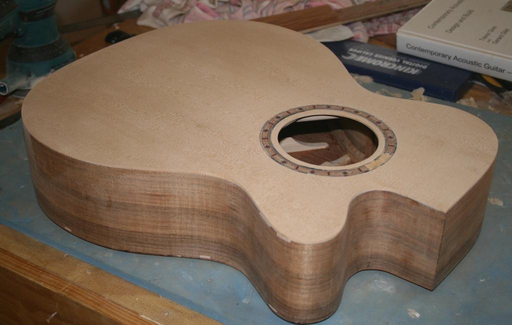

Completed box

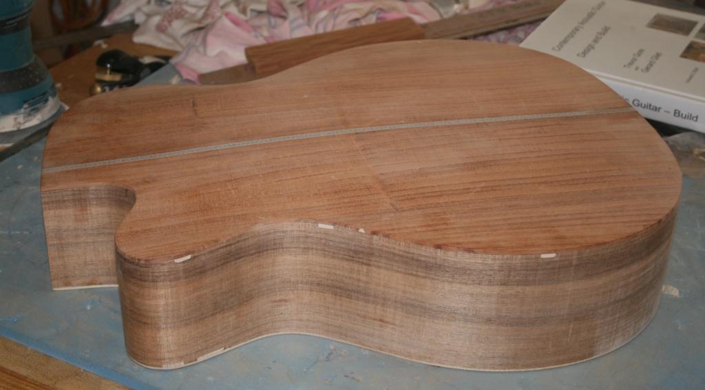

Back and sides of completed box

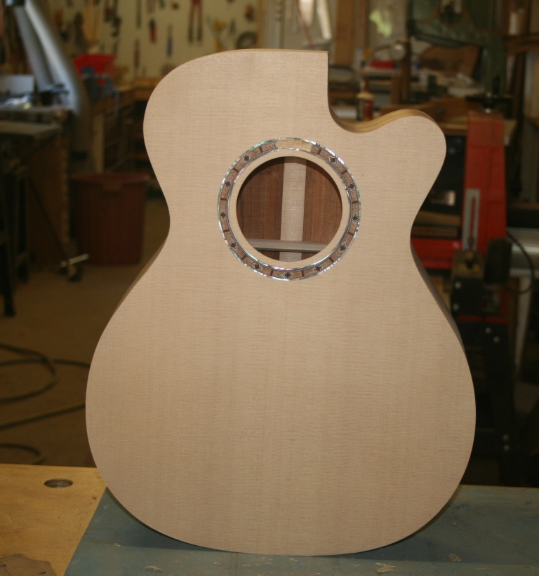

Top of completed box

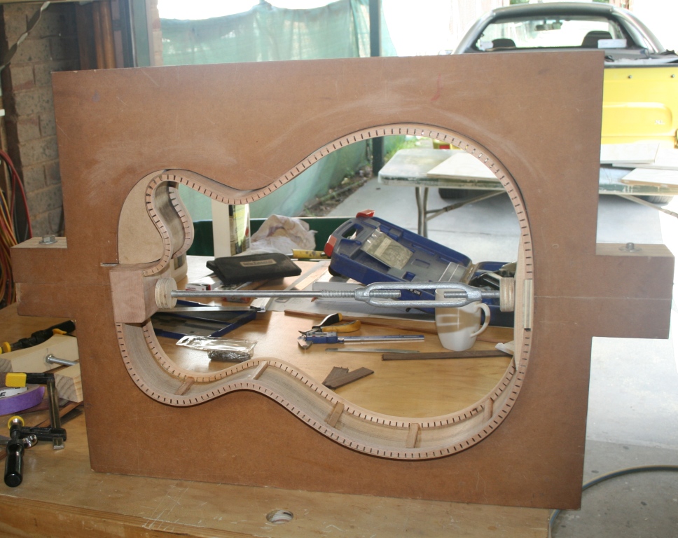

In the mould - few heat marks on the inside of cutaway area but fine on the outside

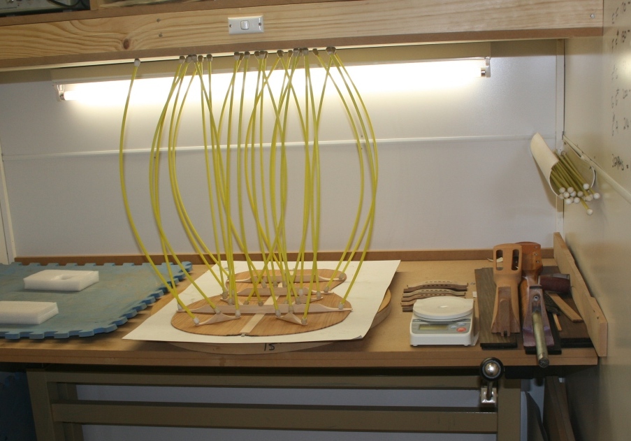

Live back on go-bar deck in humidity room
