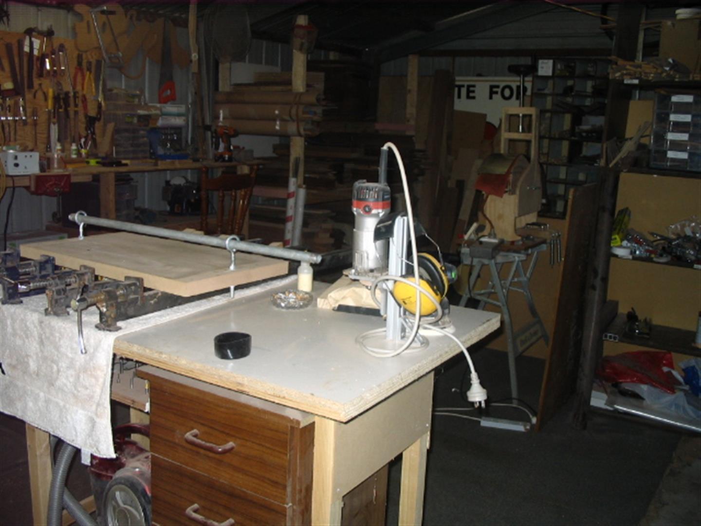

Here's what it looks like in our shed Alan. I've since replaced the table top with marble which is nice and smooth and allows the cradle to slip easily. I don't remember it being too difficult to set up but we did buy it just after they had released it and there was a fair amount of slop in the vertical bearings. In fairness Stewmac sent out new sliders a couple of weeks later after I pointed it out to them. It works pretty well and it's closing in on around 70 instruments now. I've gone through a few router bits though!!!
Re: Stew Mac Binding Jig
The plywood cradle is actually a good buy, it allows you to easily tweak the guitar to a level surface at four points.
The jig as bob shows merely holds the router above the table

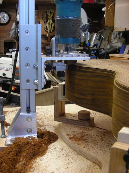

Haven't posted here in a while, but here goes.
Here's the jig I use, similar to the SM one, shop-made from a parts list that Lillian put up here a few years ago.
For the carriage, I made some large knobs, visible under the guitar, using T-nudts, partly for the extra torque I can get on them, and partly to protect the the top if the guit drops down. Much kinder than wingnuts. The vertical adjustments are locked down with smaller store-bought knobs (just visible at the lower right) which I'll probably be replacing with bigger wood ones.
The jig isn't as elegant as the SM one, but it's a whole lot cheaper and still a dream to use compared to the handheld jig I used for 'way too long.
Pat
Pat

Pat, yours turned out nicer than mine. I like it.
