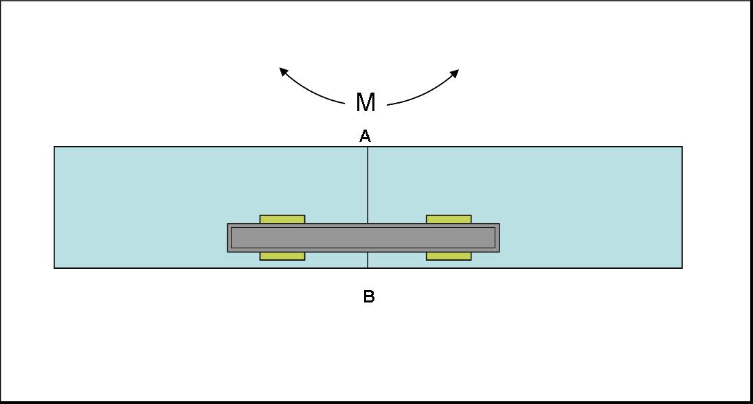

For example, we could consider a simplified analysis of the proposed neck joint as shown below.
Basically, this sketch represents two bits of wood, end joined with an idealised furniture connector and subject to bending. What are the failure criteria and the failure mechanism(s)? Assume in the first instance that the connector rod and its anchors remain sound, then include them in possible failure modes.

Your drawing would present sound engineering Trevor (as it should! :wink: ) with the fixing at the closest (& safest for mechanical integrity) position as is possible to get it near the bottom, in this case the furthest most position from the applied force so you have the whole face acting as a stop if you like & the fixing holding the faces together in close proximity. I'm a hammer & spanner engineer so I leave all the stress analysis stuff up to you guys but would the tensile load rating on the bolt in your drawing be less than if you shifted the bolt halfway up the face?
In Breezy's drawing the bolt (obviously for the physical limitations of fitting into a 45-50mm deep piece of wood) is halfway up the wall & not much wood above it, my money would be on the neck pulling those two small slivers of wood above the bolt shafts out once the strings are tensioned up. As you say though, if you did away with the gap under the extension & the fingerboard sat tightly along the surface of the top it could change the dynamics a bit.

Crushing at point A or stretching of the connector bolt or yield at the anchorages.
But this is made worse because Breezy is trying to fit this into a total body depth of 38mm minus about 6mm top and bottom leaves you about 26mm to make the joint. So you will end up with the bolt centre not much more than 16mm below point A at most

jeffhigh wrote:Crushing at point A or stretching of the connector bolt or yield at the anchorages.
That's what I was trying to convey in my rather non focussed comment Jeff, thanks for conveying it more sucinctly :D
Doesn't leave much between point A & the bolt centreline & once point B starts seperating the joint is all but useless.
Jeff has it exactly right, of course. I would expect the crushing at A to be the primary problem. How much force there is at A depends on the connector pre-load and the bending moment. And how much pre-load you have to put on to prevent separation at B under the bending moment depends on the separation between the connector and A; the more the better as practically everyone has said. So it comes down to how much separation is possible.
If the part called Neck Block in Breezy's initial sketch is left full height, I reckon the maximum separation between A and the connector centreline that you could get is getting close to 30mm (using a full width 10mm bolt bar let into an open slot on the back of the neck and a pair of M6 HT fasteners). There could be more separation if the 6mm cap is additional to the 38mm rather than included (my Strat has a 45mm body thickness, so 38 is on the thin side). To prevent crushing at A, you could inlay some brass bar, both sides of the joint, using the harder material to redistribute the stress concentration and so achieve a higher load before failure at A.
My guess is that you would now be getting close to a joint that would survive string loads and playing (provided you weren't planning on doing any back flips on stage) but it would still be rather fragile and not very robust.
But as others have said, if you don't really need a detachable neck, glue is a good option.
