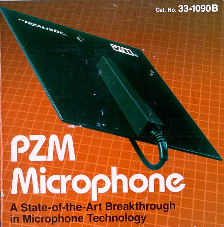

Thought I would chime in as Nick mentioned not been about for a while i may have some ideas but alas just for a straight out acoustic version with no amplification not gone down that route other than a hat box kick drum played like a normal kick drum.
If you want a low bass duff sound than it has to have some hight and size to get that sound also strong enough to stand on
so experimenting with cheap ply would be my how i would go see what kind of sound you get I know from experiments with an amplified set ups timber type doesn't make any difference. Hard to see you getting a sound other than basic tapping or mid range duff unless its a big box, just like a bass string instrument.
the simplest way and I have a friend whom performs on a piece of marine ply 19mm it's be big enough to stand on and move around a bit its on some rails three sides 20/30 mm high open at the back, think a big rectangle lid, and you put under one those old Tandy/Realistic PZM microphones it works a treat and cheap as chips if you already own the mic.
with this set up it is not to high easy to cart around. I read that Jeff Lang has used similar a road case lid and used an expensive crown PZM mic.
Hope this is of help.
