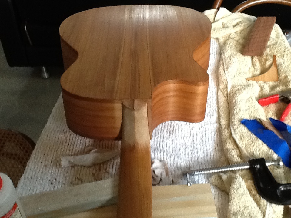

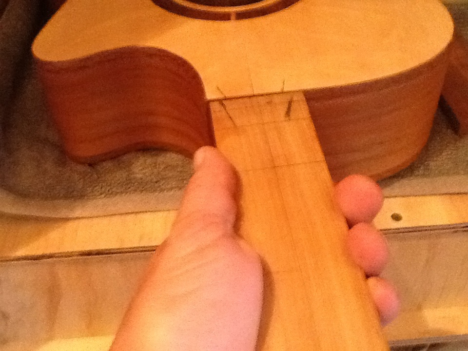

Getting ready to work on the neck joint on my next one, and have found what may be a problem.
You can see by my marks that the jig I used previously, will not leave me much meat in the neck block by the cutaway. So, my question is, is it too late to use a mortise and tenon joint with bolts, a set of which I have, or should I just make a new jig with a smaller dovetail, or is there enough left to provide a stable joint?
I'm hesitant to use the dovetail as is, thinking that the relatively small amount of material left may not be strong enough.
Any thoughts appreciated...

Go for a bolt on. Far better than a dovetail anyway. The process should be the same except for adding the bolts so you can change tack now with no problems.

Whilst I'm a bolt on guy, I don't think the dovetail will be a problem here.
There will be a bit more material further down due to the taper anyhow, and that is where the tension is.

If you want to stick with the dovetail then as long as it's a nice close fitting dovetail I'm with Jeff. That said, nothing wrong with switching over to a bolt on, that's the style I'm going with on my next geetar & while it would have been easier to get the holes in line with the neck block out, it's still easily achieved with a simple drilling jig/template.

Sorry but I am a traditionalist. Give me Dovetails or give me warm beer. That nip at the top is the same as a Martin cutaway and will be plenty strong. The dovetail is the only joint that can stand alone under stress without glue or a fastener.
