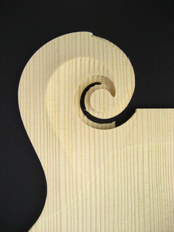

its hard enough to add binding to archtop instrument.. how can I carve a binding channel on the upper horn
I looked everywhere I can find information about it, do you have any tricks that u want to share/pics...

F5/Kentucky Madolin binding???
- TopScroll1.jpg (71.32 KiB) Viewed 6936 times

There a few different ways to do this, depending of the order of building steps, among other things. I assume that Kentucky top in your picture is straight from their CNC machine, the Dudenbostel link shows how he used to do it (I believe ha also has a CNC now), which is probably closer to how Gibson did it back in the day. I learned how to build from Siminoff's book, so I attach the neck to the body before binding, and cut most of the scroll binding channel by hand.
