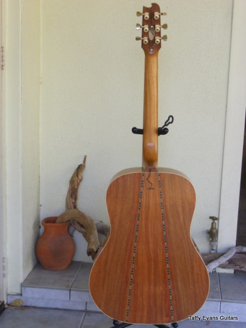

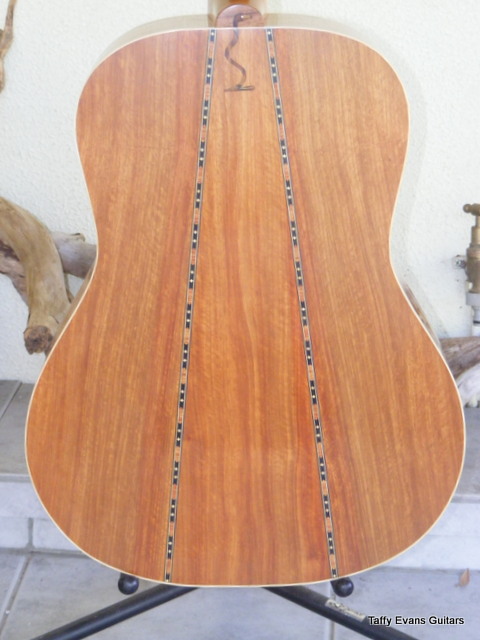

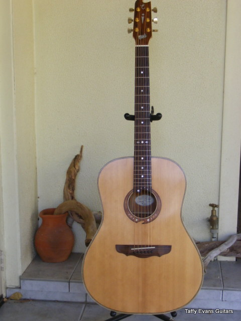

This guitar, a Dreadnought, was started a long time ago and finished at the time of the resent Total Eclipse. So as I name my guitars after old gold mines in the Charters Towers gold fields, this one was to be no different, it’s called “The Eclipse”
The guitar is made of the following:

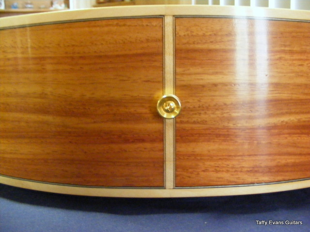

N G Rosewood 3 piece back and sides and neck
Sitka Spruce top and braces
Maple Bindings

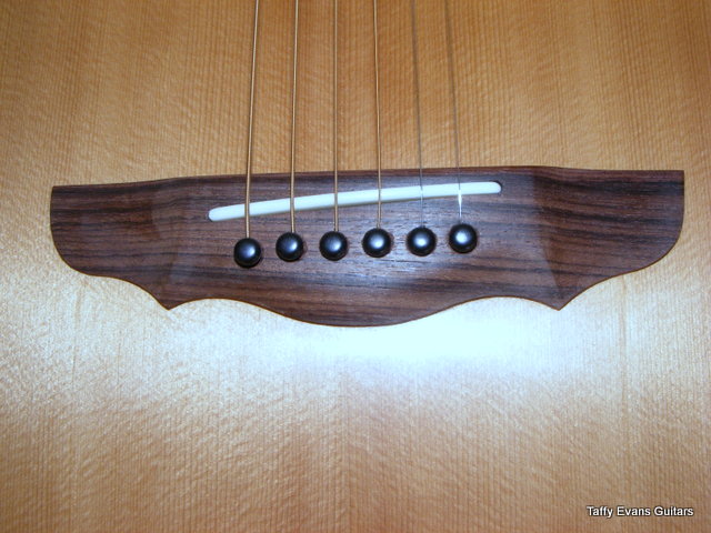

EI Rosewood fingerboard and bridge
Bone nut and saddle
Graphtec bridge pins

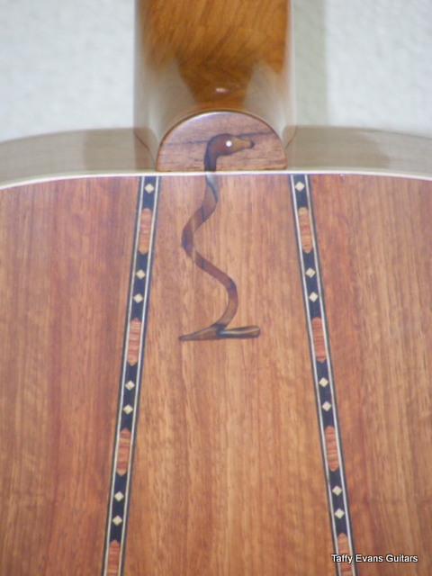

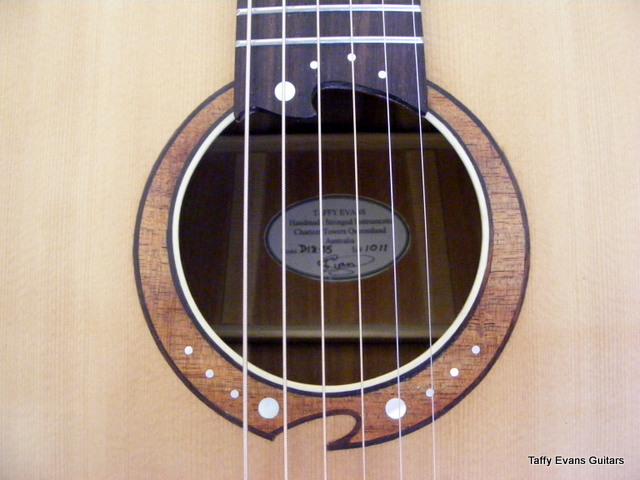

MOP inlays.

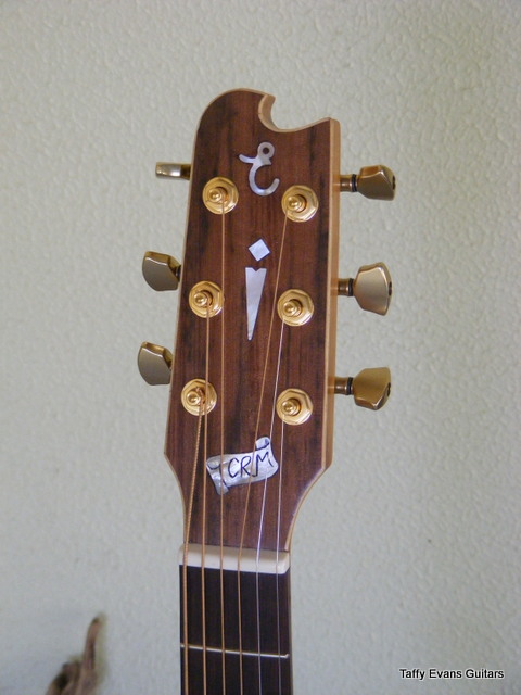

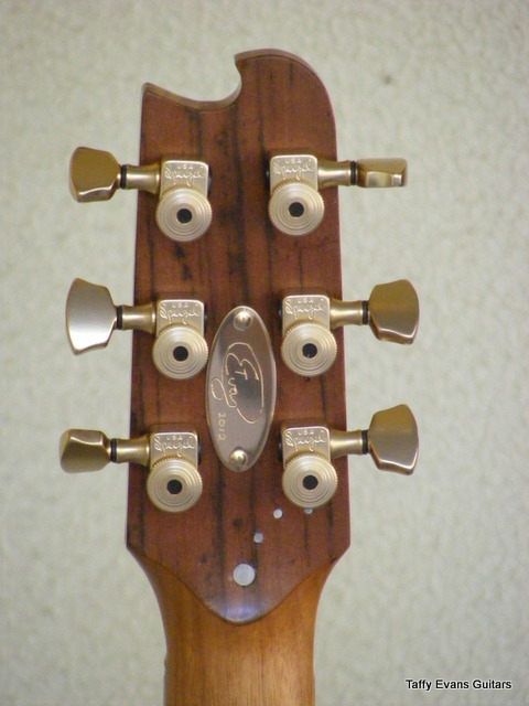

Sperzel locking Tuners [at the customer’s request as was the snake inlay].
Its finished in nitro.
The customer also insisted I have my signature on the guitar, not just on the label, hence the brace plate on the peghead.
The sound at this early stage is very pleasing and the people who have heard it say “WOW”! I take this as a good indicator, and its good feedback for me.
I used the plate/brace tuning technique I have used for the last couple of years, and it has always given me better sounding guitars, especially with cheaper tone woods such as the NGR.
This guitar has high volume for little effort, volume is even across all strings and the bass response is getting better as the guitar loosens up, and is has sweet singing high tones with good sustain which will suit the new owners playing style.
Sorry about the photo quality. Thanks for looking.

Love the details. It must be hard to say goodbye when you've made something so beautiful. I suppose getting paid helps a bit.

Very nice details on this one Taffy. That maple looks fantastic with NGR.

I really like that body shape Taff. Very elegant and the elements blend together seamlessly.

I had the opportunity to play this guitar today. Not only does it look good but it sounds real good. Nice sustain and string balance. I noticed the different shape first up and that the sound hole was smaller than my dready that I have just finished. Taffy has used his own bracing design and the smaller soundhole is part of his tuning process. I think he builds beautiful instruments and it is a treat to see his work. Also I pick his brain on guitar building when ever I can. Finally I really love the story that evolves though his inlay work on each of his instruments.
