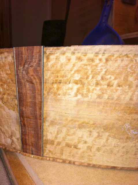

Does anyone know how to make a crack in wandoo disappear ?
Im building a deep bodied OM out of wando and a crack appeared,it isnt bad as it doesnt go through to the inside
I dont think CA and sanding will do it as the wood is so light
will I just have to live with it ? :oops:

Post by DaveW » Sat Dec 08, 2012 3:59 pm
a picture of the offending crack

As for crack repair, HHG is about the best there is for an invisible repair if the crack can be brought together. If it can't then a wedge of wood that matches grain and color slipped in the crack can do a marvelous job but with Wandoo getting that pattern to match might be a problem.

The crack is pretty well closed as unusual I cant see it on the inside
I did run CA along it and clamp when I first found it but it didnt alter it
Wandoo seems to be almost like glass its so brittle ,I couldnt plane it ,I could only sand it to thickness,when I was planing it seems to chip instead of shear ,and yes my planes are sharp.

I have never touched a piece of wandoo, so I can not give any real advice and I am not sure if inserting a splint could be an option to hide the crack or not. Maybe wandoo is too brittle to do such a thing.
CA glue tends to darken most or all wood that is not already dark, while hide glue does not affect the colour at all.

HHG , Its good glue like Allen says, and " if the crack can be brought together " is important.
If the crack had a bit of spring in it ,and would not come up tight, and you did not want to fill with the same timber.
You would require a glue with good gap filling properties , HHG is not good at doing that, it shrinks back a lot.
For good gap filling I use a two pack glue, Techniglue , and add colours to lighten what would be a dark crack. if the colour addition to the glue is not perfect then you have a second chance just before the finishing stage to tweak it with a colour job. I use a box of mainly oxide colours but also spirit colours. Mix up what is needed starting with the lightest colours mixed with shellac, and paint out the glue line then add the secondary colours then the missing bits of the natural swirls of the darker bits of grain, keep the shellac thin and pat each colour application flat before it drys , feather edging the edges . The more figure in the grain of the wood the easier it is to hide problems.

the crack has no spring in it as it seems to be only on the surface ,inside it isnt visible.
so I guess the only way is to try and fill and blend
the wandoo has some streaks of pinks and browns so I might be able to use that to my advantage

That will pull up just fine to almost invisible, you need to seep the glue into the crack and clamp it up properly, that is tight but not too tight, I would then re-inforce that area internally with some cleats that have grain running in the opposite direction.
Coat of sealer and clear
End result should be practically invisible

it doesnt seem to pull up any tighter than what you see but I will take your advice and put some cleats on the inside to prevent it spreading
and maybe after final sanding etc it will look ok?????
not confident but optimistic

if it were a bass or a cello I'd reinforce the inside of the crack (even though you can't see it on the inside ) with a strip of good linen soaked in hide glue.
