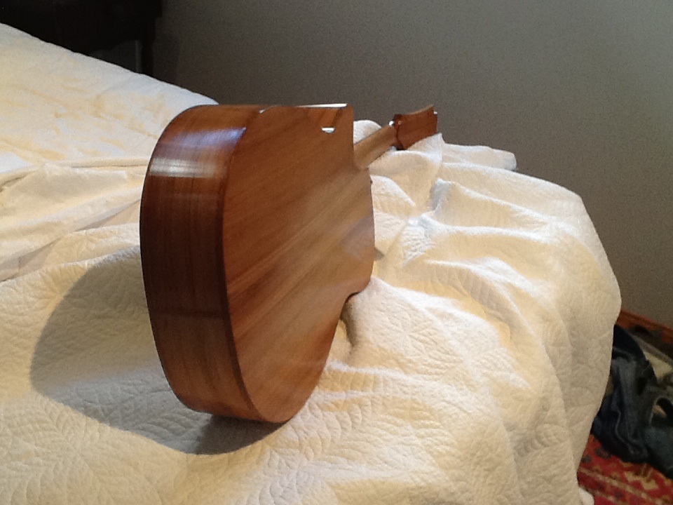

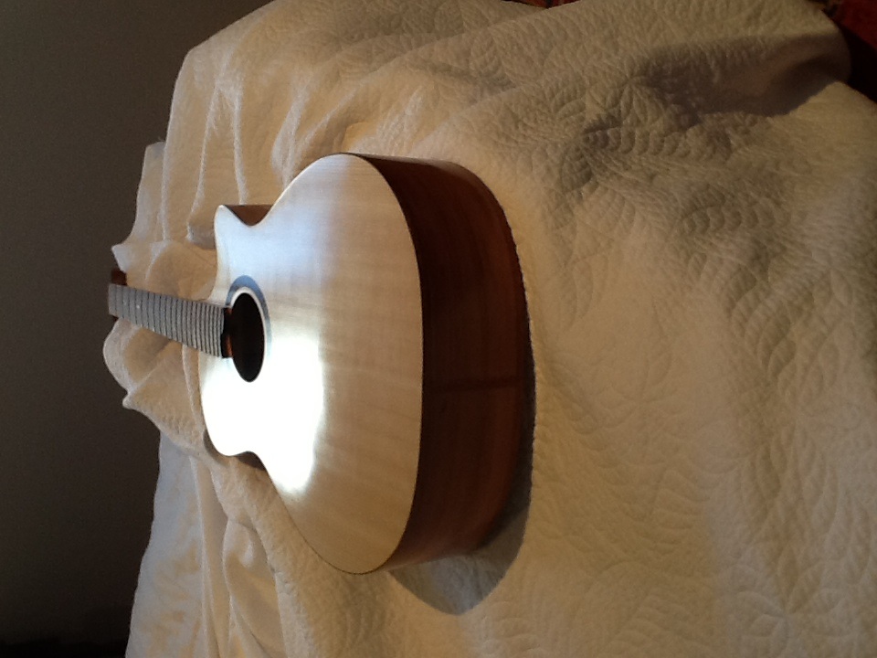

I'm in the middle of Tru Oiling an acoustic at the moment. Top, back, sides, neck, well all of it, and am really enjoying the ease of application as well as the resultant finish..
These are after around 8 coats.
I bought a small bottle and it's about half gone. I'm thinking it's got enough build on it and will add a few more, then burnish the top to a higher gloss, while leaving the back and sides alone.
+1 on searching. Plenty of info. Also search you tube for deadedith and Robbie O'Brien for tru-oil finish. Both are informative...
