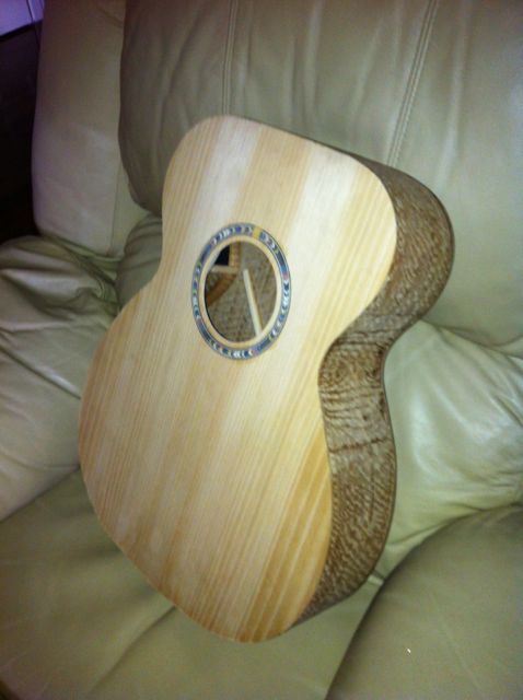

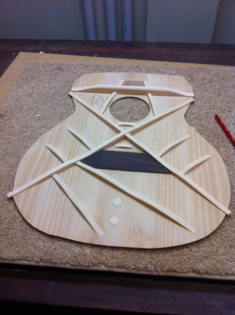

Hi
well Ive been beavering away and I have a few picis
the top bracing is fairly heavy as this was how I thought it needed to be done due to the :floppiness" as discussed before ,it actually had quite a nice tap tone after bracing and I actually got to a point of "limited return" so left alone,this isnt atually the finished bracing as I decided I would try my hand at doing an arm bevel which actually ended up altering one of the X brace legs ,as Ive said before Im using this build as a bit of experimentation ,trying a few things that I havent tried before to build u my skills and memory bank so to speak

Re: Bunya Query
I remember having some sitka spruce years ago that was way too flexible, it would bend/flex like cardboard, but thoughtful brace positioning and carving brought about some nice sounding guitars. The customers thought so anyway.
