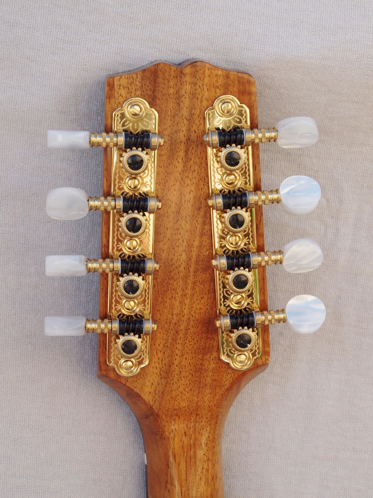

Addressing (3) – is a flattop so the top and back are much less work than an arch top, and there is less wood so the materials are cheaper. Back and sides can even be made from offcuts. Can keep the rosette simple and save hours of work. However there are marketing considerations, so retain the dovetail neck joint and varnish finish as well as retain the wood bindings. A varnish finish does also help with (4). Use a cheaper tailpiece and cheaper tuners. The tuners I chose are Rubner, made in Germany so are quality tuners, but I have found it is well worthwhile getting the Teflon bearings and buying direct from the factory. Case is made in China, but fits well.

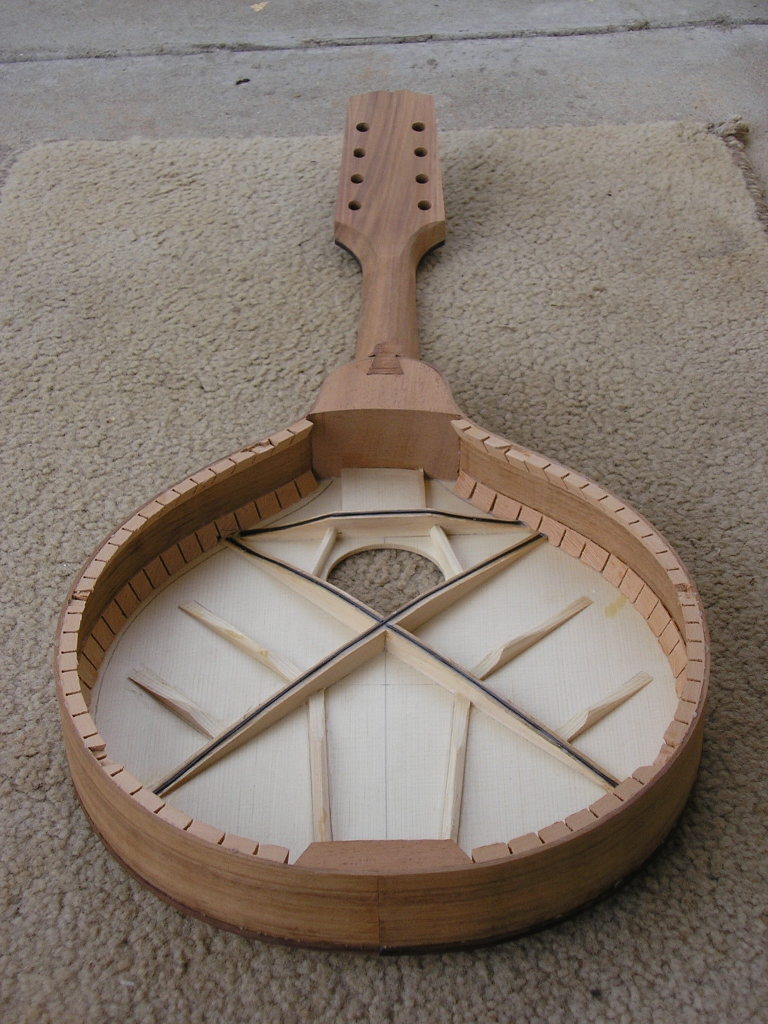

The bracing pattern I have come up with is in the picture below. I call it “enhanced X bracing” because the X and cross piece north of the sound hole is reinforced with carbon fibre. The sound hole is reinforced similar to a guitar, and I have added two longitudinal braces from the tail block to the X to prevent top failure under the tailpiece. After 7 mandolins and one mandola what have I learned? Well, lighter is better for the top (oh what a surprise), and I like the sound of Myrtle or Blackwood. With Engelmann Spruce top and Engelmann braces I can get the weight of the top down to around 94gms. My arch top mandolin tops weight around 150gms so that is a massive difference. No wonder they are louder!
Picture of the bracing on the most recent instrument -

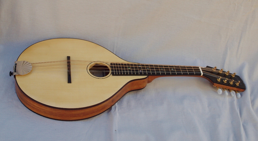

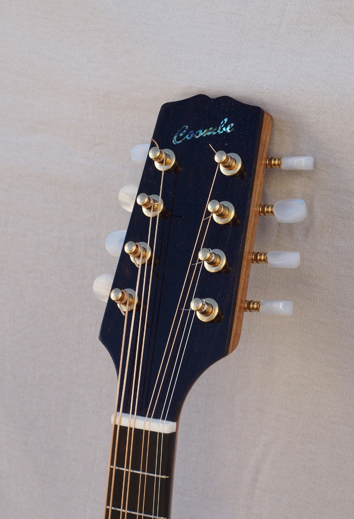

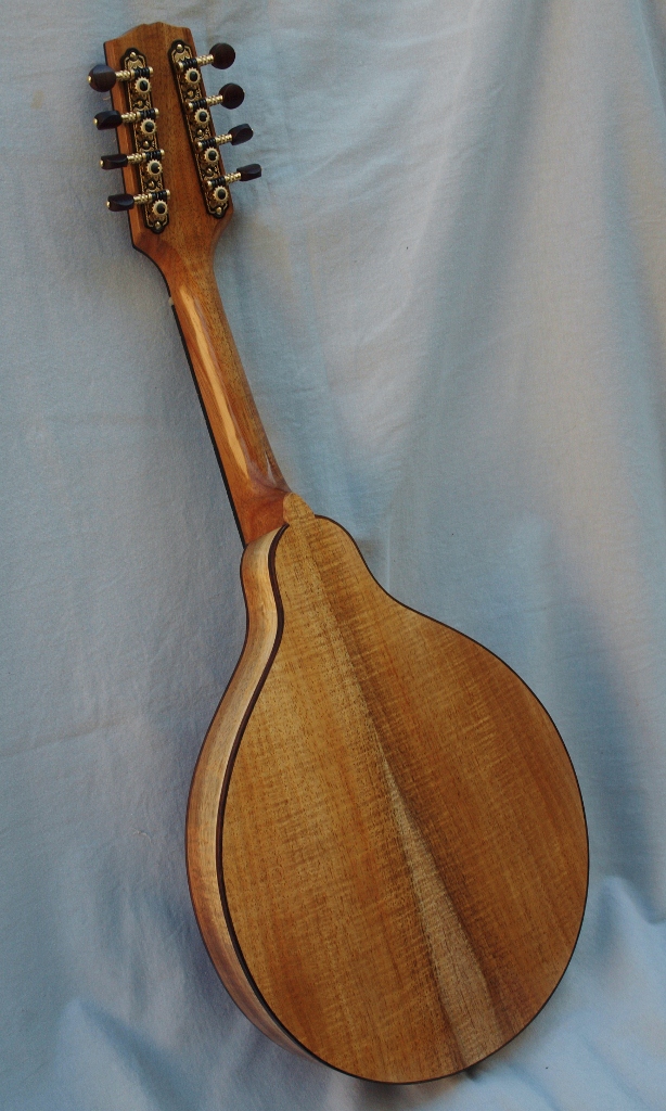

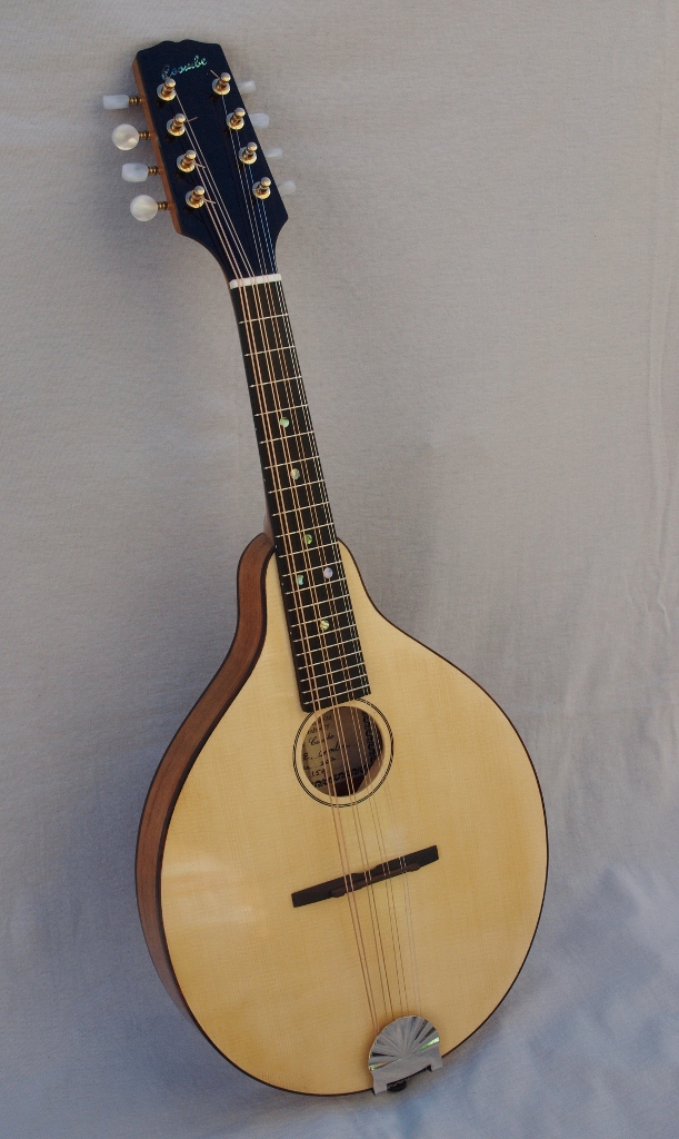

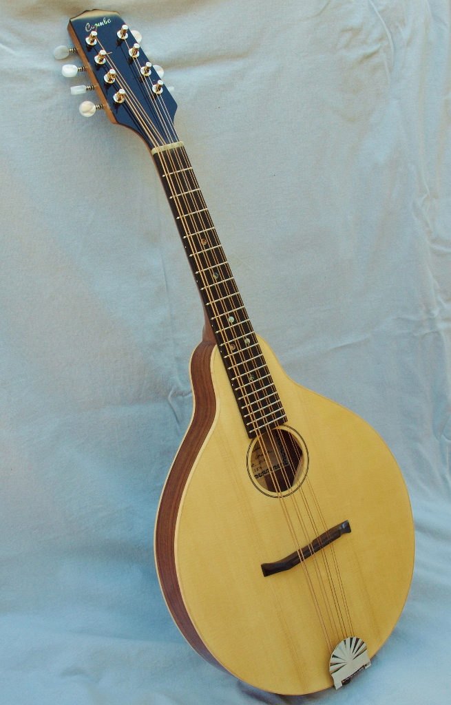

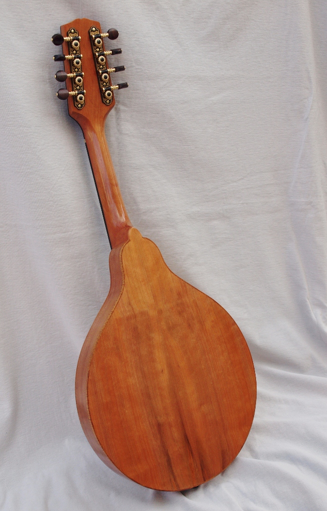

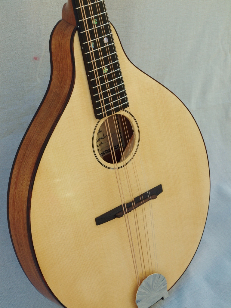

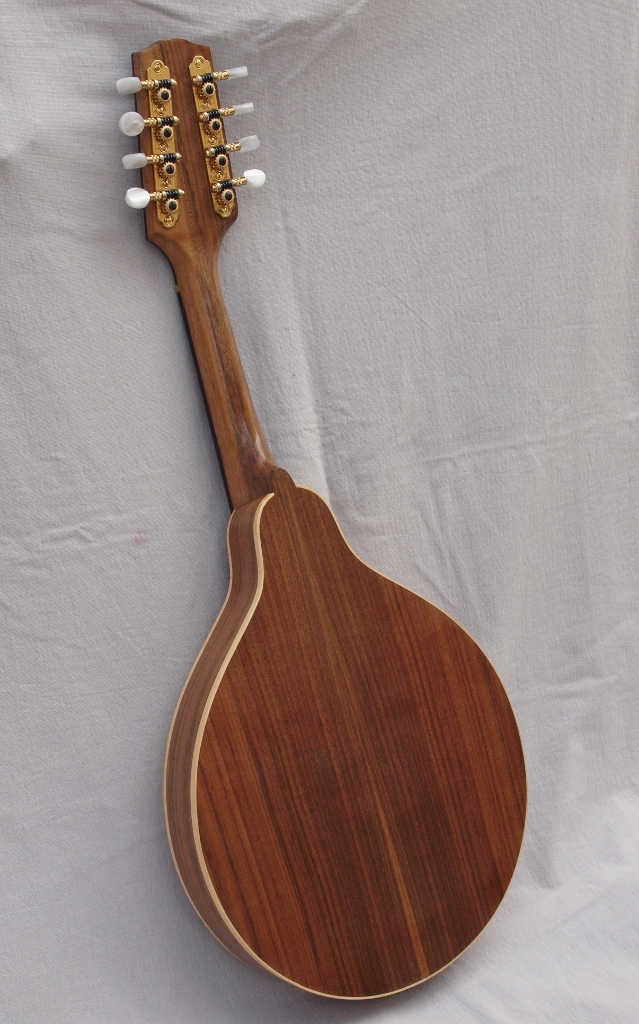

Pictures of the actual instruments -

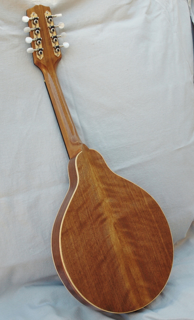

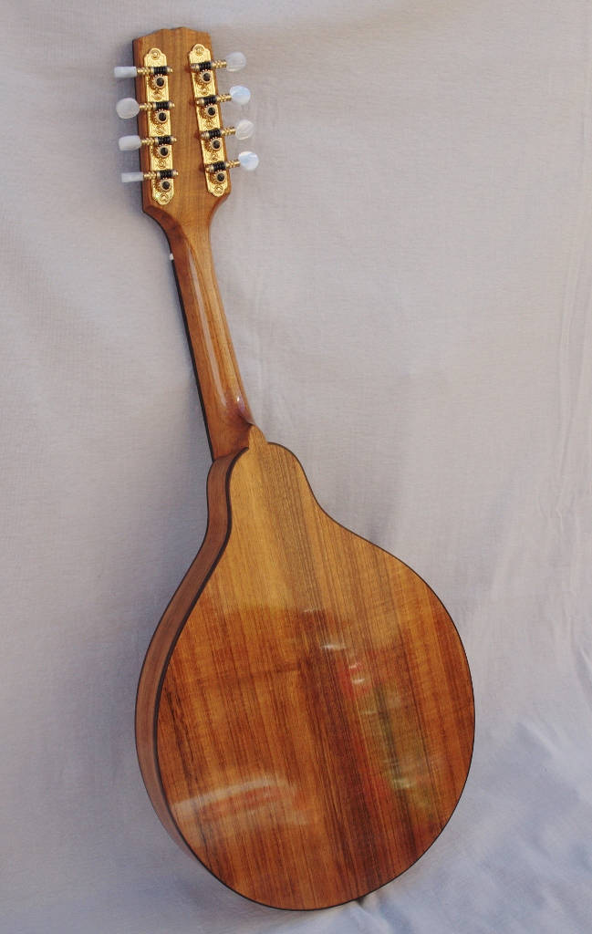

Here are some pictures of the mandola. Soundclips here -
