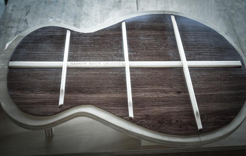

Re: Which paper for logos/details?
Post by Allen » Sat Jan 05, 2013 7:19 pm
I'd always used parchment paper with lacquer sprayed afterwards as a fixative.
But, I left an instrument out on the workbench one afternoon and came back the next day to find that most of the label had been chewed up by what I can only assume was a mouse. :shock: Pissed me off like you wouldn't believe. But it got me thinking. If I've got a mouse that likes paper, and I have 2 cats that apparently are far too well fed. Then other people might have a mouse with the same taste for paper.
So the next day I sliced up a sitka top for back reinforcement strips and took them over to my local trophy shop and had them laser engraved. Now I've killed two birds with one stone. And I think it looks bloody professional to boot. Cost was the top, which gave me 26 strips at 12mm wide. I think the top was only about $20. It's one that I got on a sale at the OLF some years ago. And the laser engraving was $5 per strip. Beauty is that I gave him my font and got just what I wanted.
