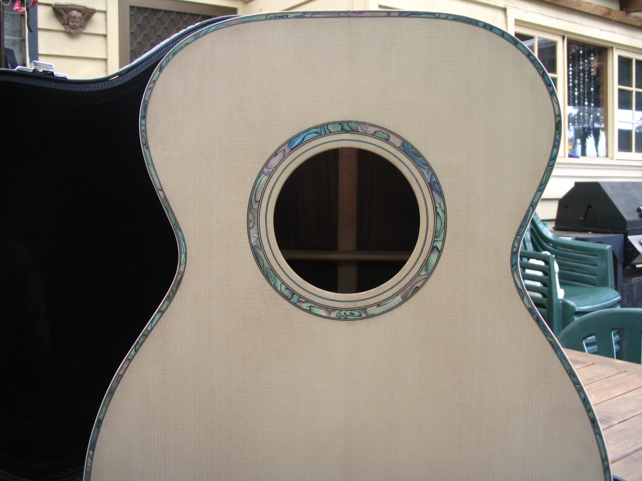

Inlaying abalone pieces is not at all difficult and you can get the radius that you require from Australian MOP supplies.
I did a couple of OM's a few years back in Martin D42 style (rosette and purflings) It did take a while but it was most satisfying to see the end result. This was my first attempt at this type of thing.

Nice job Bob on the OM BTW ... Looks like you went real close to the edge, not a lot of wiggle room there?

It's really not that difficult with a mixture straight and curved pieces. That was the first (and last) I've attempted it.
