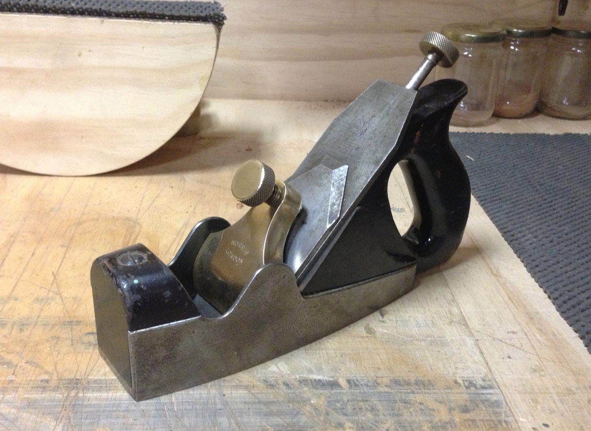

Thanks Wayne. There are some scary videos out there! I have attached a pic of the plane. I took it apart tonight, cleaned out some old wood crud and put it back together, tightening it as I went. Did some fine shaving and it really does work like a dream. The blade has been sharpened but not in a perfectly straight line. I think I will attempt the resharpen. I'll let everyone know how I go.

Never seen this brand of plane before, looks like it has a bit of 'heft' to it Martin, planing without the effort, good find.

I'm a bit biased but in my opinion the Norris and Norris style infill planes are the pinnacle of British design.Nick wrote:Never seen this brand of plane before, looks like it has a bit of 'heft' to it Martin, planing without the effort, good find.

Nice plane . I'm into Spiers infill planes and have one Norris. A few things I know about them is the pre WW2 ones were filled with Rosewood, plenty of the later ones are stained dark and work just the same.
You want to take care of the adjuster on these planes, there is a fine thread that pulls the blade back and pushes it down . The gunmetal lever cap that holds the blade and cap iron down to the bed provides plenty of clamping power and they do the job well but you should loosen it a touch when adjusting blade depth, the fine thread on the adjuster can easily be stripped out . replacement adjusters are being remade for them because so many of them fail .

Thanks Rob. I took mine apart and it seems to be the exact model you sent the link for. Hopefully I'll get a good sharp edge on it.
