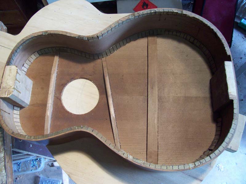

I don't know a thing about that style but I am curious about the bracing. Like an X archtop or something else?

G'day Bill, nothing exciting happening on the inside of the one I am playing(nice lazy build there). This guitar is as light as a feather so I reckon there is plenty of room for improvement.
- tailpbraceladder.jpg (71.21 KiB) Viewed 19497 times

Bracing appears to lean more towards classical bracing..minus the lower bout fan braces.P Bill wrote:I don't know a thing about that style but I am curious about the bracing. Like an X archtop or something else?

G'day Dennis, long time no see. I know that bridge set up you are talking about as Batson Guitars use it and have considered it but doubt I will go there as I like the look of the more old school style bridge and the sound of my old $5.45 parlour. Batson uses all sorts of different bracing systems for his tail piece jobs including composite lattices and I have had a bit of a look at them. Would be happy to see what you are up to though. I guess as a answer to my question from your answer that you maybe thinking that that missing "bite" maybe why this style is rocking horse manure.
Yep Martin that old thing is a bit like that but I guess the description would still be Ladder braced. You might call that main brace, for want of a more Aussie word a "Popsicle" brace.

According to the book Stauffer & Co. - The Viennese Guitar of the 19th Century , E.P. Hofmann, P. Moughin, S. Hackl, 2011, this bracing pattern is typical for the Stauffer guitars from 1815 onwards.P Bill wrote:I don't know a thing about that style but I am curious about the bracing. Like an X archtop or something else?
To my understanding, this bracing pattern (and some variations) was then used for virtually for every viennese (or wannabe-viennese) guitar of the 19th century, or at least all the nowadays still known viennese builders used it, and even the early C.F Martin who at some point worked in the Stauffer shop (no records left he would have apprenticed there though) was no exception.
Although, I have to say that the viennese luthiers normally used a pin bridge (Stauffer and others used it without bridge patch), and the lowest transverse brace was a normal brace, not a flat brace as the one in the picture above.

I also realize I said "ladder" bracing in my post and meant "parallel" bracing (with the two longitudinal braces doing the work.) Even if I'm wrong, that's what I meant to type.
