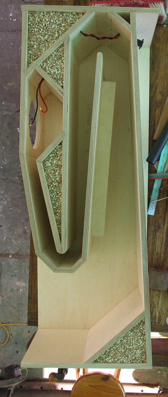

I built two pairs of speaker boxes last year, a rear loaded horn, full range driver design. 47kg each unit, when fully loaded. Here's what they look like inside:
The general rule is don't use solid wood, because, unlike a guitar, you don't want any panels vibrating, not even a little bit. So the material of choice is 19mm Baltic birch ply, which is where a lot of the mass comes from. In this design, you tune the "horn" to the resonance of the driver, and that flattens off the frequency response. It's a very "fast" design, so acoustic instruments sound, well, like acoustic instruments. I had some pretty decent speakers before these, but these are a totally new experience. Only 30 watts a side, but easily rattles all my ceiling panels. Pianos actually sound like real pianos. First time I'd heard a speaker get even close.

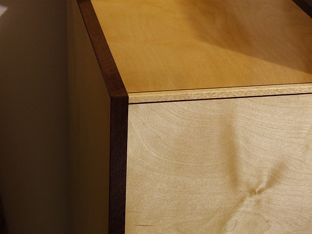

Here's a detail of the finished ones I kept for myself. I lucked out with some really nice swirly grain birch ply, so did a bit of guitar style binding and French polished them. They're 1220 high by 310 across by 450mm deep, if you were wondering...
