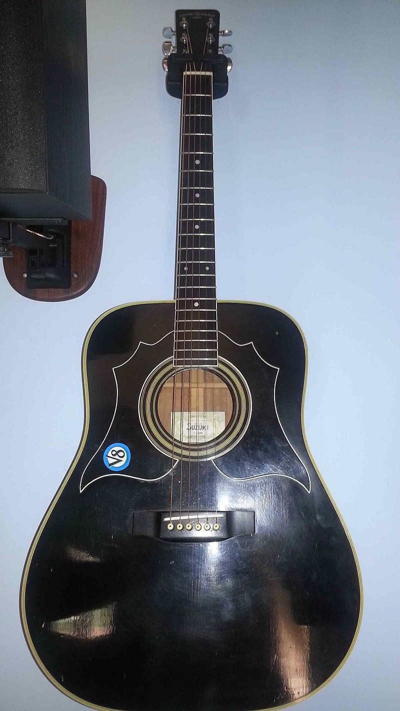

I worked on an 18-35 focused resort island for a time and had a plywood topped beater as a party guitar. Still have it in fact, it's a Suzuki SSS and was used for general jamm'in, as a pillow, and even a weapon if required.
Tonally it had everything stacked up against it with ply top, and 'twin' pickgaurds, and being black with white plastic bindings, it looks like the acoustic guitar Batman would choose if he played. Now that guitar sounded as flat as a biscuit until it was loaded with 13's. Then, just as long as you'd had at least half a skin full and were digg'in the pick in just short of break'in the "G", it would open up and cut though just about anything when out in the open air unplugged...ahh them were the days.
