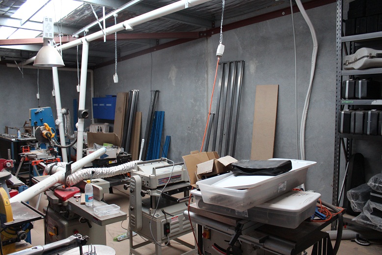

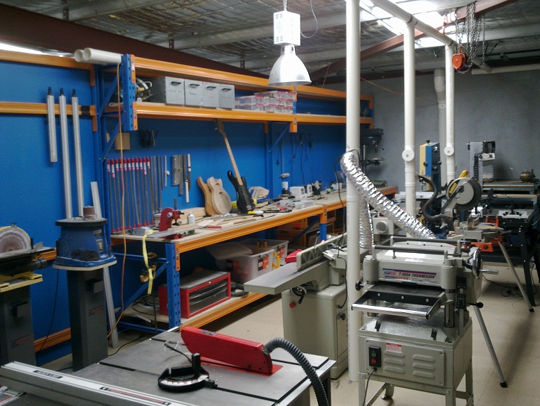

Our woodwork room is just a joke, whilst I have extraction of everything, it just doesnt seem to draw the dust away, the benches are covered everyday in dust to the point you give up trying to use the benches.

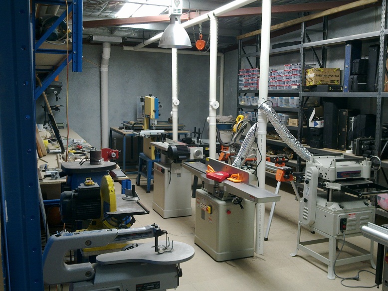

Heres an old clean photo, you can see the issues, storage frames in the room, open benches to the machinery, its just insane.
Nowadays its no where near this clean
Anyone got some ideas on extracting dust from multiple machines

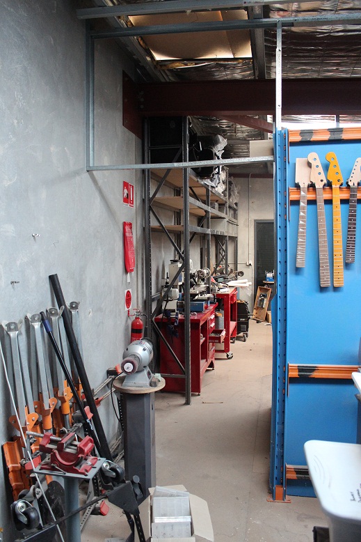

- guitar room 3.jpg (222.46 KiB) Viewed 26141 times
- guitar room 2.jpg (214.56 KiB) Viewed 26141 times
- guitar room 1.jpg (222.31 KiB) Viewed 26141 times

Im thinking, part of the problem, is shelves, I need to loose every shelf as this is just an area for dust to collect,
I also think, I did it wrong by drawing the air up away from the machines, I think, It should probably draw down under the floor boards to the dust extractor.

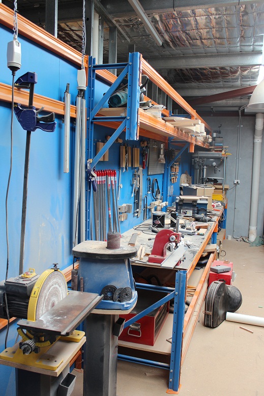

Heres a photo of dust on the benches after they had just been cleaned.
- shop with dust.JPG (220.2 KiB) Viewed 26115 times

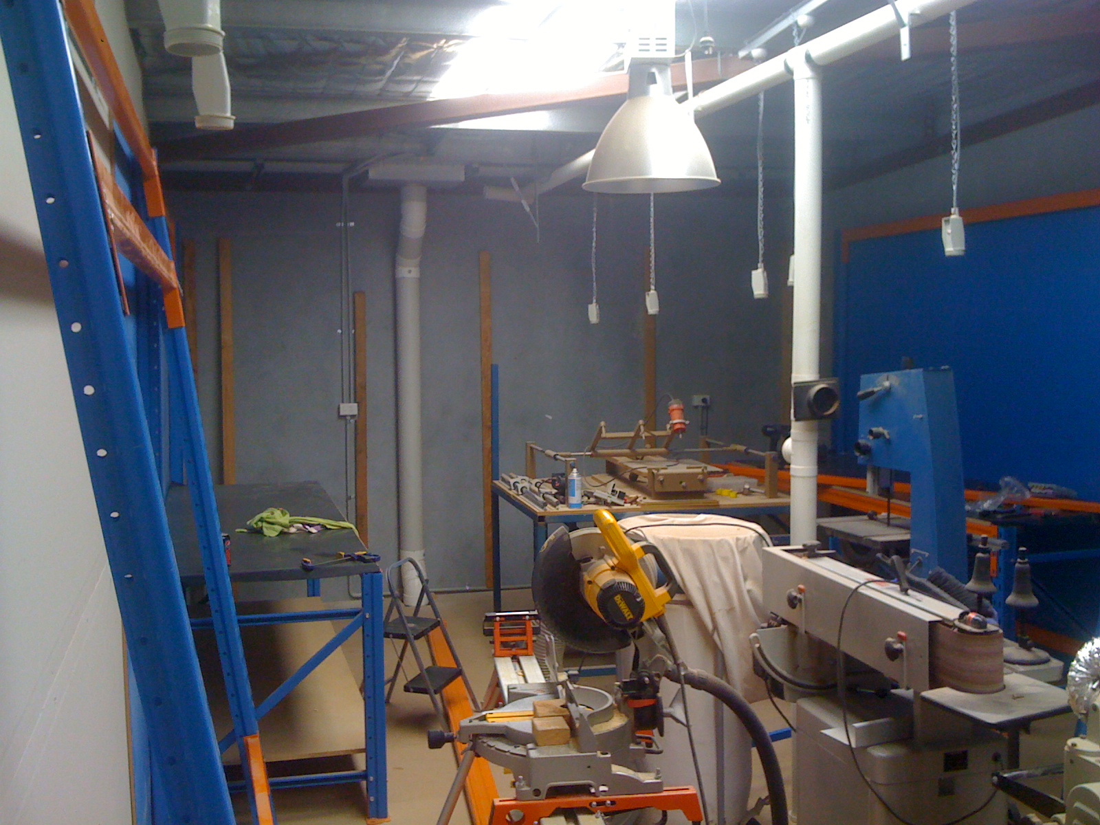

Being the long weekend, means im there by myself,so I want to do something about it, and get it under control.
Ive started ripping out the shelving in the room, and relocating it elsewhere, now it looks like a bombs gone off
- one left.JPG (185.7 KiB) Viewed 26113 times

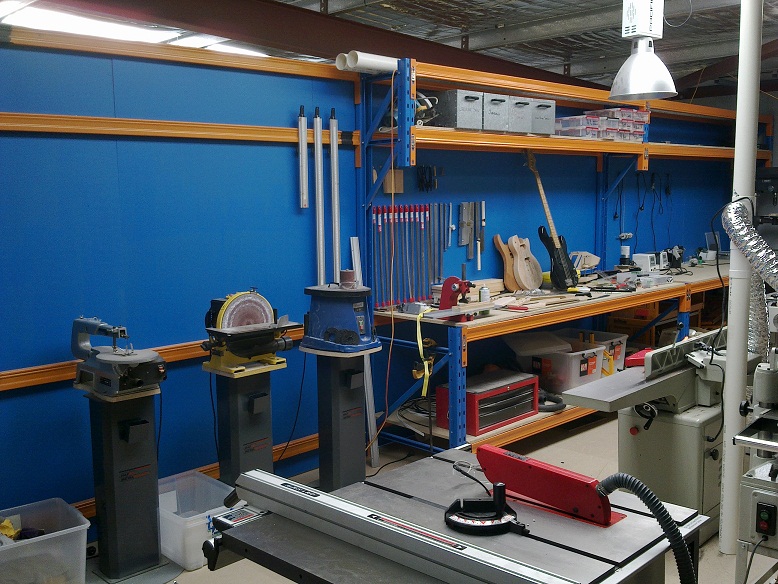

I managed to relocate the shelving at least, so thats a start
Kind of thought I had been, as the air draw at the tools is almost nothing, so it was pretty much pointless having an extraction system in to start with.
Im going to start chasing down some 6 inch pipe tommorrow and go from there.
- relocating shelving.JPG (197.44 KiB) Viewed 26033 times

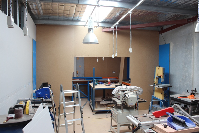

Got rid of the benches today, my goal is to have the machinery ""wood"" room clear of any shelves or benches.
So divided the room into two sections
Re: Dust Control
Benches relocated, building a false wall at the end well, so I can hang tools easily on mdf
Re: Dust Control
Turned that into a room
- Room being built view 6.JPG (167.89 KiB) Viewed 25974 times
Re: Dust Control

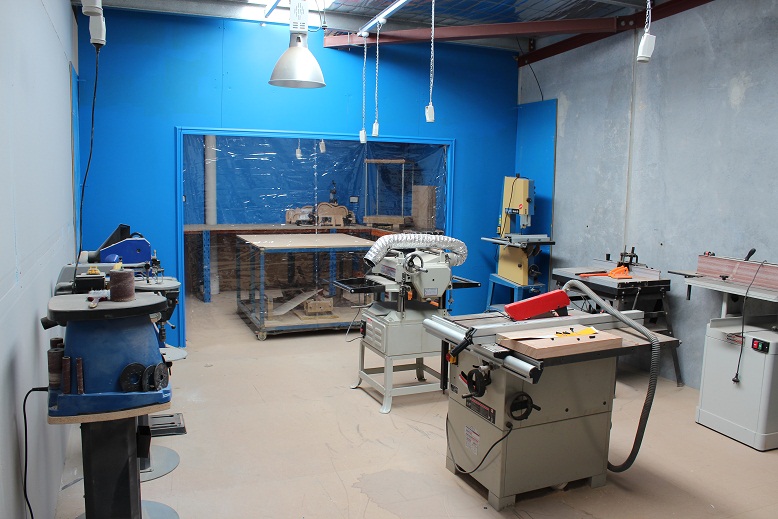

And finished it, now just got to paint it and get some of those refrigeration curtains from somewhere.
Finish the gyprock wall tommorrow so the wood machinery room is sealed from the rest of the shop, and then attack this dust extraction, machinery house was closed today, much to my dismay.
- Room being built view 14.JPG (147.35 KiB) Viewed 25973 times

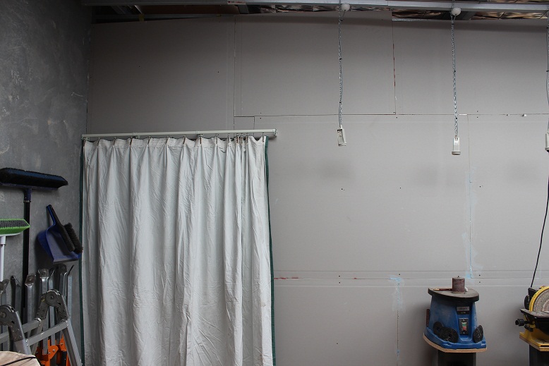

- room complete view 1.JPG (155.16 KiB) Viewed 25888 times
Re: Dust Control

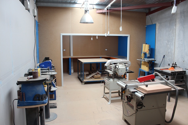

Plus a gyprock wall to seperate the room from the rest of the shop. Needs a pelmet above the curtain to reduce escaping dust.
Now how does one flush.
- Complete view 2 gyprock wall.JPG (116.08 KiB) Viewed 25885 times
